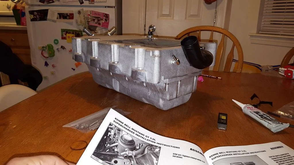

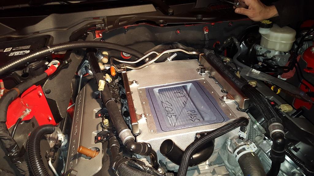

Ok, the first pic is the discharge manifold. It was the last thing I got to do last night. I mounted the bypass tube and installed the rubber gaskets for each port. Simple, easy. Then I went to bed dreaming of Kenne :D

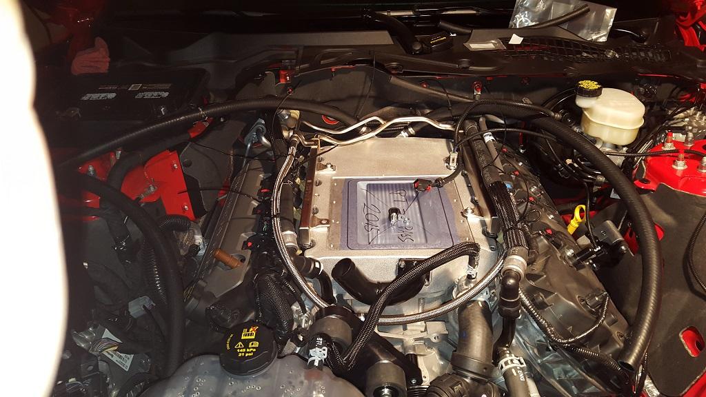

The second pic We mounted the manifold and fuel rails w/ injectors. I didn't snap a pic of the process with the injector install into the rail, but its fairly straight forward. You dont have the injectors clocked at a weird angle anymore like you did from the factory. Theyre now 90Âş off the rail. We attached one of the two heat exchanger lines in the back as well. You can see the other barbed fitting(silver) on the back drivers side.

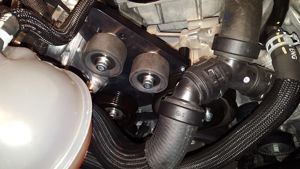

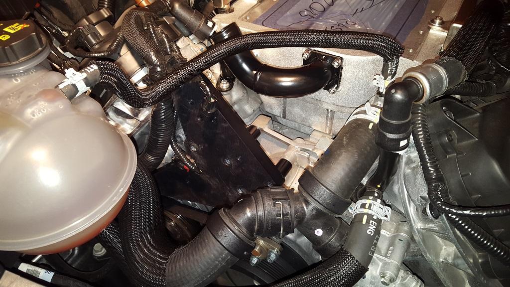

Pic three, is the bracket that houses the idler pullies. You have to remove a couple water pump bolts and 3 timing chain cover bolts and theyre replaced with some hex heads.
Pic FOUR, yes I know Travis I fucked up. The left idler is supposed to be in the upper left most portion of that bracket. We ended up realizing this later and moved it.

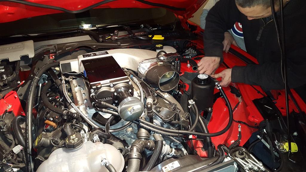

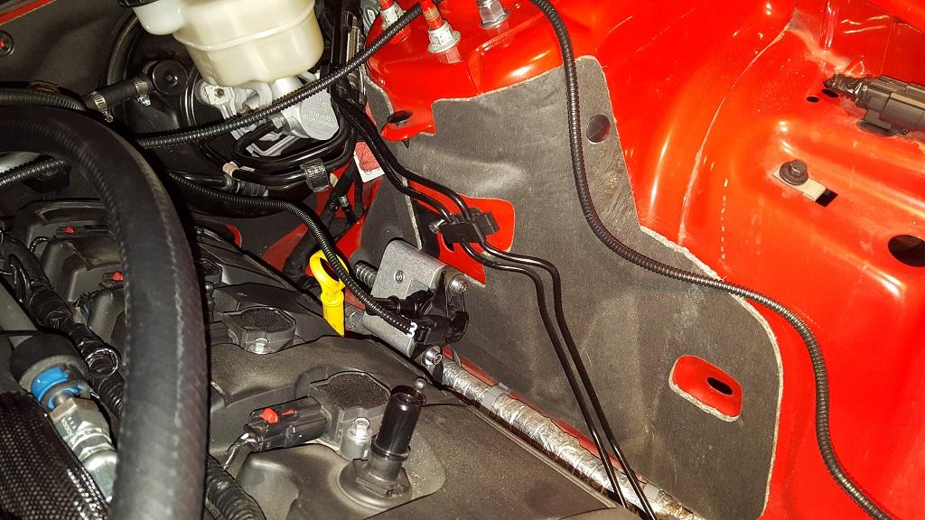

Pic Five is splicing into the MAF harness. You have to cut off one of the wires and cap it off from the factory connector and run another wire to it from a supplied harness.
Pic 6 has the SS Fuel line connected and zip tied in place, we also have the idler moved(to the upper left) and we started fucking with the PCV lines. Moving right along!

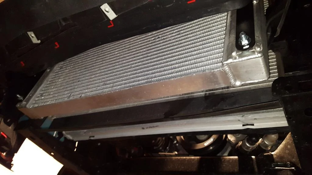

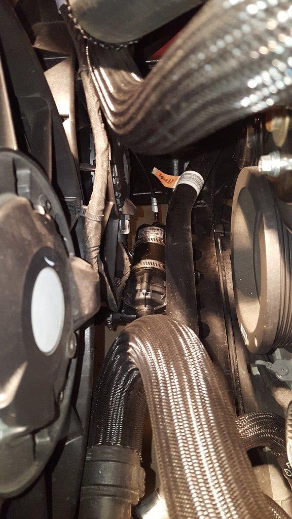

Obviously here is the freshly mounted heat exchanger. The fittings were on the passenger side. One up high with a 90Âş elbow coming down, the other straight out from the side parallel with the ground. The top fitting had the passenger side line coming from the back of the discharge manifold connect to it with some 90's
The lower connects to your intercooler pump. Its mounted with these two tomahawk looking brackets that use the front bumper mounting hardware.

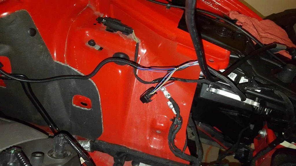

The next pic is of the heat exchangers pump. It has a small harness coming off to the passenger side with a factory style clip. There is another harness that you need to tap into the bottom of the fuse box in the engine compartment. What a pain in the ass that was! I think tapping into a simple fuse would've been a better option. But I guess it looks cleaner. You strip a section of I think was the fuel pump power and tie in the heat exchanger pump power. The harness that goes from the fuse box now to the pump is extremely long... I dont know what you're compensating for there Travis/Kenne Bell.

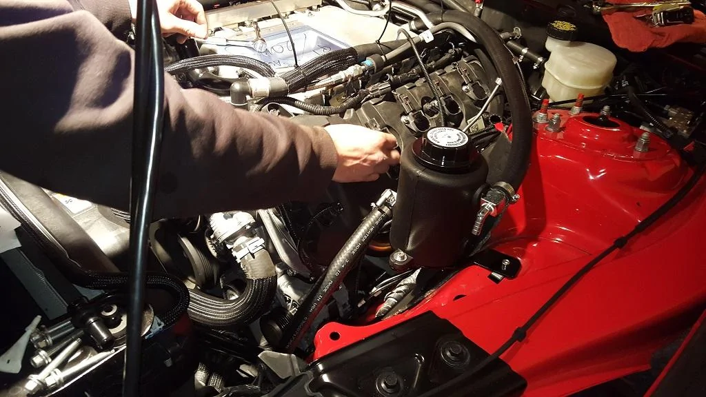

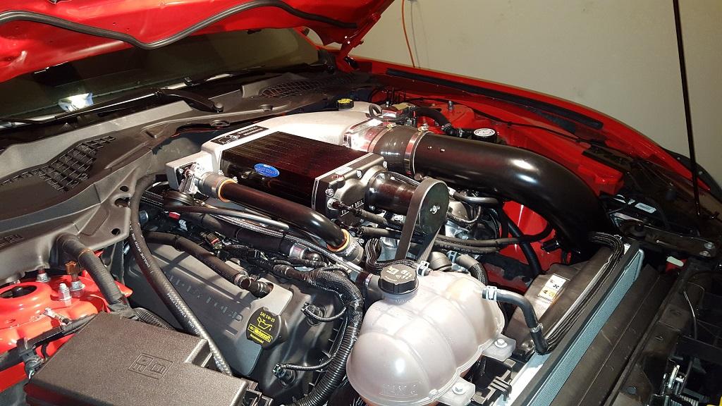

The next pic we started changing the spark plugs to some NGK 6510's a step colder. I do recommend doing the damn plugs before you start zip tying all the hoses and connectors. Also we removed the factory PCS valve fitting coming off the drivers valve cover. Replaced with a metal version. Also, I mounted the resevoir for the cooling system on the blower.

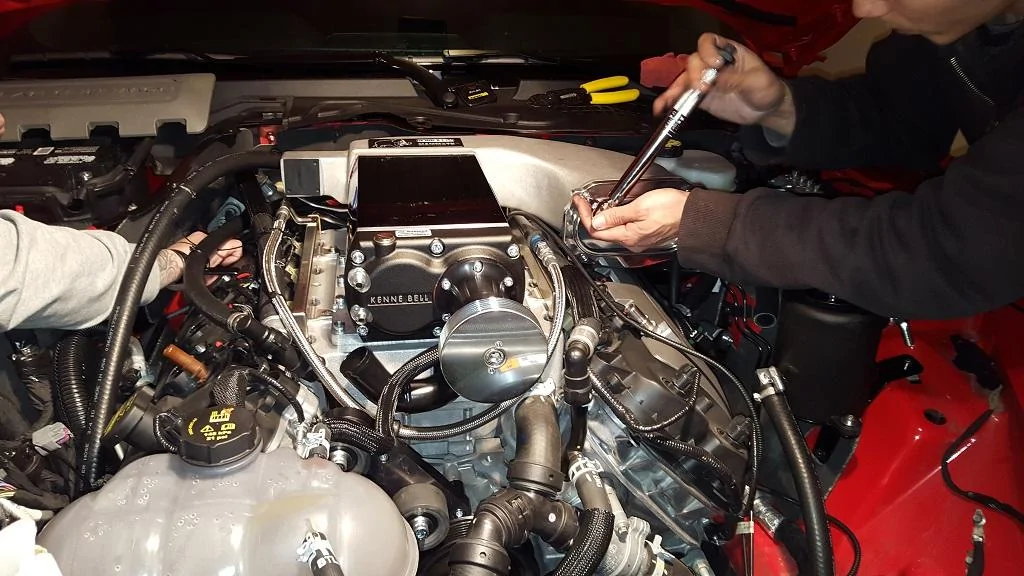

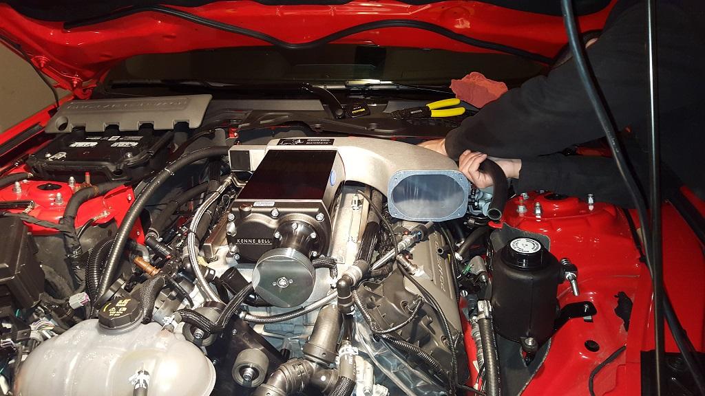

Wallah! We're getting somewhere. The blower is finally mounted. After a few tries to get it to seat properly we finally found a weird configuration of fuel lines, pcv lines, and the liquid cooler lines that sprout from the back of the discharge manifold. As noted in the instructions make sure you find out whats binding, dont force it down.

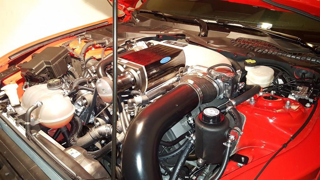

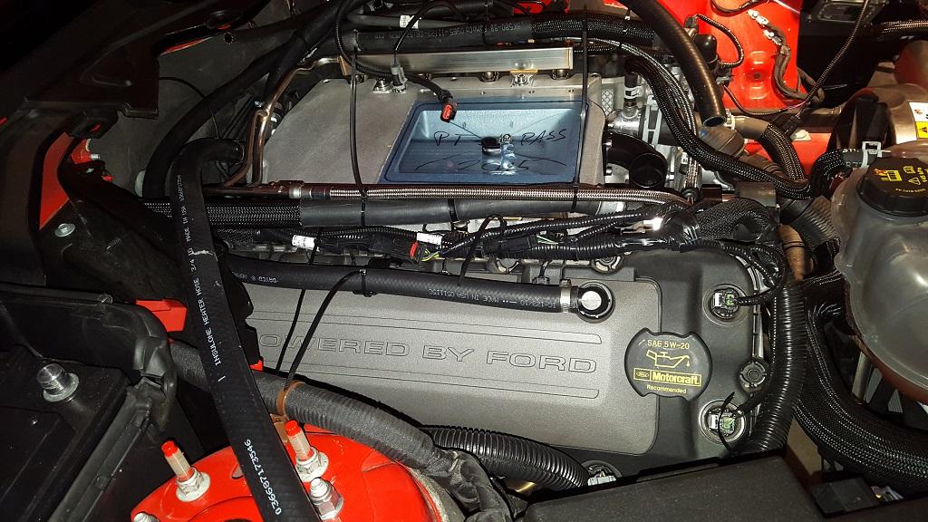

The next pic we're now mounting the throttle body. A small spacer and a couple gaskets. Pretty simple and straight forward. You DO need to take apart the stock TB to get the motor and swap the innards to the new 168mm TB. Also you have to bend down a small tab on the drivers side strut tower to get a little extra clearance.
The next pic, the TB is mounted and we're trying to work the lines for the Liquid cooling's resevoir. We had a couple small hiccups due to thinking we had too much hose. Ended up cutting some portion of it off and shot ourselves in the foot. But we ended up doing a fix involving an extra 90 elbow and a small section of hose.
Last but not least we mounted the bypsass valve, tube and the damn belt. That thing was a pain in the ass trying to get the thing mounted. We ended up maxing out the stock tensioner and had to try and pull that damn belt over the blower pulley. We ended up getting a few ribs of the belt on the pulley and turning the crank over by hand and it walked itself on.
I couldn't of done all this without the help of Alex(sandeale, a member on this forum, and a friend from work). Between lending tools and countless hours getting everything squared away and deciphering the typo'd instructions from here and there. We got it done. Again, i still need to install the BAP and im waiting on Travis to find out if it's necessary to cut the lower plastic cover below the air filter. Im just concerned about rain/wet roads and possibly soaking the filter.
The last thing I did was change the oil and swap to my start-up tune. As soon as I get the BAP installed, let the datalog begin!
