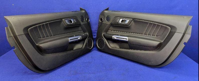

Anybody know how the trim section comes off the door panel? Looking at the back of the panel, that section looks like it's riveted on. Am I seeing that wrong? Trying to figure how how to get that section covered in leather.

have any pics of what the rear of door panel looks like. the cars I have done in the past were held in with plastic rivets. you would drill the head of the rivet off to remove panel then when you reinstall the panel you would use plasti-weld epoxy to form a new head on the stem of the plastic rivet. not sure if this is the ame on ford but I may be able to figure out with a picture.

I read elsewhere that they are plastic welded, so I solved the problem another way. These arrive on Thursday.

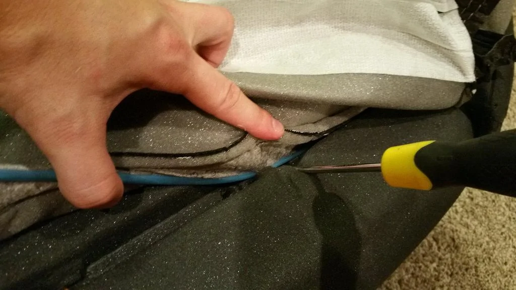

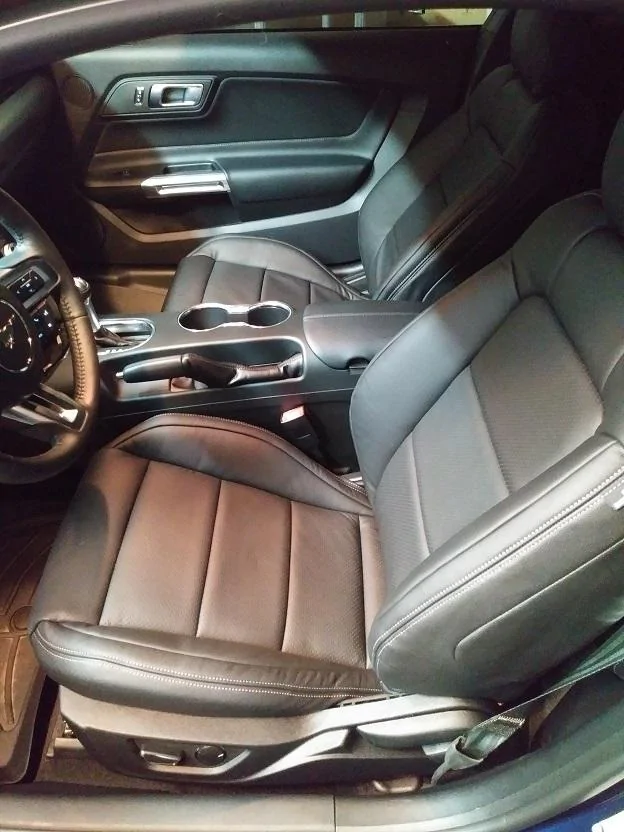

Spent friday night and saturday morning getting the new skins in. No hog rings. Fingers are sore, hands are scabby, but I'm happy. Saved a bunch of $$ doing it myself.
That looks great.
Doing this work on the carpet in the living room, kneeling, sitting, standing and the work-out of the hands, made me sore for a couple of days, but well worth the $$$'s saved doing it myself.
On one backrest I use hog rings, and the other I used zip ties - I'll be pulling the one seat and redoing it with the zip ties.

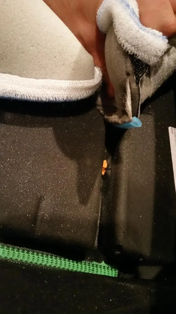

Did your seats have hig rings? Mine just have velcro in the crevices.

Yeah, I've got those clips....one of which pulled out of the foam. :explode:
I had one crack and no longer grip the hard plastic strip, and just added a small zip tie for that location.
Did you do the hog rings near the top of the backrests?

There were't any hog rings in my seats. Just clips and velcro.
