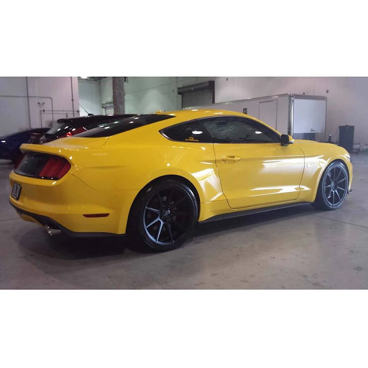

Did you need castor camber plates and a bumpsteer kit for that set up? How much do the minimum drop springs lower the car from stock? Any picture by any chance?
We strongly recommend the camber plates when lowering - our Steeda Minimum Drop Lowering Springs. On a Mustang Coupe, they would typically lower the car about ½”. On a convertible with a supercharger, about ¾” to 7/8” of an inch, which would be a great look on the car and not too low
More details can be found here https://www.mustang6g.com/forums/threads/steedas-new-minimum-drop-s550-lowering-springs.90203/
