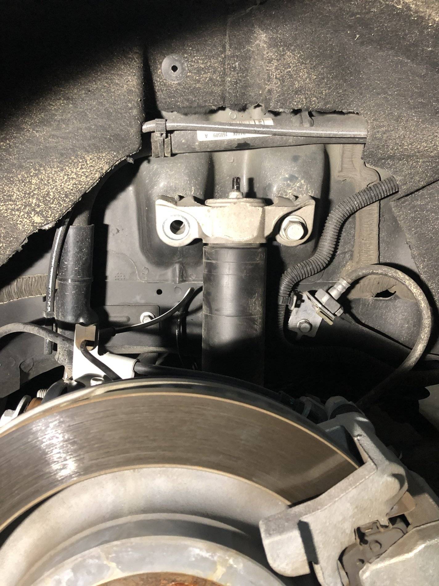

I was installing the eibach pro kit springs over the weekend and long story short, I ended up missing one of my upper shock mount bolts. Does any one know where I can get a replacement? Or does anyone here have one laying around and can sell to me?
see photo below for the bolt that I’m referring to

Any Ford dealership ought to carry them.
Worst case, take the one you have out and match up a bolt at Lowes or HD. Grade 8 or whatever the equivalent metric grade might be, and get one matching flat washer. That'll get the car drivable until you can get the real bolt.

It's an M10x1.5, just match the length. OE bolt is probably grade 5 equivalent so get one stamped 8.8 or higher, or if the stocker is stamped match that.
And then get one from Ford.

Thanks! i found an OE part through CarID should arrive Wednesday!

If it's grade 5 then 8.8 is metric, if it's a grade 8 then 10.9 is the metric equivalent
