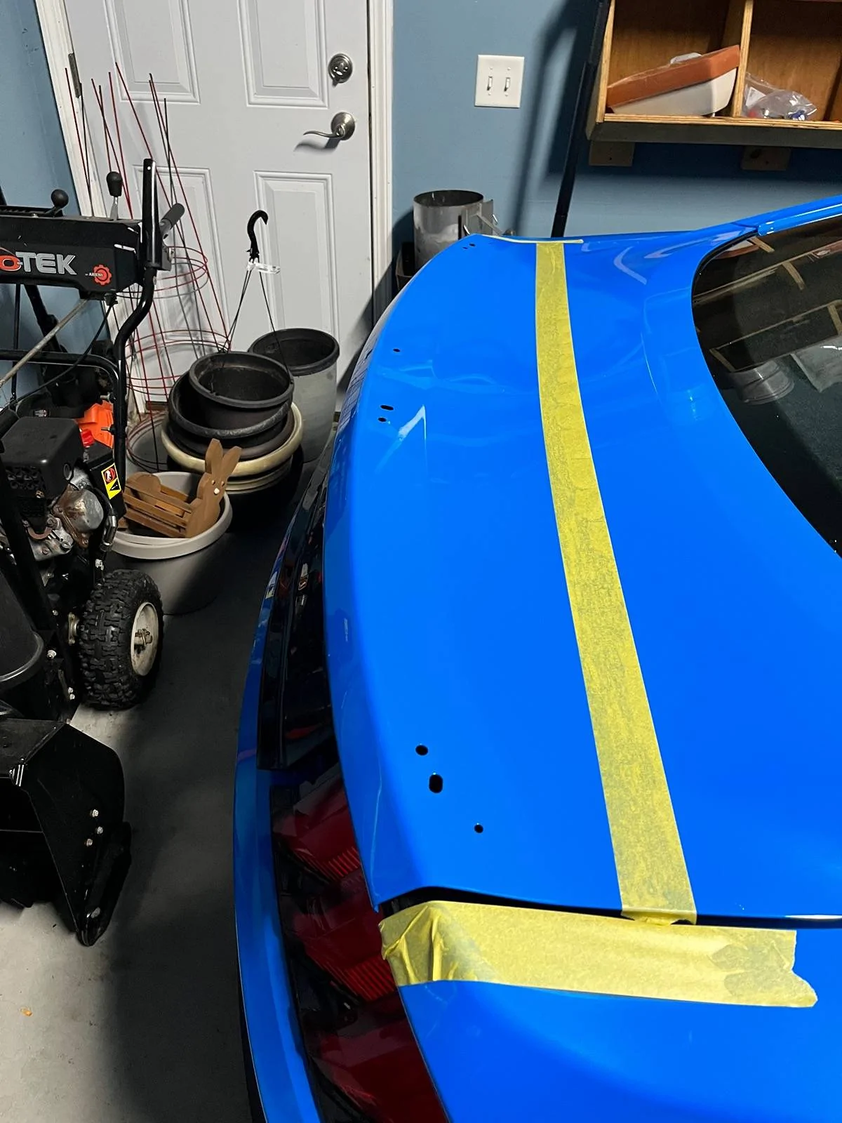

spoiler from MNstang, great deal, great packing. Cleaned all the old tape off, do i need the pre-shaped tape adhesive or will strips of VHB work? And, what the hell are the little red clip/pop things for?

Those red tabs sit in one of the holes in the trunk if you’re removing a factory spoiler for the new spoiler.
As for the tape, I would get a wide roll of 3M and cut to fit and follow what Ford did. Will help keep the spoiler down at higher speeds but also helps with water intrusion

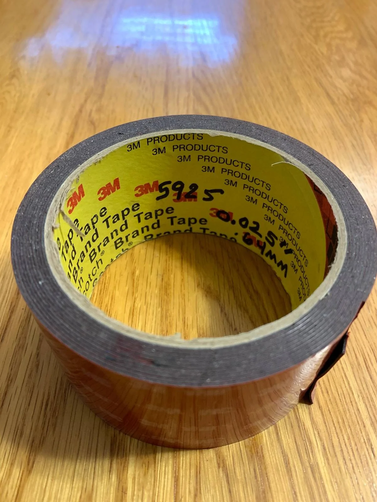

This some tough stuff (#5925). Not sure if it is as thick as you want (this is 0.025" or .64mm). The roll is 2 inches wide. I purchased from Amazon.
Of course, clean, clean, clean both surfaces....and make sure you don't have ceramic coat where you are making contact.
