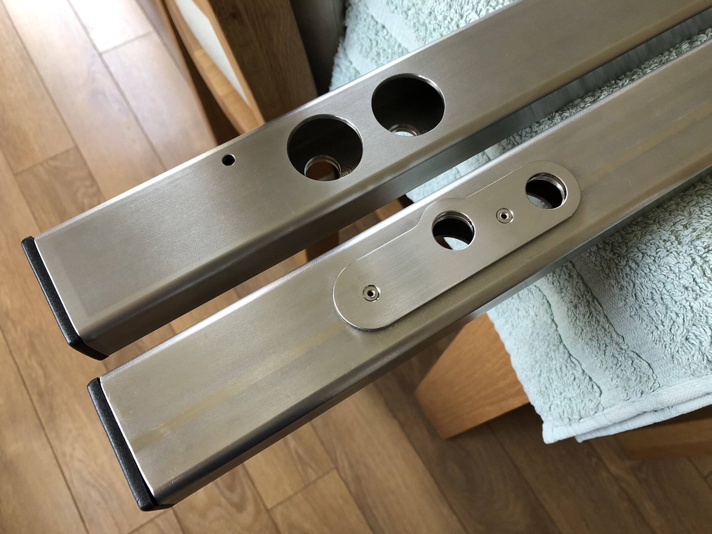

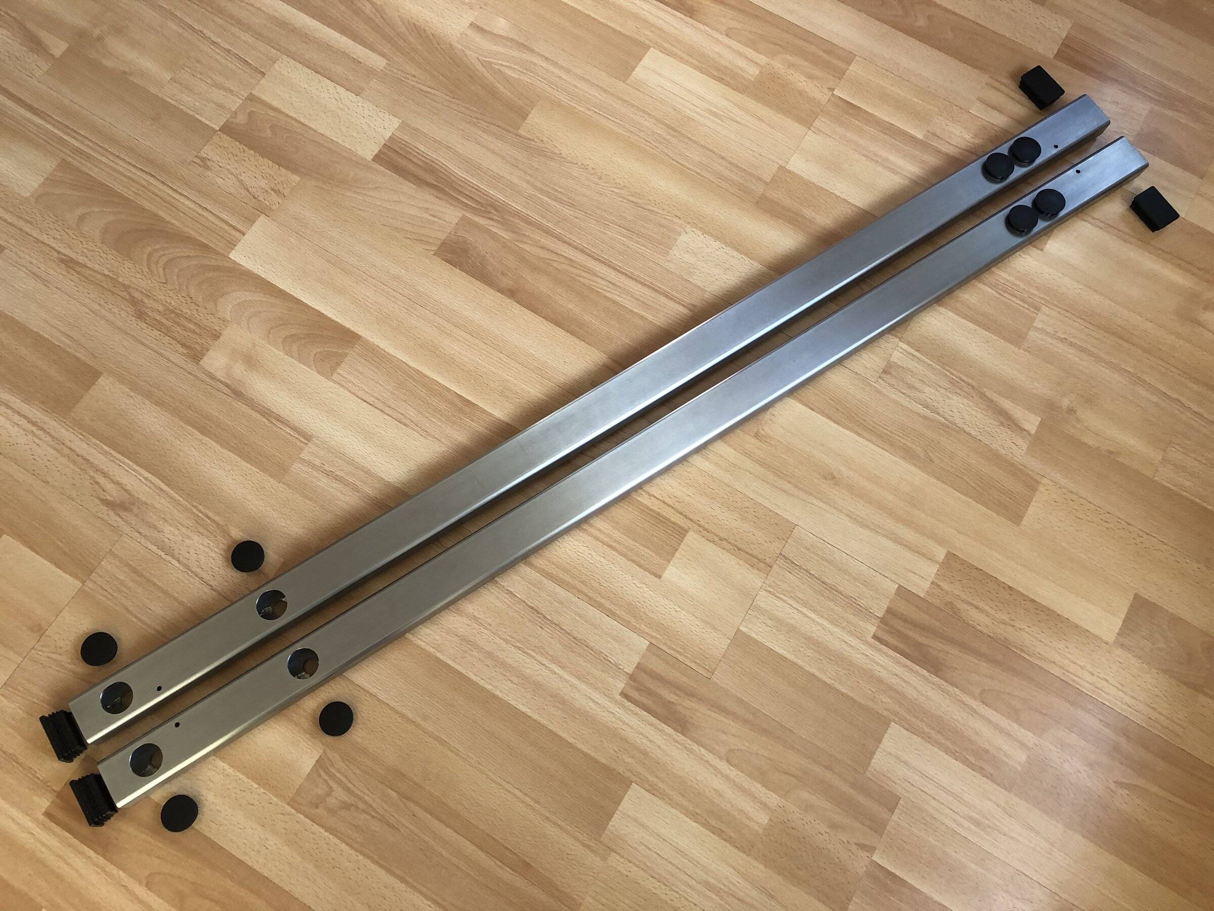

There’s nothing different with the Mach 1 floor pan :like:
You can see the difference in the front hole positions from left to right rails here (note : these are not Steeda rails) :
There is also an offset in the front holes :
Where the rails above are the same length, (unless something has changed) Steeda make the end of the rail constant to the first hole i.e. their rails are a different length i.e. if yours were the same length they sent you either two lefts or two rights.
