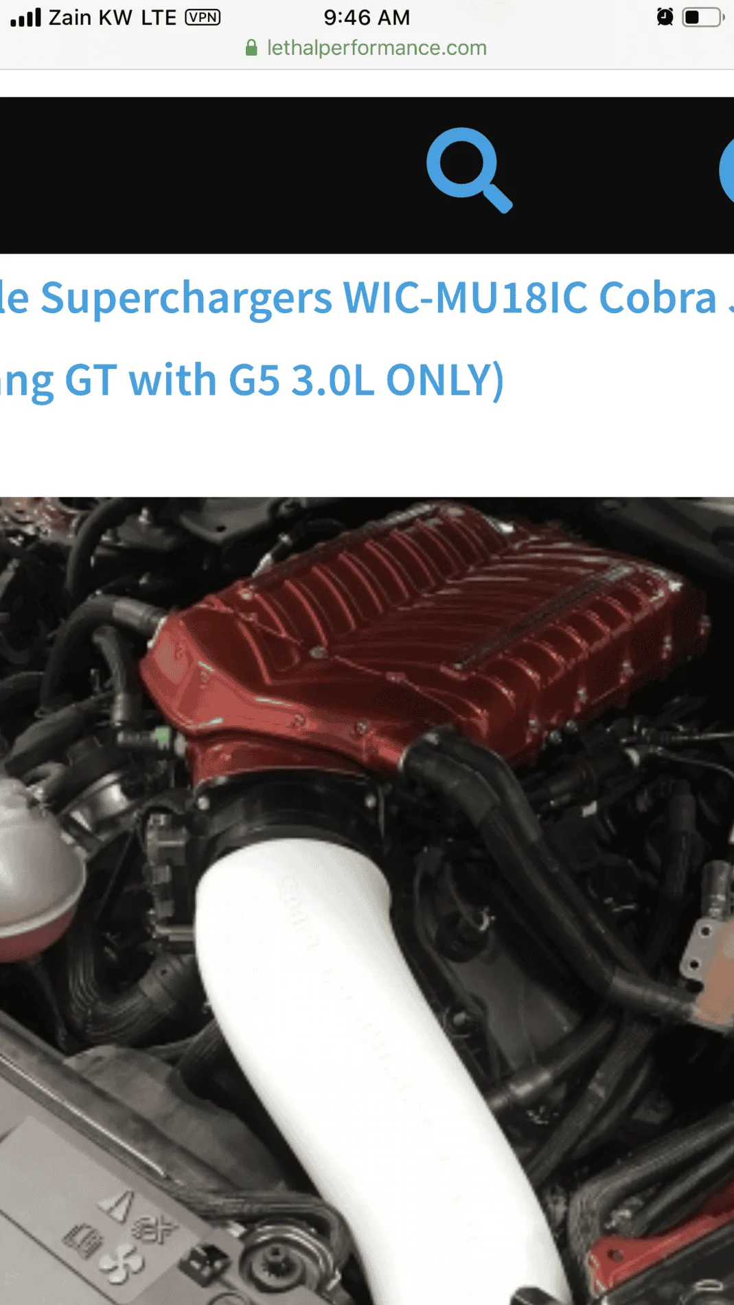

All 170 lbs of whipple boxes arrived finally. First look through seems to show everything is present. Just need to find the time to make the trip for the installation.
Looks great in red! That is an amazing blower my friend! Enjoy!

I’m not sure. There are two intercooler coolant hoses on the left and right sides. Mine has two on the right (driver side) one in the left.
That is interesting, i didnt even realize the difference. Hopefully the instructions are updated lol

So it seems i have the new duel core intercooler, explains the extra input on the front

Does it require any different connections, that were not sent to you? From images in instructions it seems to have a y connection on the passenger side?
May be the cobra jet lid/intercooler is now standard ?
if so , it’s a $1250 “upgrade” currently from the old design .
It sucks for us with “older” design but definitely a nice upgrade for “free “ if you are buying now.
