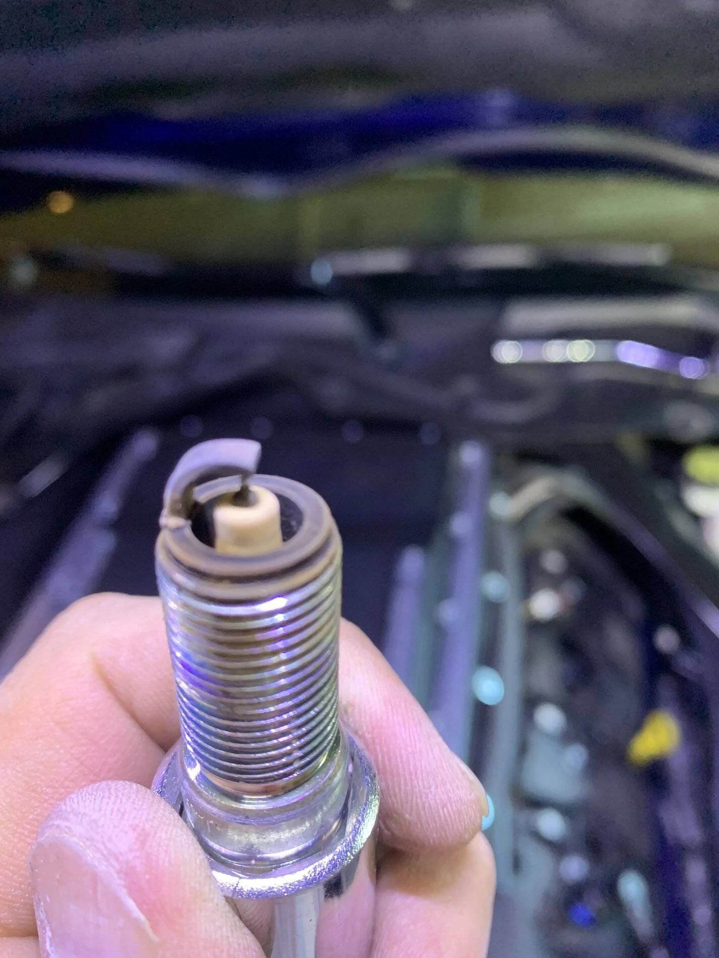

Pulled plugs and they’re fine. MAF sensor is clean as a whistle. Inside TB clean. By-pass valve visually ok but not tested. No codes no check engine light. Everything looks in order...
I disconnected the battery for half hour as well. Likely did nothing but who knows.
Will check BAP wiring before test though.
Next up is a log later today. Nothing visually.
