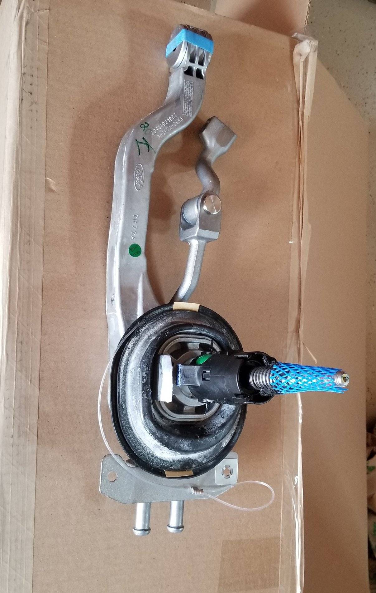

The picture in my post is the replacement shifter used in this FSA. The reverse lockout mechanism is plastic. I don't think we will ever find out what is different with this shifter. If you are uncomfortable with the plastic reverse lockout you need to go aftermarket.

What did they do to the reverse lockout to fix the old issue? That is what I would like to know. Did they use better material for the reverse lockout piece? I ask this, because I don't want to waste my time bringing it into the Ford dealer to have them work on this portion if all they are going to do is replace it with another plastic part.
We will never find out. I had both the old and new shifter side by side and there were no differences in looking at them.
Hmm, I wonder why they sent me the ford notice today... I will call ford and ask for the part so I can inspect it myself. If it is the same ole plastic, I am not going to bother with it. I will just replace the whole thing with MGW or Barton shifter. I am leaning barton as it preserves the reverse lockout function like the stock.
I just told you they are physical the same I had them side by side.
