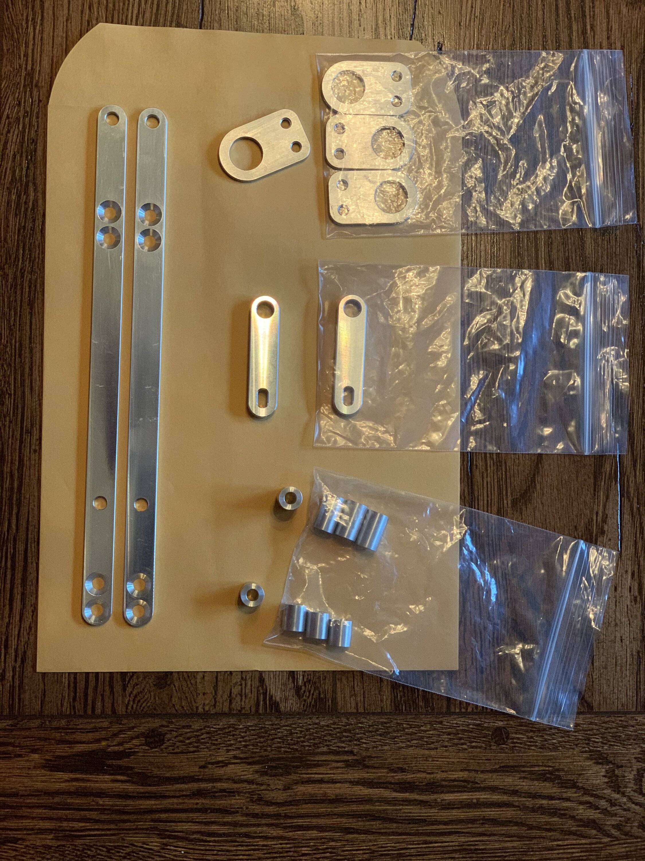

Just upgraded my 2016 with a 3rd generation intake manifold. I know the cover won't fit the new IM and honestly wasn't too concerned, but now I think I'd rather try and keep it. Anybody know where I can get some brackets to make this work?

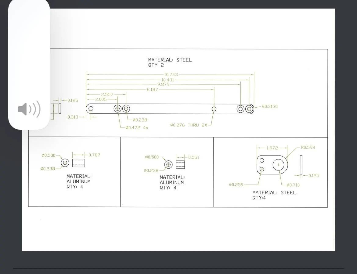

I am also looking for these brackets, I know there’s a drawing that we can take and fabricate them ourselves but I can’t find that drawing either lol
