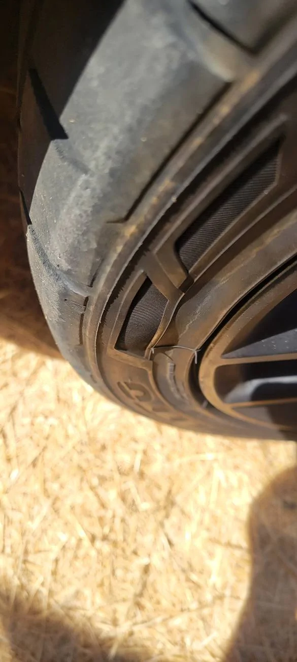

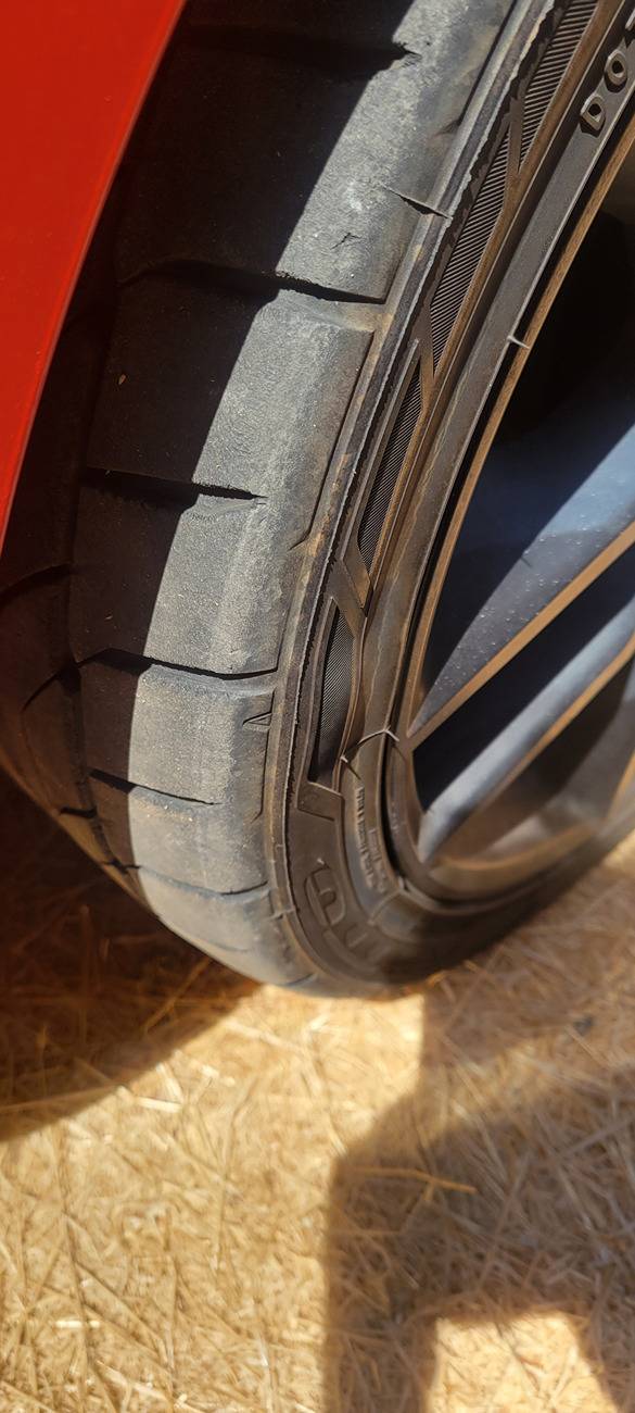

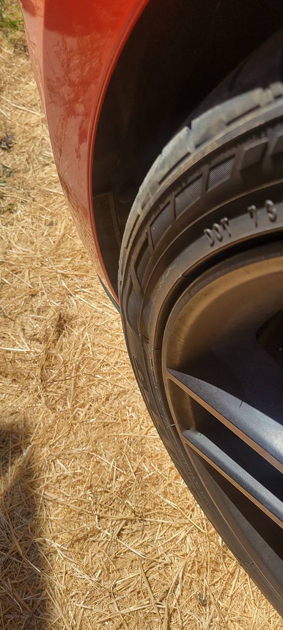

I was checking air in my tires and noticed this part of my tire that might be bulging out. I've seen the dredded bubble before on tires, but its always been a huge bubble and easily noticeable

Yep, that tire be fooked....

Yep, it's an air pocket in the sidewall, usually from either an impact or a compression from a pothole or similar and its at the weakest part of the tire. Time to replace.

Yes, that's the classic sidewall separation between the cords and the casing that's usually caused by hitting a curbing or something though I think a defect in manufacturing could result in that.

If/when you replace the tire if you can get the tire tech to sow you the inside of the tire, there is probably a tear/cut either in that spot or in the nearby bead area. The air pocket forms from inside so you get the bubble you see as a result. A true separation occurs 180 degrees from the damage, and is very common when someone uses a plug type repair on a tire.
