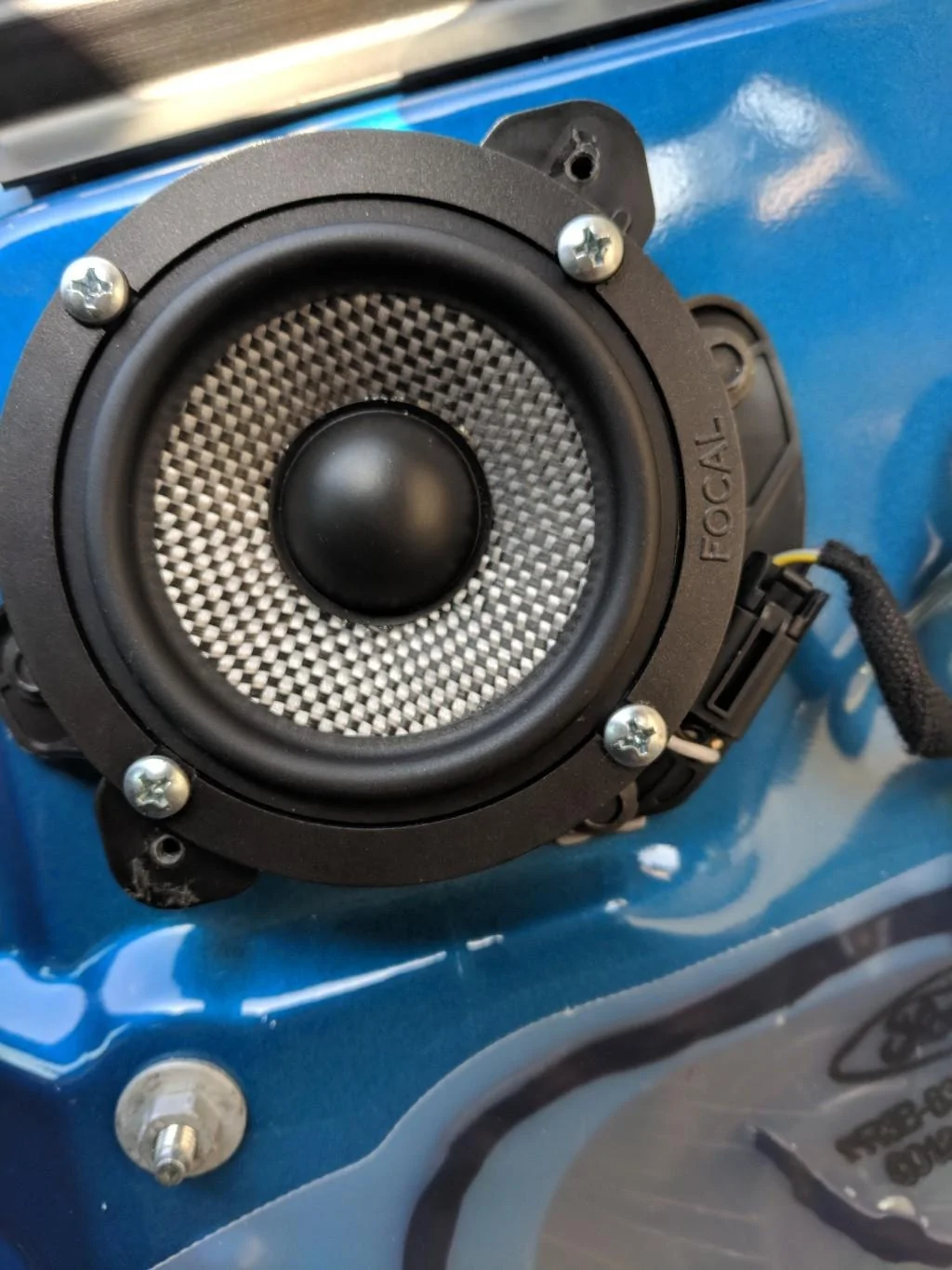

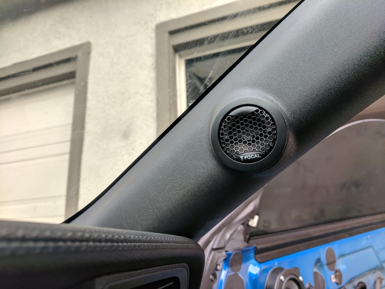

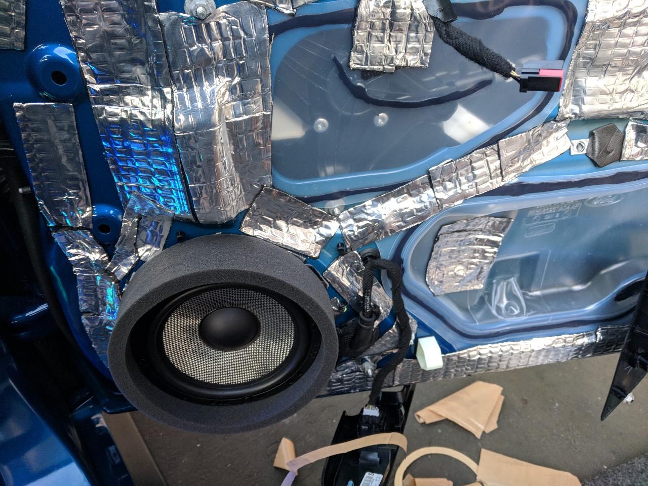

Ok installed the passenger side and everything went smoothly. I used the existing OEM brackets and harness and came out fantastic. Super clean install. Also used fast rings and sound deatning.
As far as sound quality with stock amp, I would say it is little cleaner than factory but not louder due to the hold back on the factory amp.
The focal tweeters are too bright and can make your ears bleed if you turn up the treble.
Anyways I definitely need a dsp and a amp for the front speakers.

Well my driver side tweeter is blown already. It is fuzzing bad specially in FM source.
I think it might be that the factory rweters were 8ohm and these are 4ohm. The focal tweeters are extremely sharp and loud even with my treble all the way down.
Honestly these speakers are not worth the $479 retail price tag. Thank God I only paid $102 for them. They are also made in China instead of the higher end focals that are made in spain.
