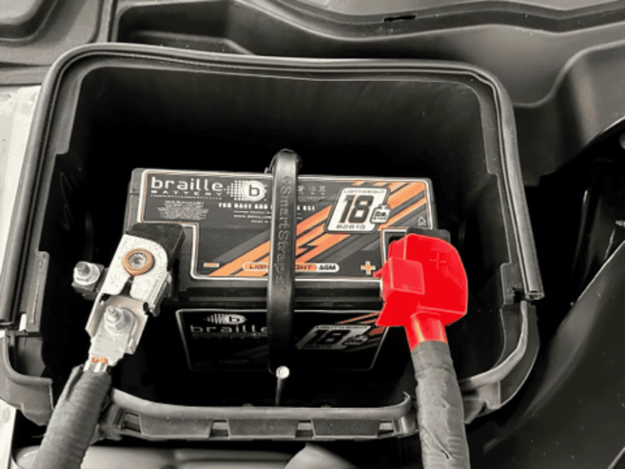

I have the AG 20HD and it's ridiculous how strong it cranks the car. And that's compared to the stock battery when brand new. Yes, it's small, but there are several, bolt in mounting solutions to fit the stock box.

antigravity ATX 30hd kind of fits, it has to be mounted sideways and the lines have to be bent, its not ideal but I made it work
