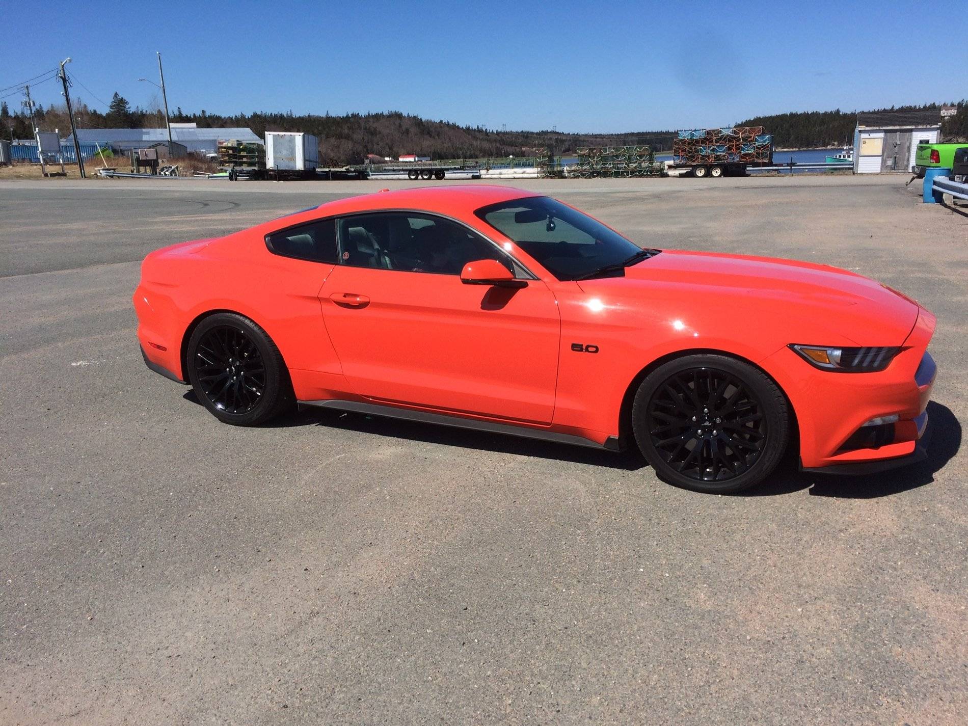

Man that’s low but looks very nice. Michigan roads can barely support my height (pics below). The rear looks a little lower than the front but it could just be the angle.

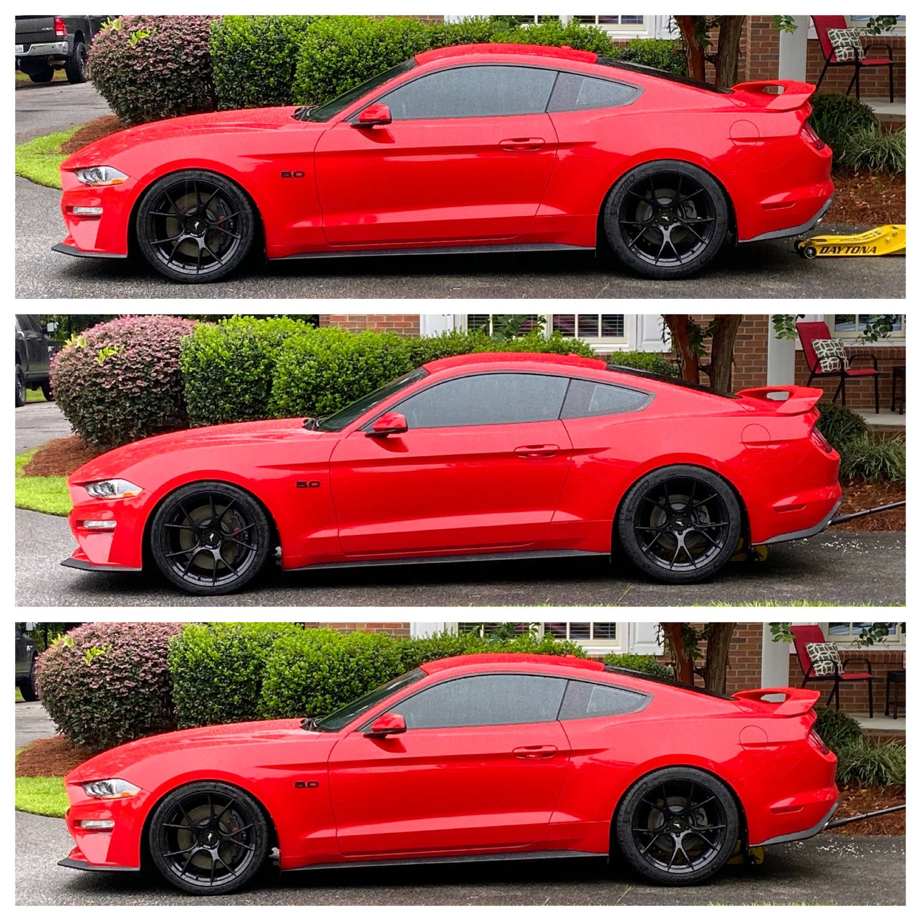

So I did a little testing to see how it would look raised 1/4” and 1/2” in the back. The top photo is current setup, middle is raised 1/4”, and bottom is raised 1/2”. I’m leaning towards raising the back 1/4”. I like the wheel gap raised 1/2”, but I’m not sure I want that much rake, and I’m thinking 1/4” may be the best compromise. Which do you think looks best?

1/4" in the rear. Steeda sells spacers that can do that for you (1/8" spacers for 1/4" raise). I think 1/2 is too much.

Oh also, you could try adding 5mm wheel spacers in the front which would get rid of some of the shadow that makes it look like more fender gap.

Thanks. If I do raise it, the Steeda spacers are what I plan on using. They have ones for 1/4, 1/2, and 3/4 raise, so it shouldn’t be too difficult to get the lift if I go that route.

I like the top one . I went out and measured mine at the pinch welds rear of front tire and front of rear tire . Half inch difference with the rear being higher . Since I'm dropped aproxmently 1.5 front and rear , that would lead me to believe that the factory rake would be .5 inch .

That 1/4" looks great to me. Do the spaces change how the car rides?
I haven’t added any spacers yet to see how it drives. I just used a Jack to get an idea of how it would look. The Steeda spacers are not supposed to make any change in ride quality.
