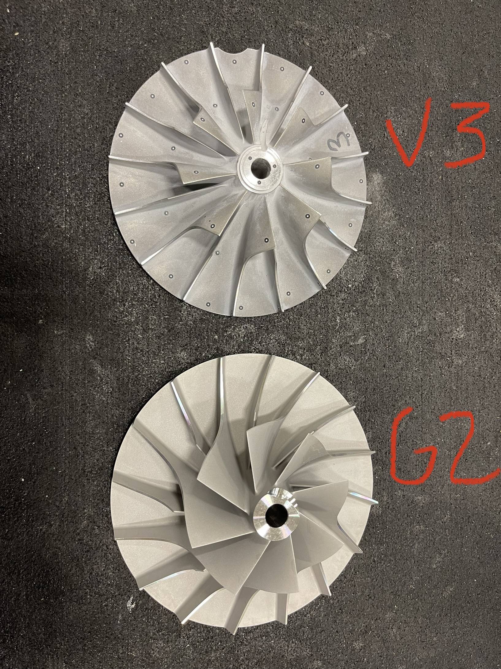

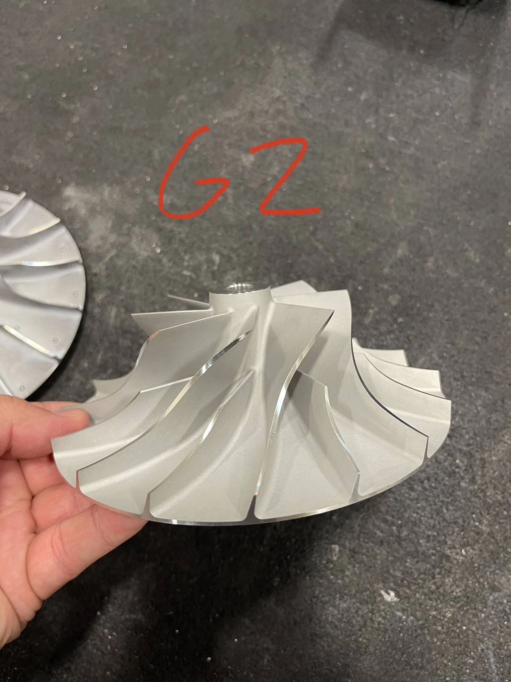

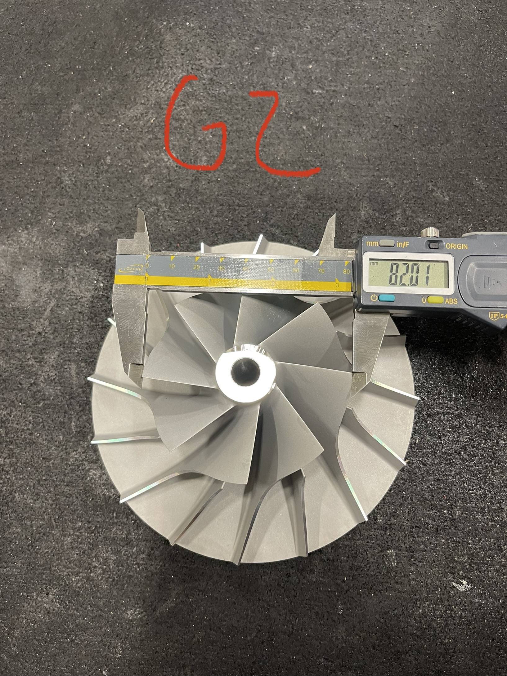

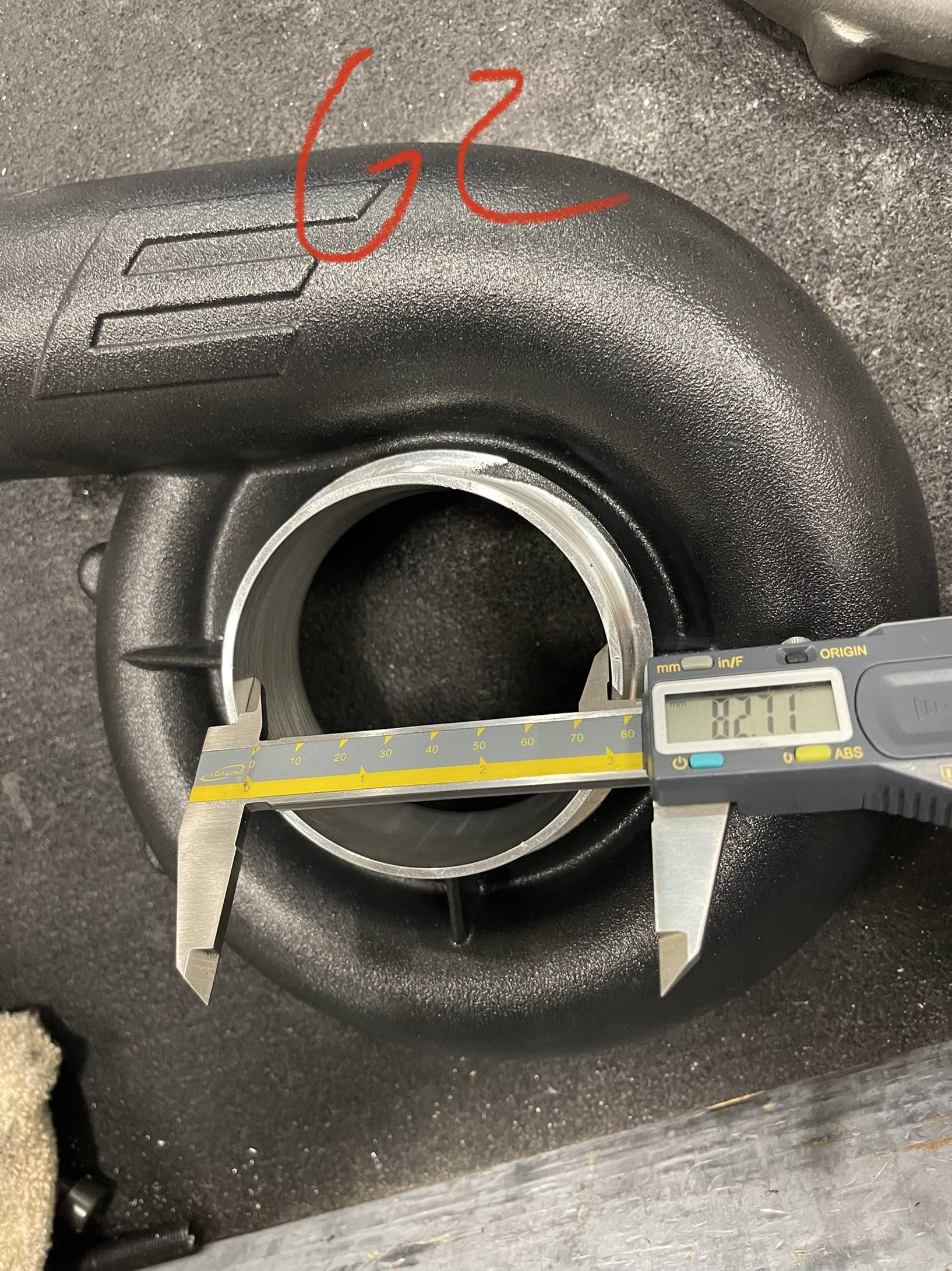

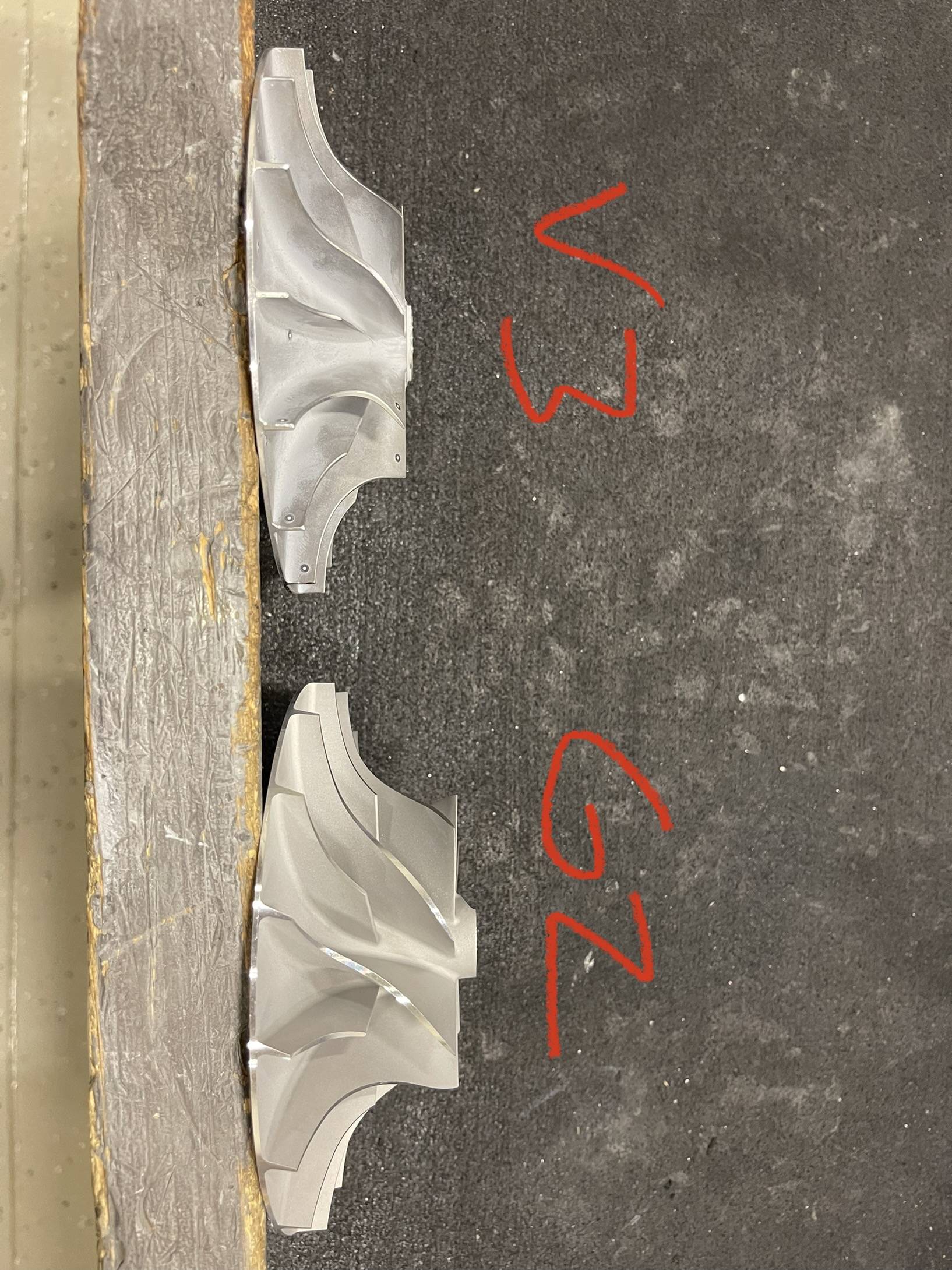

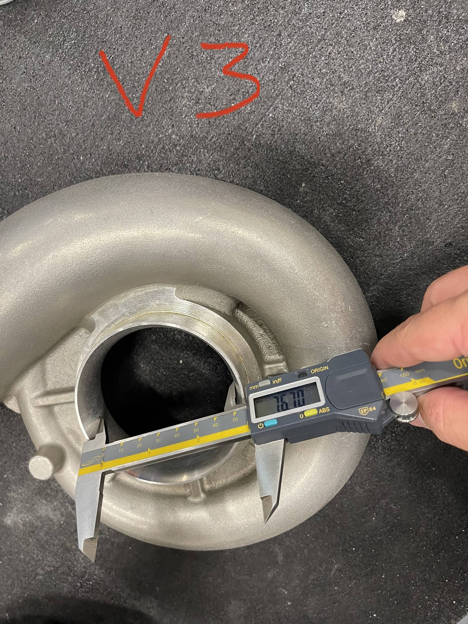

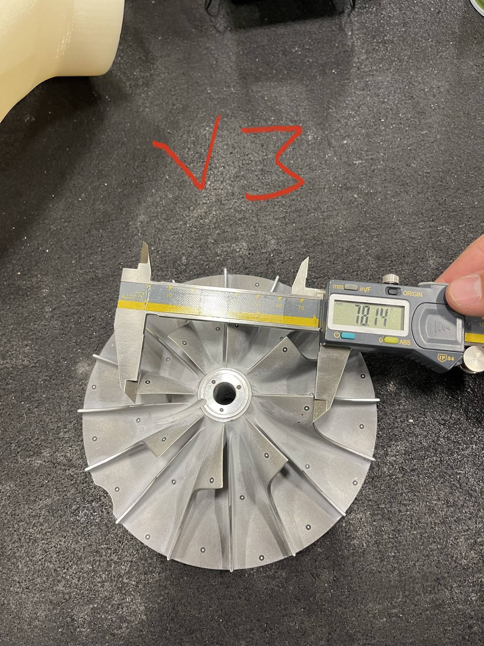

I have noticed posts being made about the G2 being the “smaller” head unit in comparison to competing systems base head units. Consequently, putting the G3 in place of the G2 as the comparable system. I just wanted to clear things up and make sure the facts are out there. And just for fun I decided to do a size comparison with two blowers I had sitting at the shop. One being the G2 and the other a V3si which are both the “base” head units in their respectable kits.
First, some performance specs as provided by both manufactures:
V3si
Max speed: 52,000
Max flow: 1,150 CFM
Max power: 775 (crank HP)
Discharge OD: 2.75”
Inlet OD: 3.5”
Inducer diameter 3.1” (78.1mm)
G2
Max speed: 57,000
Max flow: 1,300 CFM
Max power: 800+whp
Discharge OD: 2.75”
Inlet OD: 3.5”
Inducer diameter 3.2” (82mm)
Here are a few pictures of the two impellers and volutes for comparison. As you will see, the G2 doesn’t just have more capacity on paper, it is also physically larger in both inducer and volute size while remaining much smaller and lighter in overall physical size and weight. When spun to max RPM, we have seen over 900 whp with the proper supporting mods. We commonly see 800+ whp on standard setups.

I have noticed posts being made about the V3 being the “smaller” head unit in comparison to competing systems base head units. I just wanted to clear things up and make sure the facts are out there. the base head unit in our kits is a V3 JT, or a 2200 sl or compared to a g2.
In packages that contain the v3si, customers can opt for the v3si or v3jt or 2200sl in any of our kits at no charge. In our packages that contain a 2200sl or v3jt, customer can opt for a v3si at no charge
Some performance specs as provided by both manufactures:
Paxton 2200SL / V3JT
Performance Specs
Internal Step-Up Ratio: 3.61:1
Max Speed: 52,000 RPM
Max Boost: 27 PSI
Max Flow: 1,450 CFM
Max Power: 1,000 HP
Peak Efficiency: 76%
Dimensions
Discharge OD: 3.0"
Inlet OD: 4.0"
Discharge ID: 2.64"
Inducer Diameter: 3.486"
G2
Max speed: 57,000
Max flow: 1,300 CFM
Max power: 800+whp
Discharge OD: 2.75”
Inlet OD: 3.5”

I like facts through comparison measurements. ESS IS definitely, noticeably a more robust flowing turbine. Thanks
