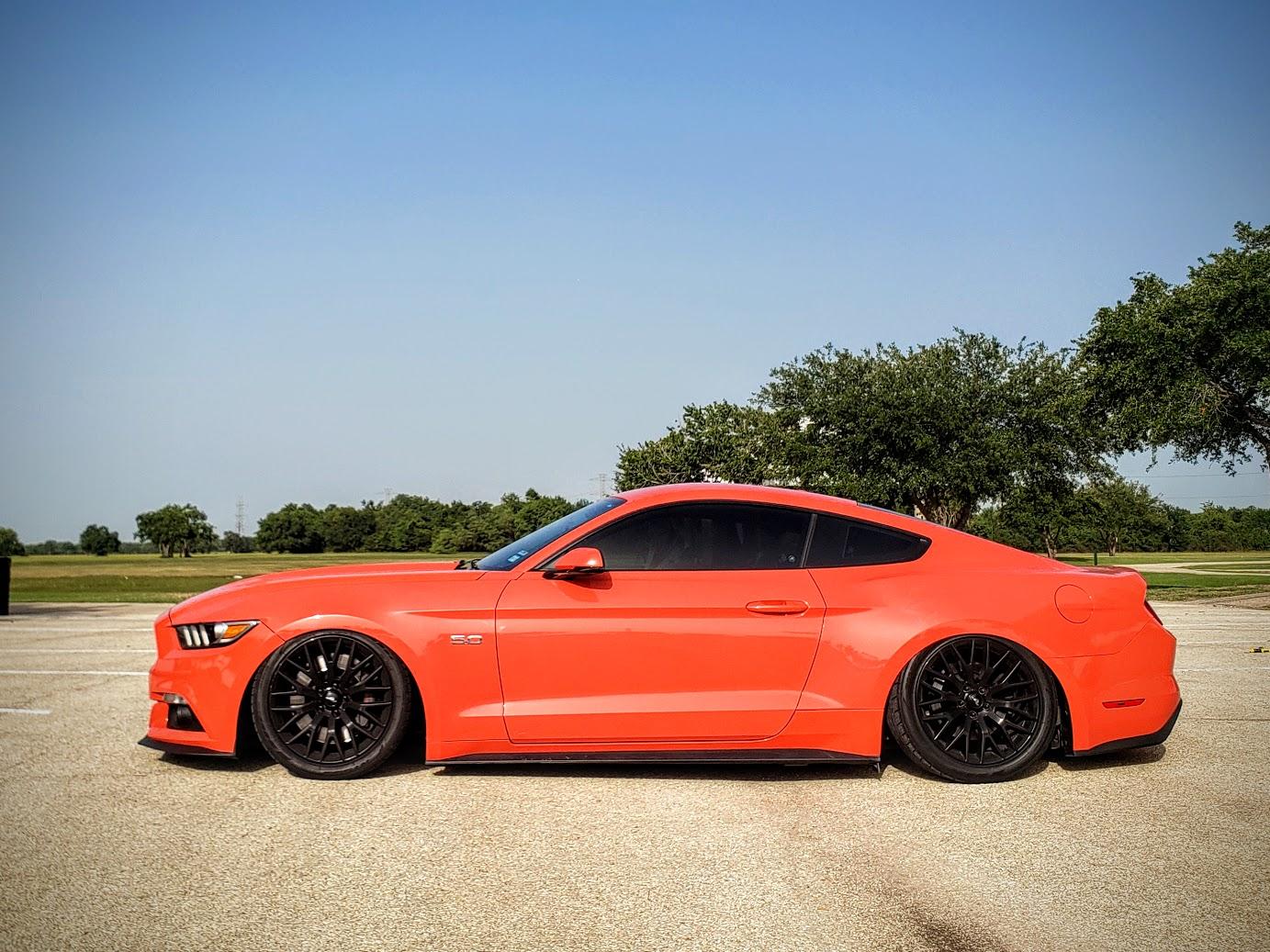

My biggest question is how did you guys justify the expense from say traditional springs to an air kit? I also want to know if you guys adjust the height a decent amount once the "novelty" wears off, if that makes sense.
For me, I've always wanted air on my rides, but couldn't afford it. Last Feb, Air Lift ran a 25% off deal and I had my tax return, so it worked out that I had the money at the time. It was the first major mod for the mustang, so I jumped on it.
I paid retail, but like others have stated here, you can find the same kit for less if you shop around. You might even find a certified dealer for Air Lift in your area and see if they might swing you a deal. The guy I found here in Houston, unfortunately after I purchased my kit, let me know he could have gotten it for me much cheaper.

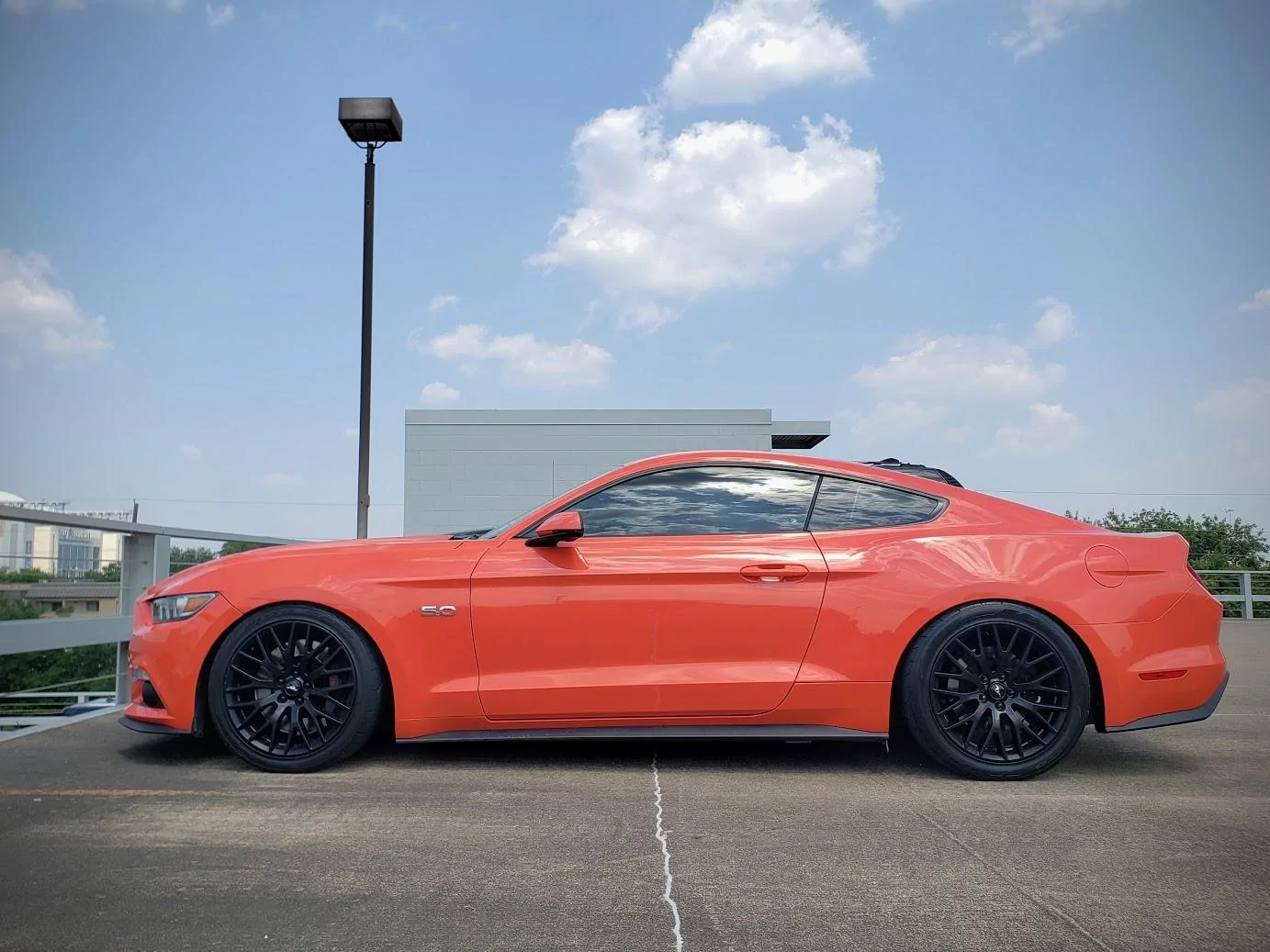

In regards to the novelty height inquiry, you can only go so low before it's impractical and/or just dangerous for your front fenders. I keep my height as low as I can go without damaging the fenders or rubbing in high speed cornering. Mine is set where the bottom of the fender line is about in line with the top of the tire. There may be 1/4 inch gap there. I'll snap a picture for you here in a bit.
The novelty of it never wears off for me, however, once you find your height you probably won't change it much, unless you're showing off for people.

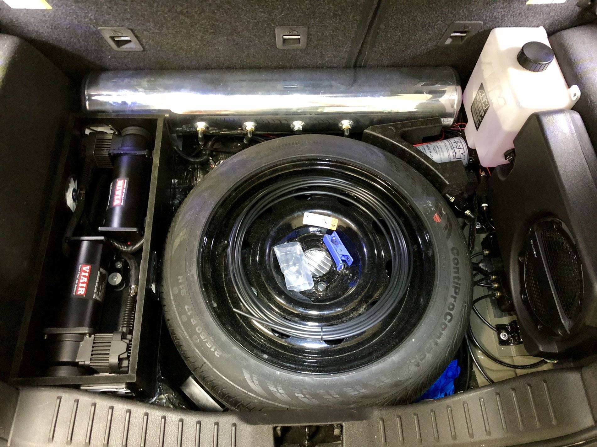

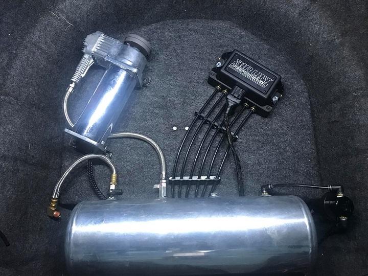

Pre-plan everything. I changed up my trunk setup twice. The compressor will be loud IF you attach it to any sheet metal of the car. I mounted mine to wood covered in an oil resistant trunk cover from Wal-Mart. It had some padding to it but the wood also isolates the vibration so it doesn't transfer to the car. Inside you can hear the compressor running but it's not annoying and I tend to forget it's there. Outside you can't hear it over the Roush axle backs. Mounting it to the trunk pan will make it sound like a subwoofer vibrating in there and be annoying amplified.
Mine is all hidden in the spare tire well that had no spare tire since I'm a PP. Space is much better utilized :)
I bought an air compressor leader line from Home Depot with a shut off valve and connected it to my air tank. I also bought a 20' rubber air line with air chuck so I can fill tires up if need be without having to use the Ford compressor. This is part of my "away from home" kit I throw in the car.
The Airlift kit comes with a valve that you use to drain water from the tank. This also seems to double as a fill valve so if your compressor does fail and your tank is empty you should be able to use any compressor to fill the tank up with at least some air to put into yours bags so it's not on the ground. As long as you don't let the kit down the bags should hold air as seen in my next story.

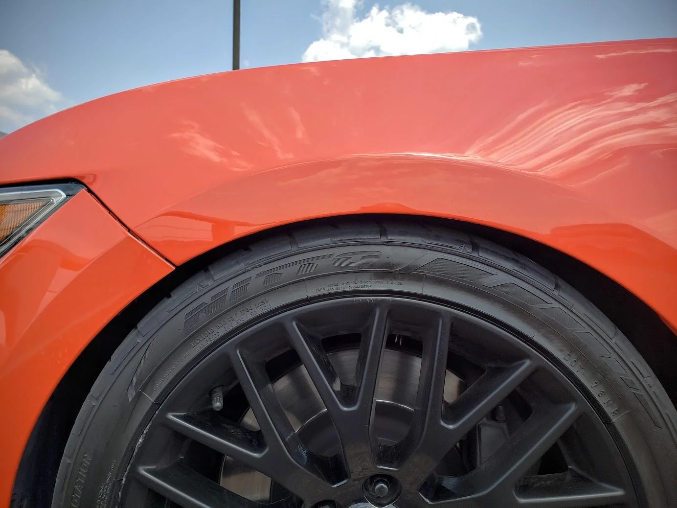

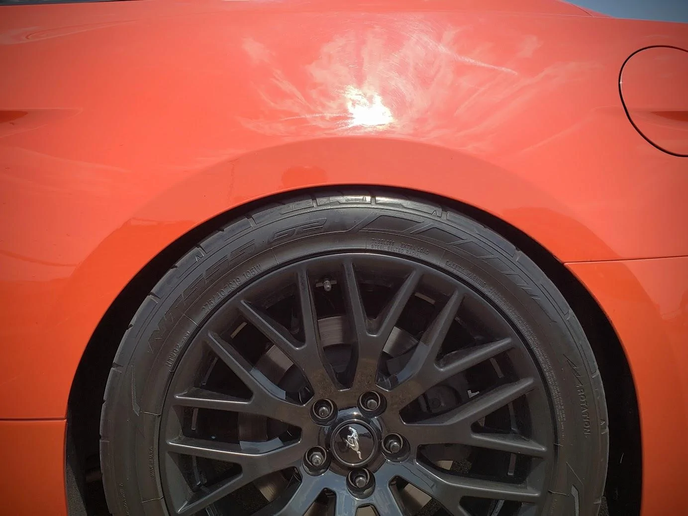

Make sure your wheels are straight. I hit the wrong button for ride height and set the car down on the low settings and came close to crushing my fenders.

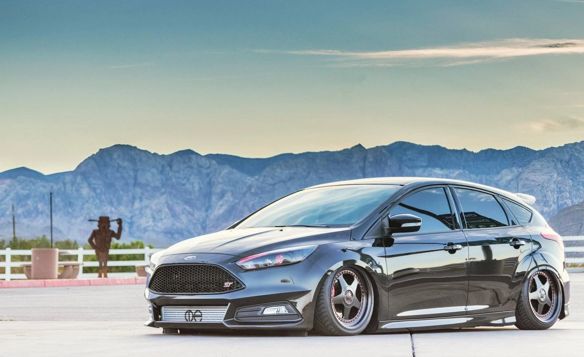

https://www.cjponyparts.com/air-lif...cus-st-2013-2018-focus-rs-2016-2018/p/SUSK76/
mine was for a Focus ST. It cost more then a mustang kit, but deals are out there. A local just bagged his 18 GT for 1700 from a guy selling it off his 15.
