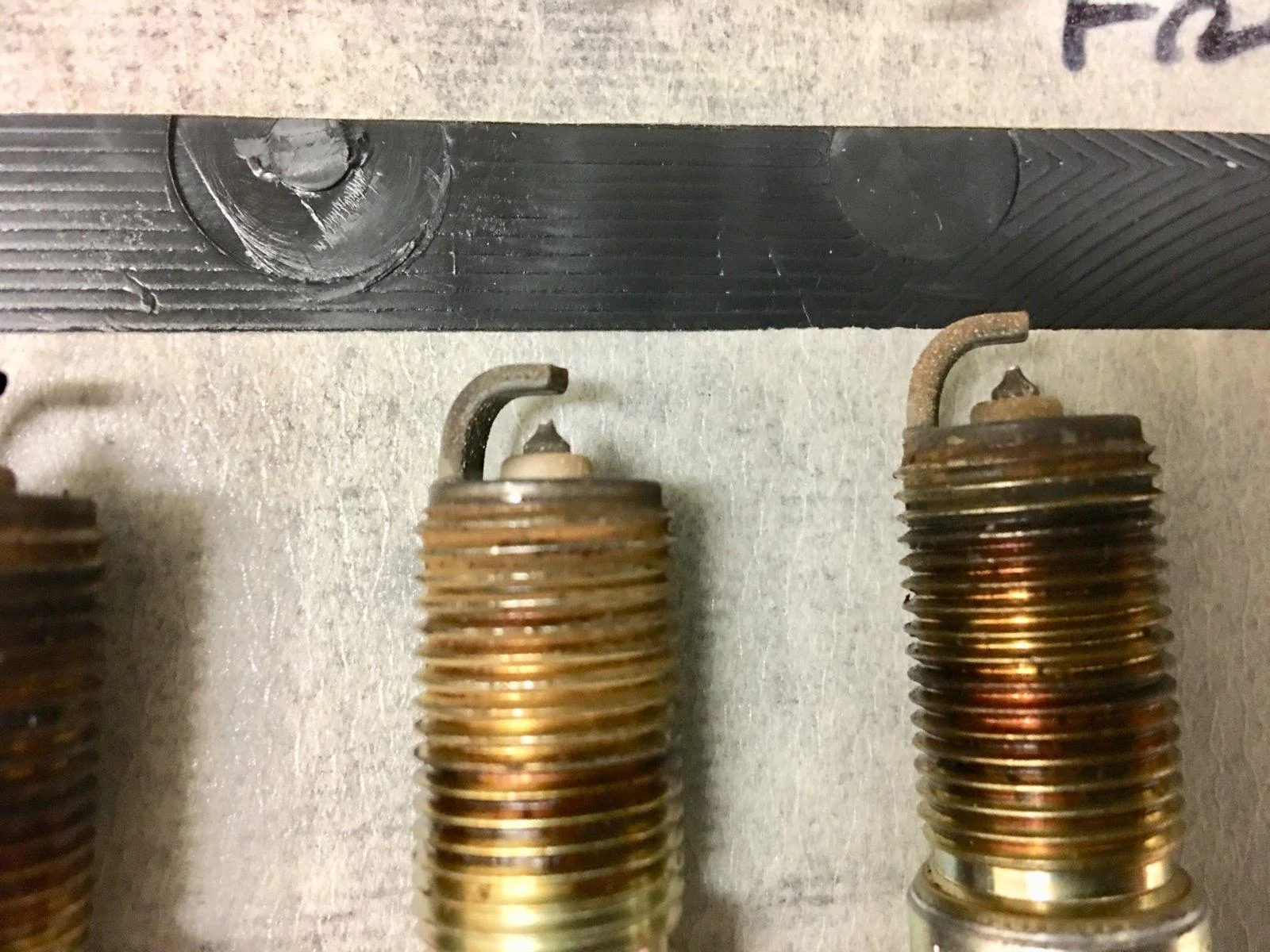

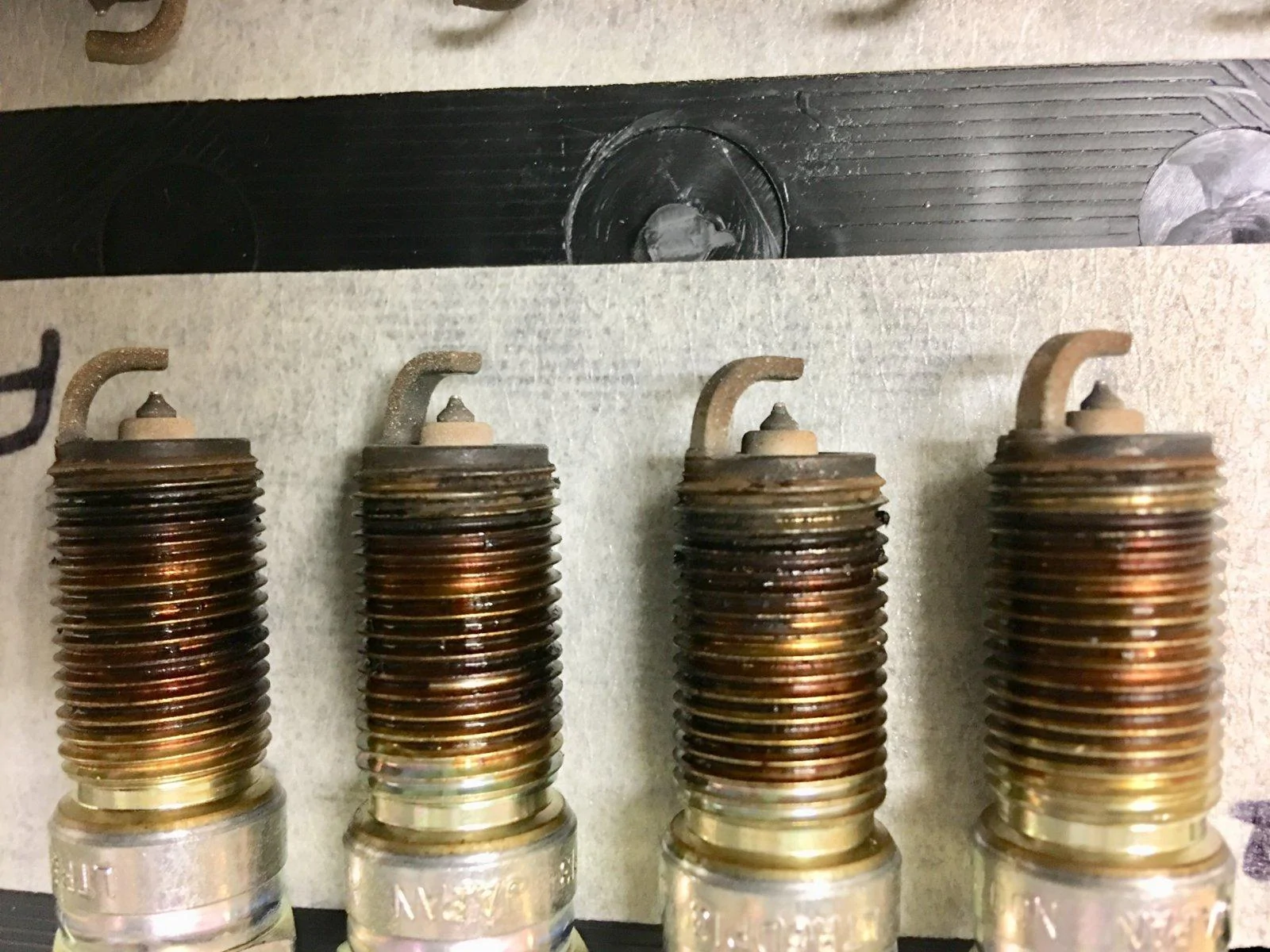

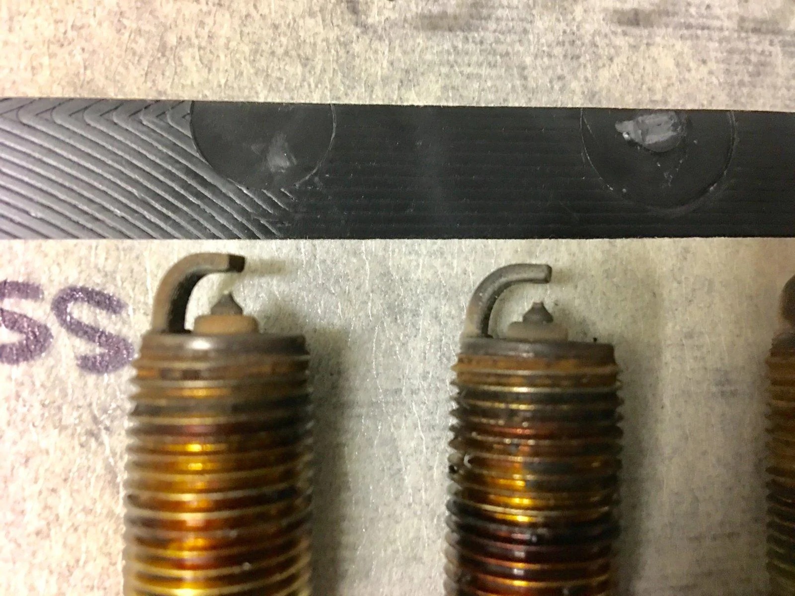

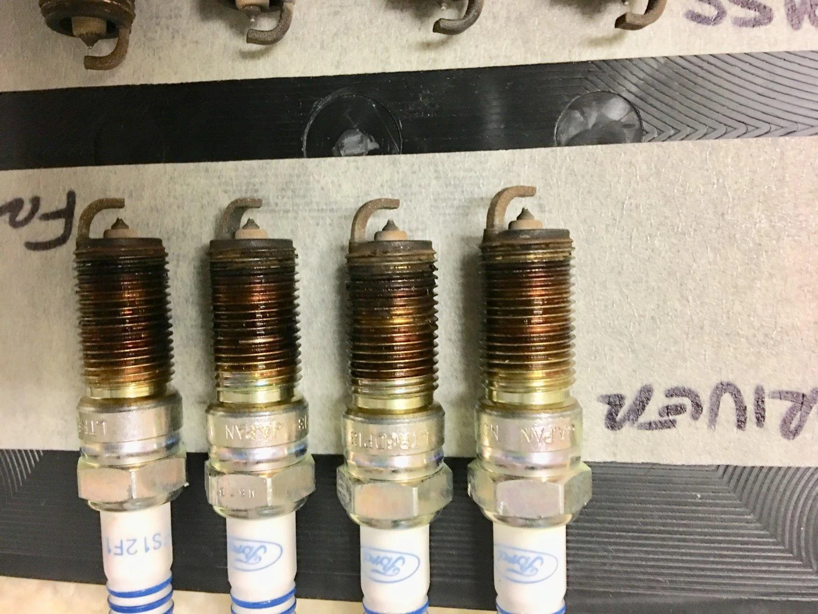

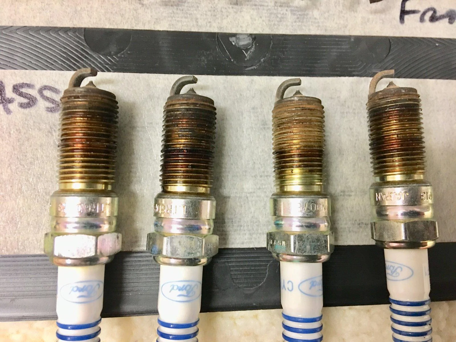

at about 35k miles on my 2016 S550 while on the highway cruising at 80mph, the CEL started flashing intermittently then would go out and then flashing agin. At that time I was planning on changing the sparkplugs and did so. After about another 4K same issue. Got off highway and no more flashing CEL and was fine even at full throttle.
Any ideas what it could be? If it were a bad ciol I would think I would have a CEL most of the time?
Here are what the plugs I replaced look,like.

Bad COP connection maybe? Possible the electrical connection opens up slightly when hot? Either that or a marginal coil. I'd guess connection, since you said it went away for a short time.
EDIT: I mean the connection from coil to plug, NOT the wiring on top of the coil.
Did you use any dielectric grease on reassembly? I've seen too many people grease the connection instead of the ceramic.
Plug colors look good, but did you check the gaps?
I know you said it didn't set a CEL, but did you scan for any pending codes?

Check codes, likely misfire cyl 8 or 6 or an emissions “leak” code. culprit is either ignition coil, cracked intake manifold runner, or purge control valve. You already changed sparks and I assume you gapped them.
Troubleshooting steps should be plugs>coil>purge valve>intake mani replacement.
EDIT: to directly answer your question, a flashing CEL means misfire
