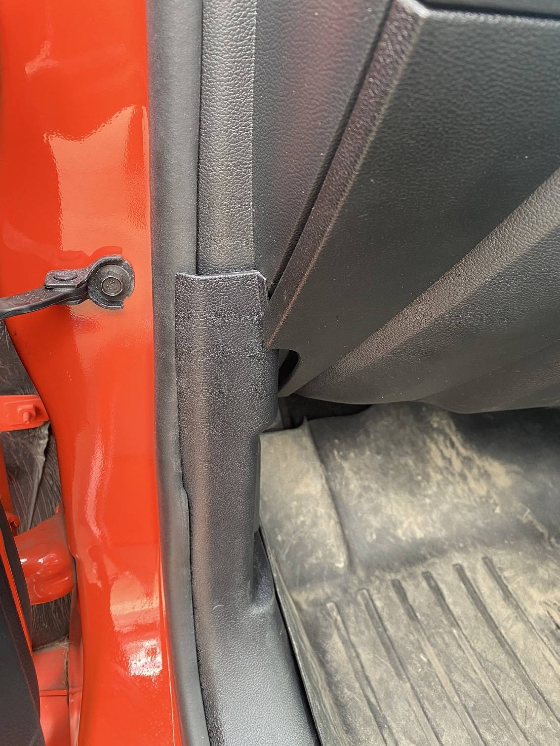

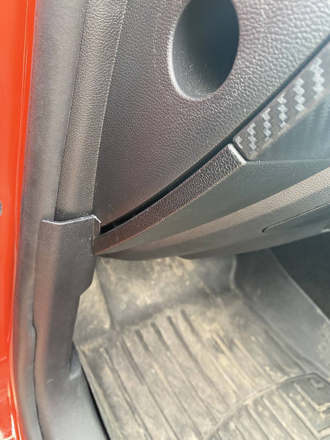

I just got my car back from the dealer and I noticed the driver side floor trim wasn't properly put back on. I'd rather do it myself since I'd rather not go back. I just wanted to know if I can pull the trims out without damaging the plastic. Please see the pictures.

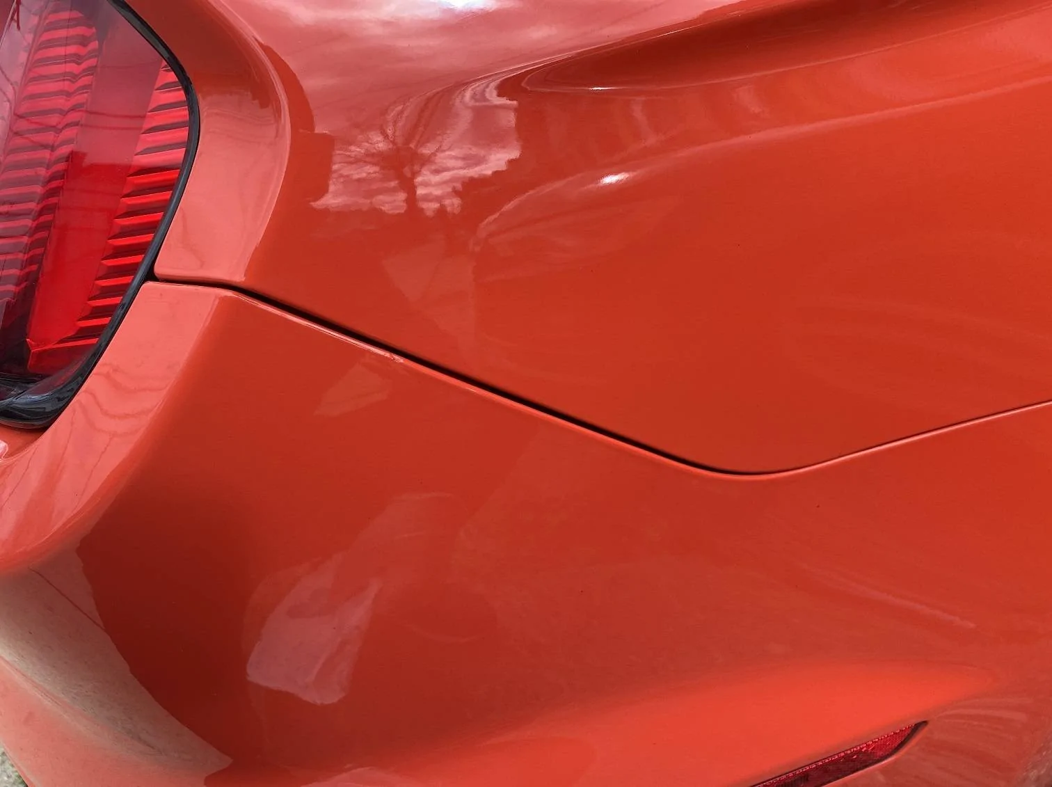

They also messed up the bumper cover alignment. They said they will need to order a bracket and that would fix it.

Yes, you should be able to remove the door trim without issue. I pulled mine off to run the wires for my nGuage without issue. Just go slow.

Well, that was some sloppy work right there!
Fortunately, the plastic trim is pretty easy to work with. Just get your fingers under it and tug firmly. I'd reccomend against using any metal tools to get it started. If you cannot get it up with just your hands get a set of plastic trim tools.

i'd fix the trim myself as i wouldn't want them touching my car again, but i would send the pictures to the service manager or GM of the place. Good lord, how high were they when they put that back together.
