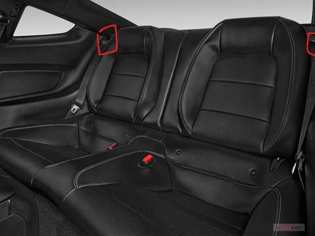

Does the large interior quarter panel plastic trim come out easily? It starts unclipping without any effort if you pull from the door jam, but I want to make sure there isn't anything further back I should be aware of before I try to remove it. Also, should the rear seats be removed first?

There is a rectangular trim that holds onto the seat belt retension. Leave it dangling when unclipped. Pic below. When I did it, I removed the seat bottoms (Use your hand and push inside the center underneath each seat) but I left the rear seat backing laying flat.

Awesome, thanks for the information. The entire plastic piece is just clips all the way around?

Yes. And velcro at the bottom by the kickpanel.
