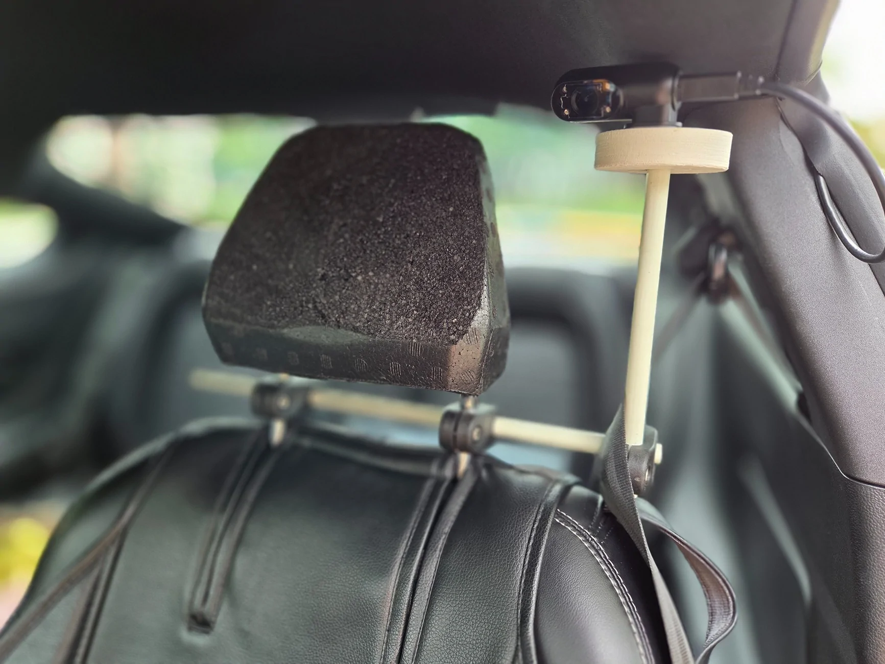

I mounted my interior camera to the track-day headrest using three rod connectors sourced from McMaster.
After optimizing the left/right and up/down position for the best view of my digital dash, I can now see RPM, speed, and the 3 center gauges for axle-cht-trans temps. My left hand blocks the gear number, but that becomes visible as I steer.
The two headrest posts measure 0.500". I had a length of 1/2" plastic rod lying around which also measured exactly 0.500", and then I found these connectors on McMaster. (1/2" poplar dowel rod from the home improvement store would have also worked.)
I made the camera platform from a scrap piece of PVC board. I cross-drilled and then tapped a hole for 1/4-20 thread, and used a cap screw to secure it to the vertical post. That was before using a 3" hole saw to make the platform round.
I re-routed the cable from the right-rear upper windshield to the new location. It runs behind the door gasket, and I can even tuck it completely behind the gasket when the car is configured for daily use.
After track day I swap out the two cut-down track day headrests for the regular pair. When I remove the track day headrest, the camera just comes out with it.
I bought a pair of salvage headrests for track days. This photo shows the mounted camera to the thinned-down headrest.

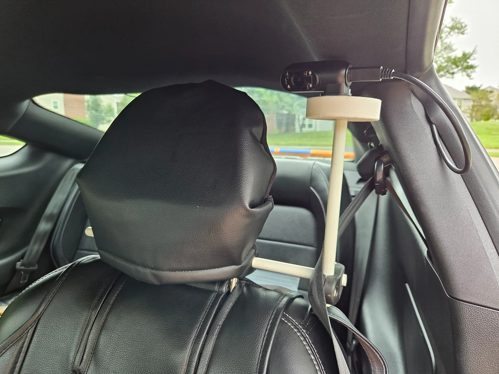

Same photo but with a cover on the headrest. The cover came with the seat cover.

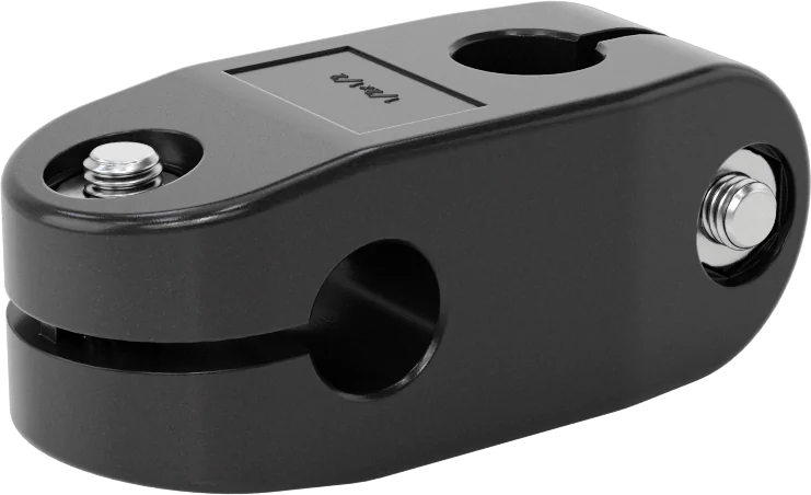

Rod connector.

About $60 from McMaster. Poplar dowel extra.

I just tested this setup at NCM last weekend. Unfortunately, my head moves around enough that it blocks the full dash view too often. I have it to the left of my head because I care more about road speed than gear#. If it was to my right then I would see gear# but not road speed.
Not sure how to proceed at this point. My objective includes not spending much more money. :frown:

I wanted to see gear#, rpm, mph, and the 3 gages I chose for Diff CHT Trans temps. My left hand blocks gear# often but I care more about mph.
Cooling is back under control again and so I monitored tire pressure more than anything else last weekend at NCM.
I will move the headrest cam further left and see if my helmet doesn't block the info so much.
