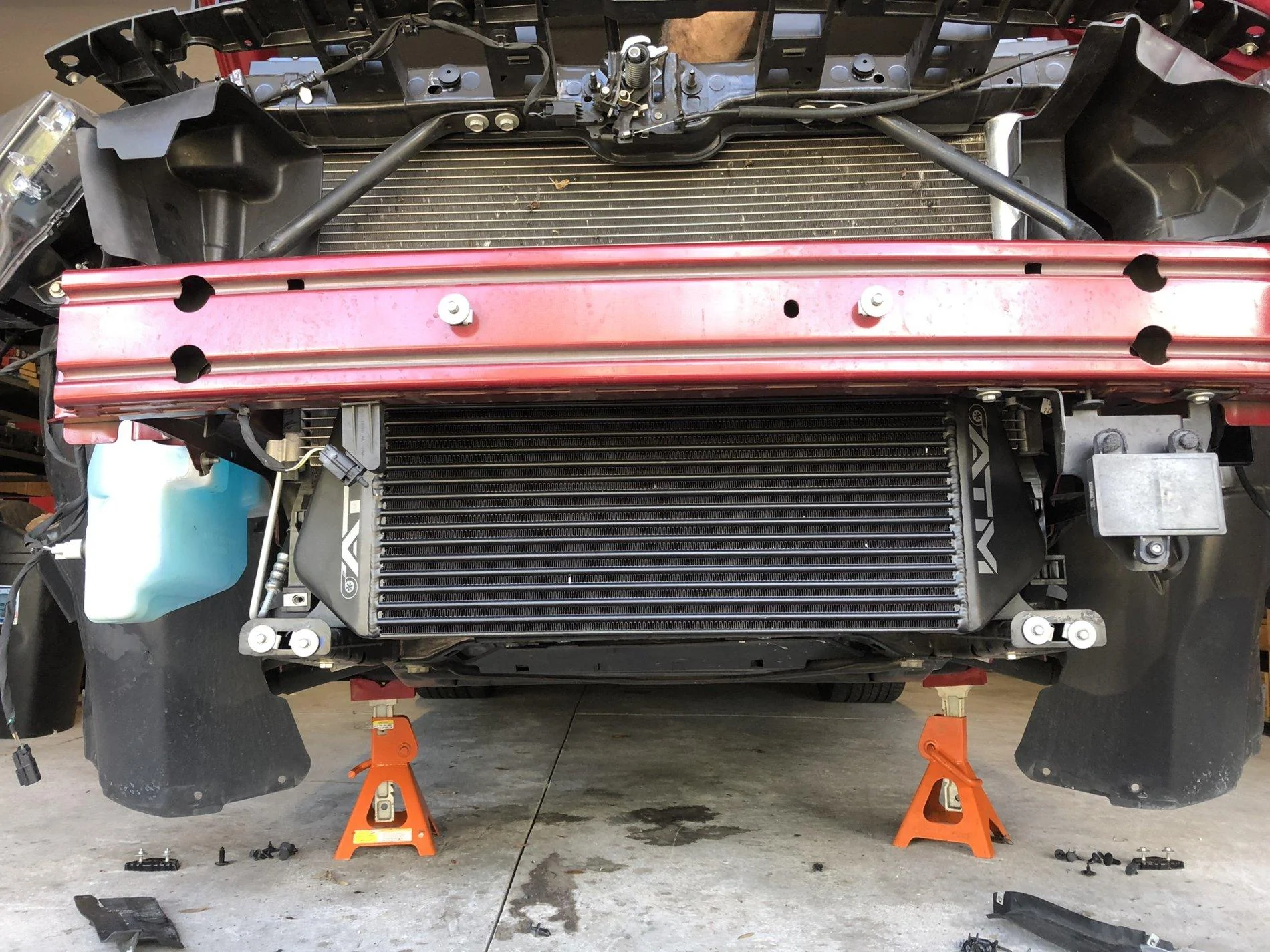

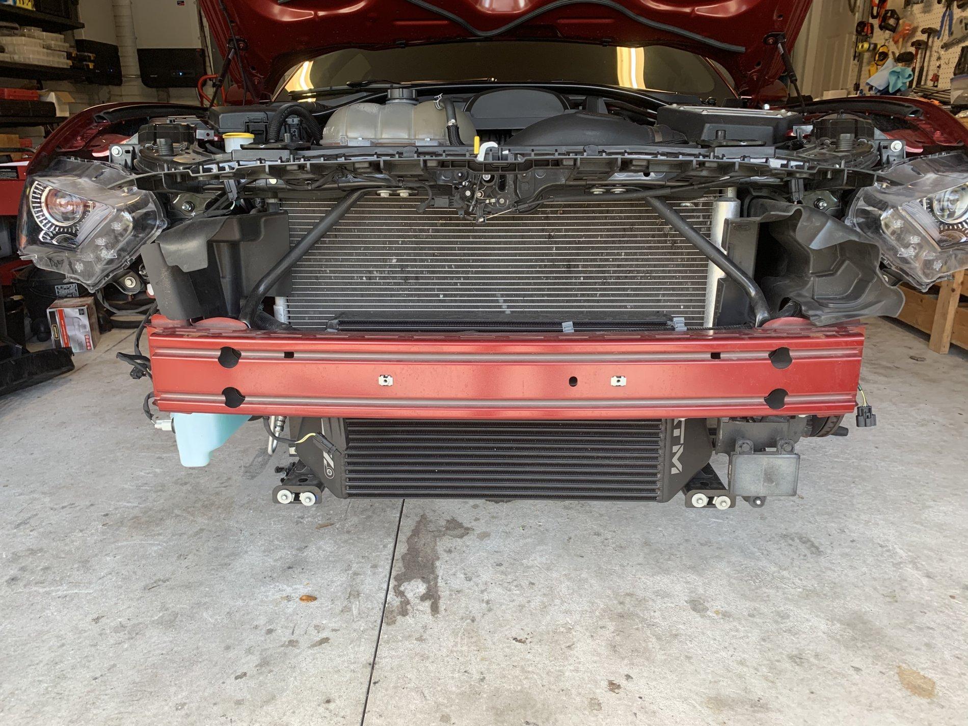

2018 Mustang EcoBoost Premium+ Ruby Red
The bumper cover doesn't use the same method of fastening at the tabs on a 2018+ as was used on the 2015-17. I've owned 2015 Eco and, yes, the bumper tabs are frail, so I ended up reinforcing with the Quik-Latches. I purchased the same latches for my 2018 Eco for my recent ATM intercooler install only to discover the bumper attaches in a much better manner now and seems to alleviate most of the problems that stress the tabs and cause failure. I ended up not using the latches. The bumper is super easy to remove on the 2018 and even with little to no mechanical ability, this would be an easy job for you in the garage or driveway. I do recommend jack stands to raise the front, only because it helps to be able to crawl under and remove the push-pins and screws to drop the splash shield, as well as make it much easier to get at the lower intercooler charge pipe couplers. If reusing the stock cold side pipe, no worries, but if you bought aftermarket pipes, when the cold pipe is pulled out, put it next to the new aftermarket pipe with couplers attached to check the length. If you put the 2015-17 cold pipe next to the 2018+ cold pipe you will see that the 2018 pipe is about 2+ inches longer due to the front end changes. Even if you don't do the work, make sure the shop you choose is aware so they don't flail away trying to make a short pipe fit. The best way to know your car is to do the work yourself which also has the benefit of saving money for even more mods, win-win!

No worries, The CVF pipes are what I used on my ATM intercooler install, and they worked for me.

And just as general FYI information... I found that I had kept the stock pipes from my 2015, so when I pulled the cold side off my 2018, I put the 2015 and 2018 stock pipes side by side in the same orientation. I was able to visually verify that the 2018 is indeed approximately 2+ inches longer. I did the same with the hot side pipes and saw no difference in length.
So what I am saying to take away from this is, if a vendor advertises their pipes as 2015+, be wary unless you contact them directly to verify fitment for 2018+. If they specifically show 2018-2019 or 2018+, then more than likely their pipe is longer or they are supplying a longer coupler(s) for their pipe.
