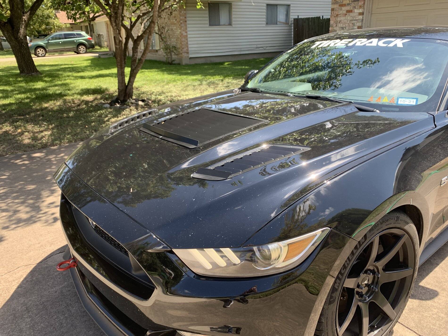

i have a bunch of lexan, ccould fabricate a cover for something,..

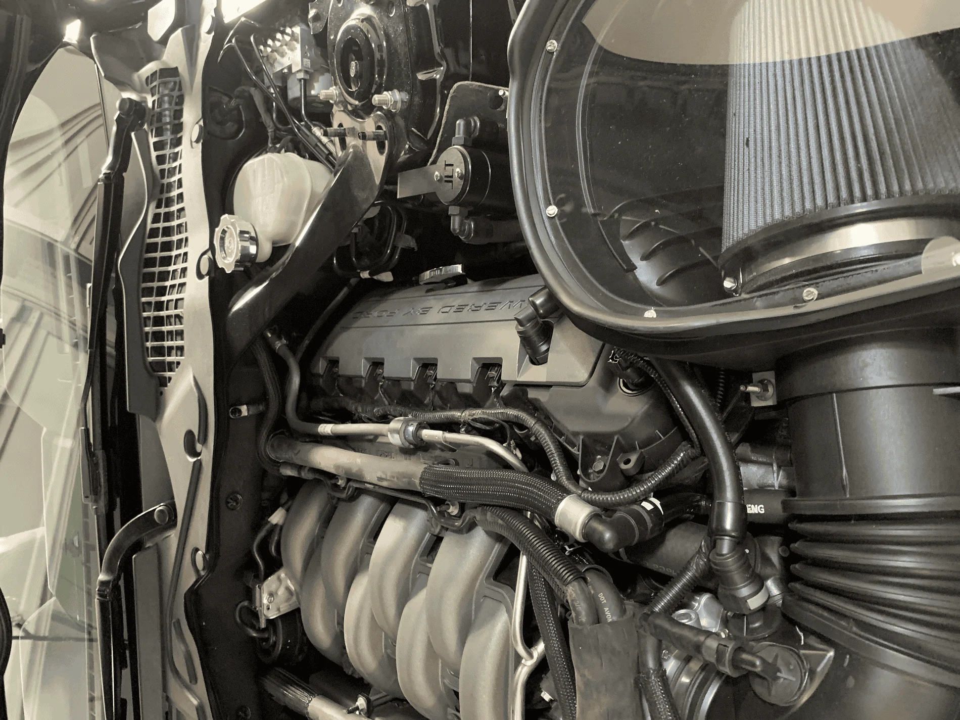

My current solution.. GT350 Intake, Sealed (home made) Lexan cover, underneath Trackspec hood vents.. Have had a full RR tune with this set-up.. All is good.

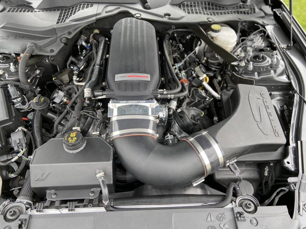

Ported CJ manifold / VMP Monoblade 137 / Steeda Closed Box (w/ insert and dry filter). Drives like stock on pump E85. It's all in the tune.
