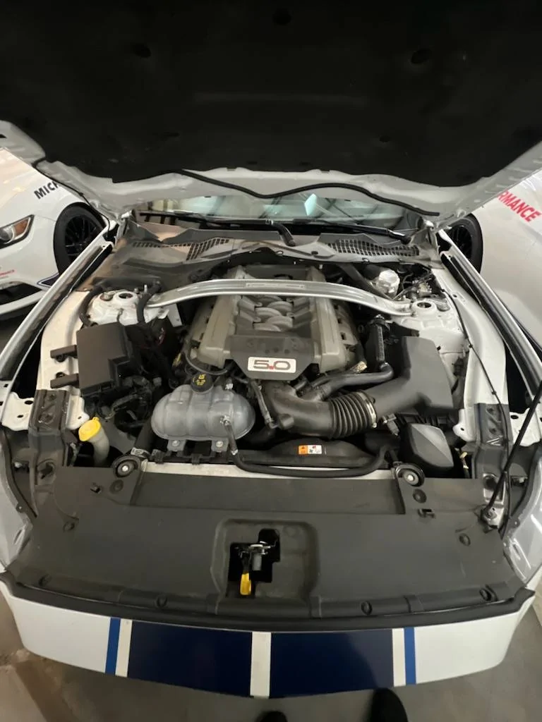

Good morning.
My car has the p0300 and p0308 codes. Been consistent and believe the intake is bad.
What are the thoughts on 2017 to 2023 coyote or gt350 intake upgrades that are in the market?
Worth it?
Ease of install and tuning?
Welcome all thoghts.
