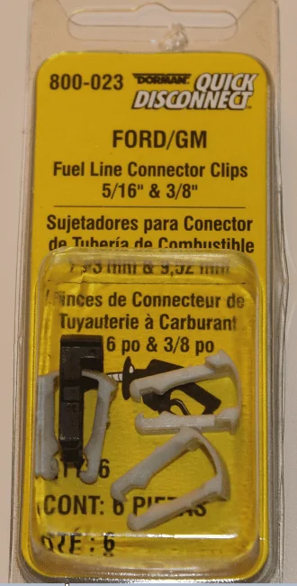

FYI...If anyone ever breaks the stupid U-shaped locking clip found in the vacuum line connectors, the replacements are size 3/8". They can be found in a 6-pack kit, Dorman part# 800-023. Any auto store should carry them. Carry on...

I broke 2 of them last year when I installed my intake. I used zip ties in place of the clip...actually worked pretty good. I was checking on some stuff under the hood today I forgot all about those broken clips lol. So I went to O'Reilly's and found these replacements.

i tried some at auto parts store and they seemed to fat. did you file or dremmel them down to size?

I used the black clips in that dorman kit. Didn't modify them at all. The white colored ones are for GM vehicles.

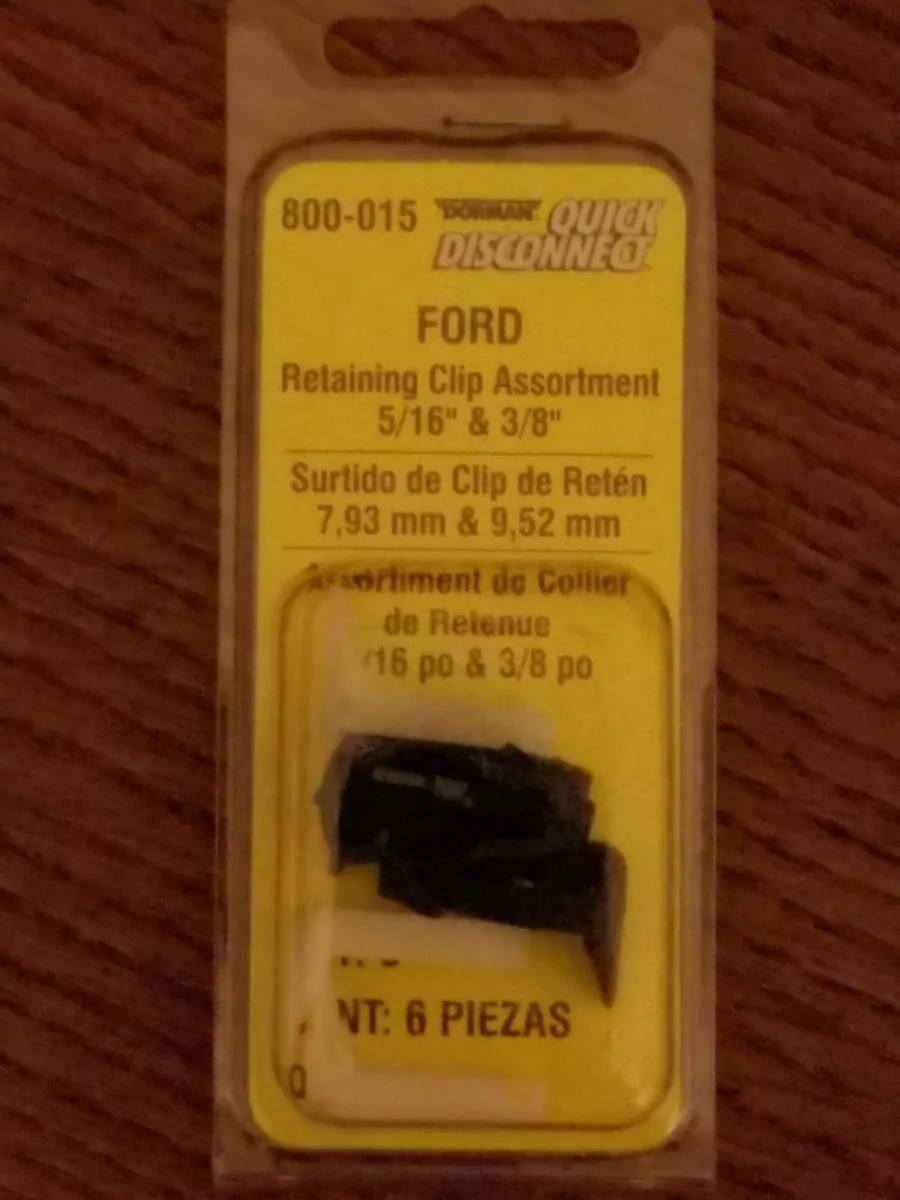

I bought the 800-015 which didn't fit at first. I had to dremel the chamfered part a bit bigger to match OE dimensions, cut off the extended push tab and it snapped on nice and snug. I'll buy something different next time. Worked in a pinch but not exactly right.
