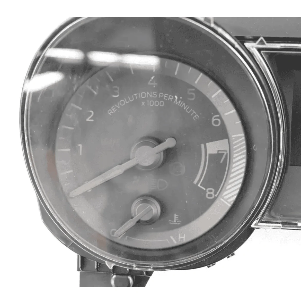

So I searched for a used 18-20 analog cluster on eBay and found me one for $70, and just a little note for anyone who is planning to do the same, make sure to buy one that has halo casue I found out that some 18-20 clusters comes in two different versions one with halo and one without it.
For instance this one has halo
And this one ain’t

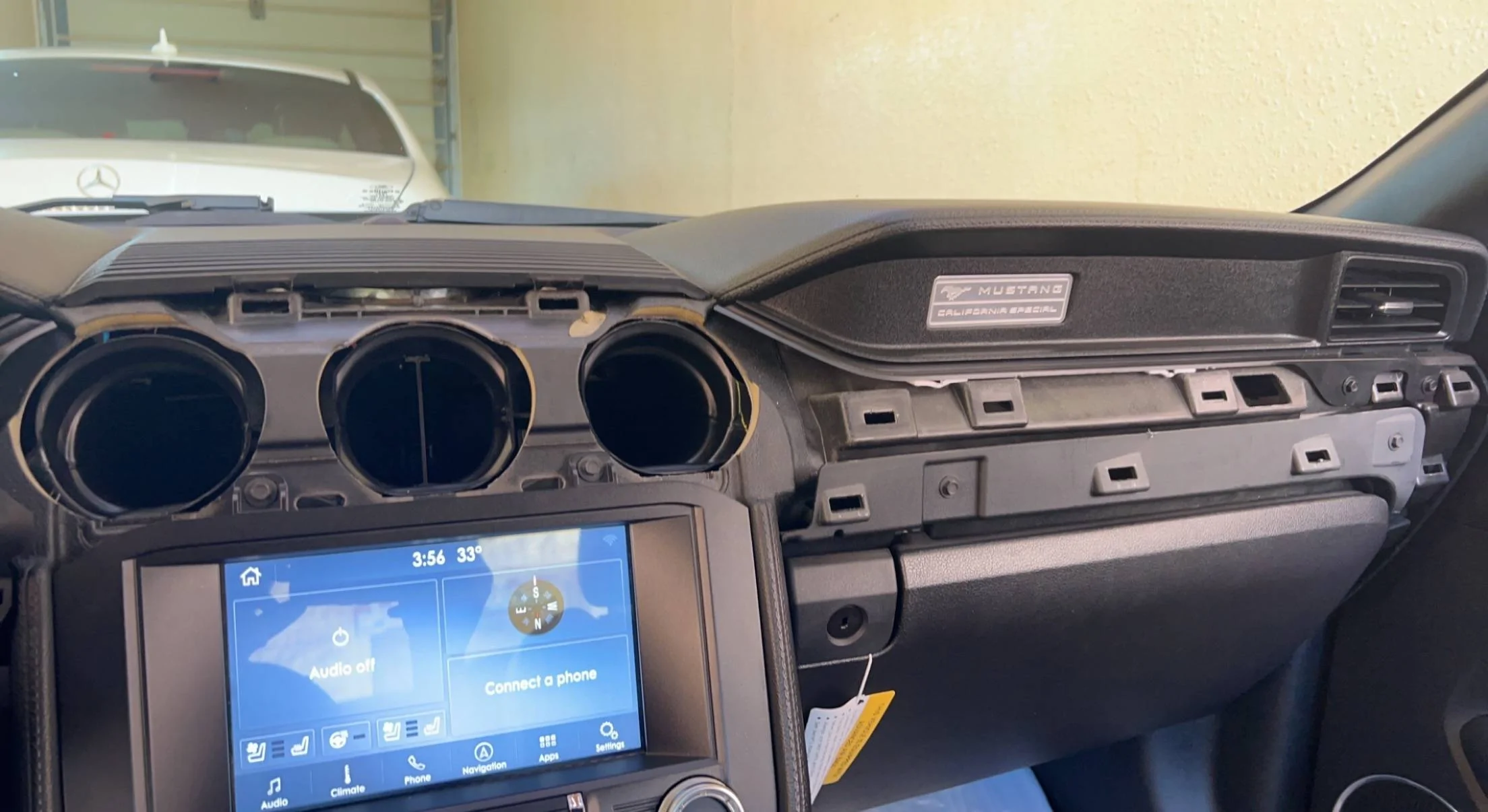

1. Remove the passenger trim and then the center dashboard vent panel

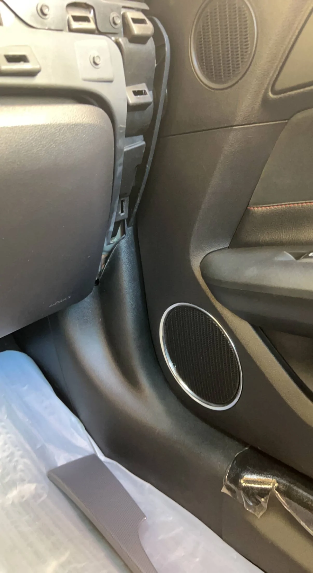

2. Remove this black speaker trim and it’s bezel screw

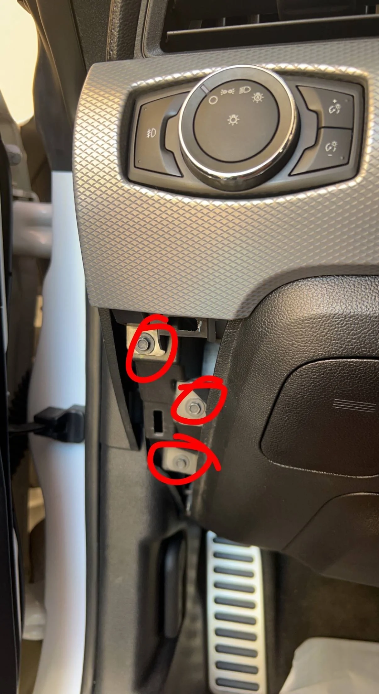

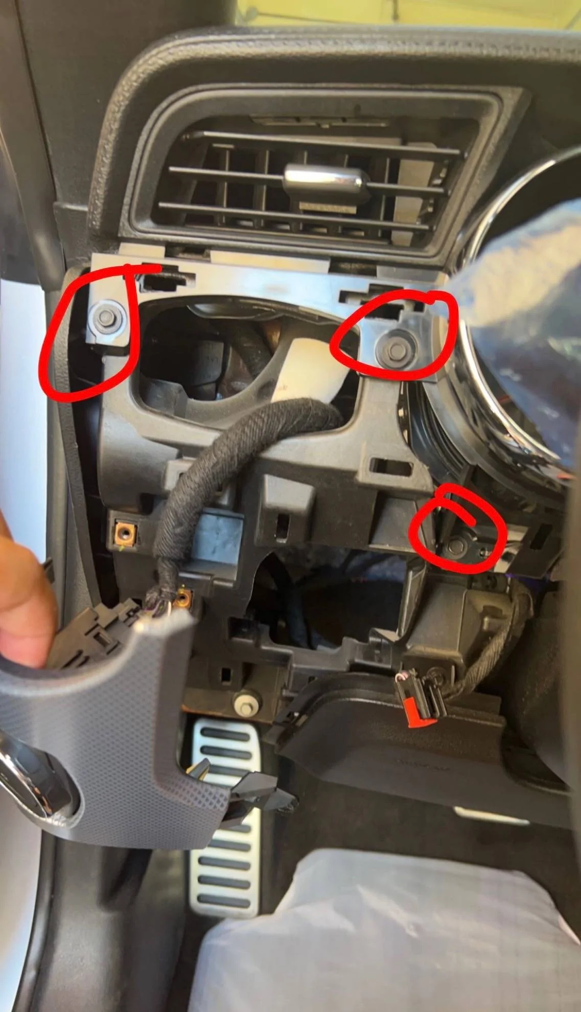

3. Remove the driver side trim and unscrew these three bolts

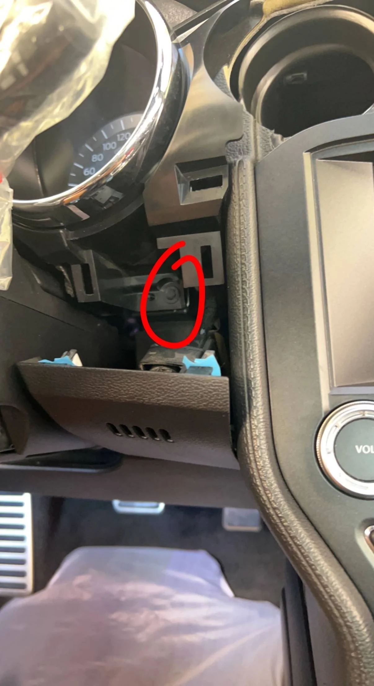

4. Now just pull the headlamps switch and the the trunk/ sun glasses trim. Super easy only clips holding them. Be careful with that trunk release harness. And then Unscrew these three bolts

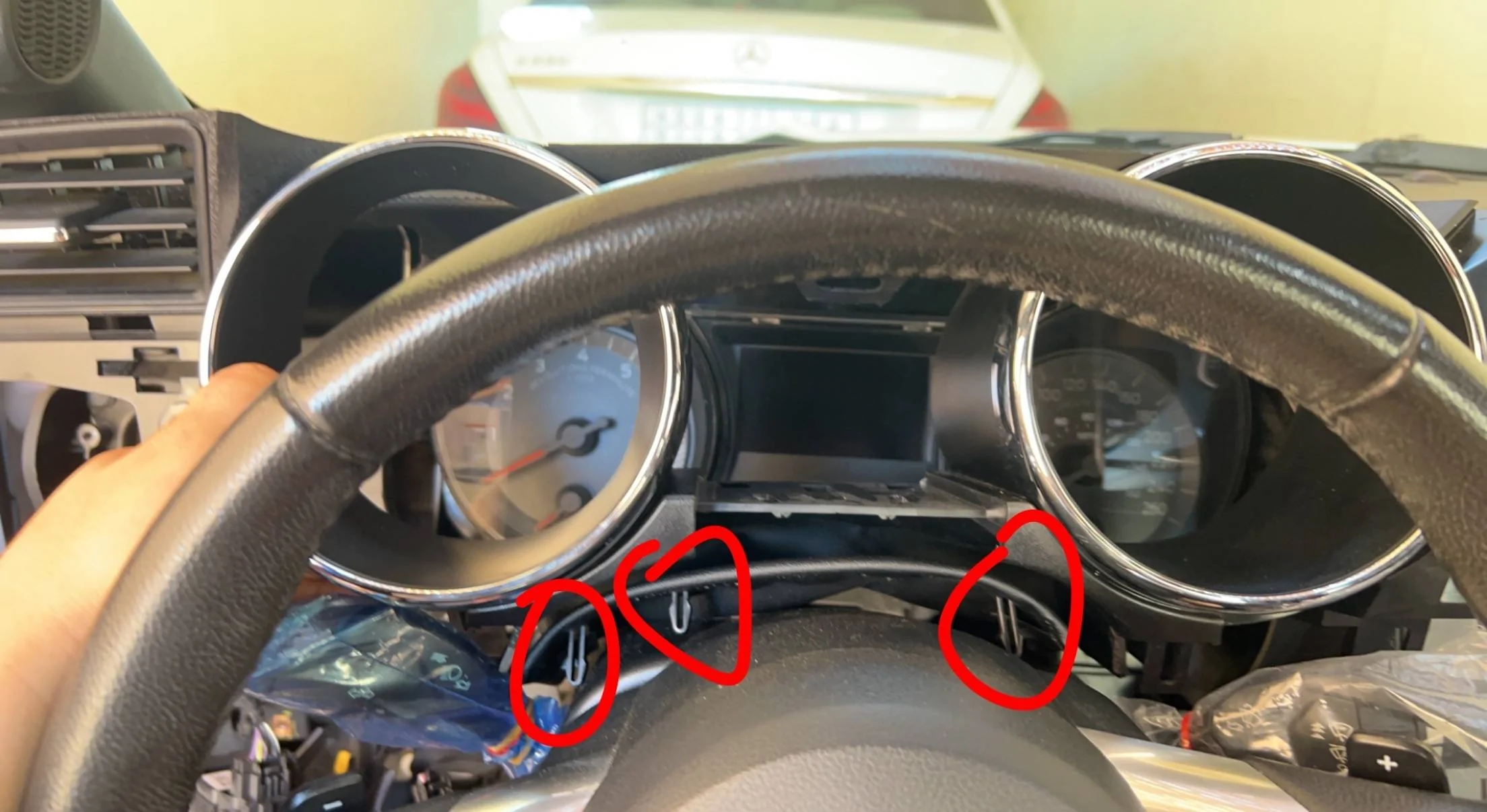

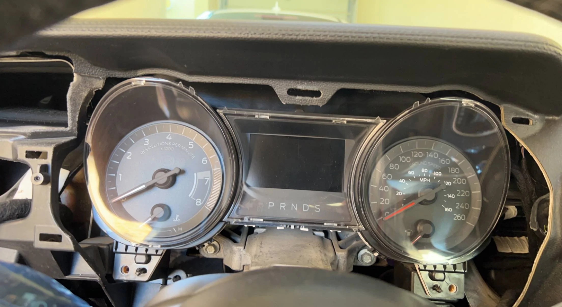

5. Now we’re almost done just pull the cluster panel start with the (bottom) there is four clips attached to the steering wheel. I broke one 😭 because I start pulling from up and didn’t know about these clips.
6. Now you can just pull the cluster out there is one clip holding the cluster harness and it was a challenge to take that sucker out.

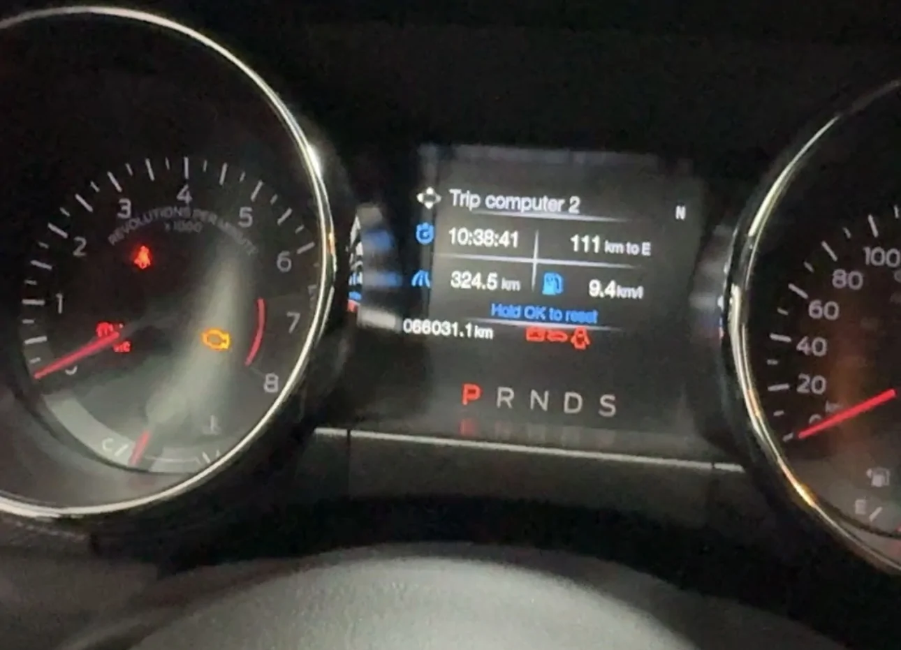

Before

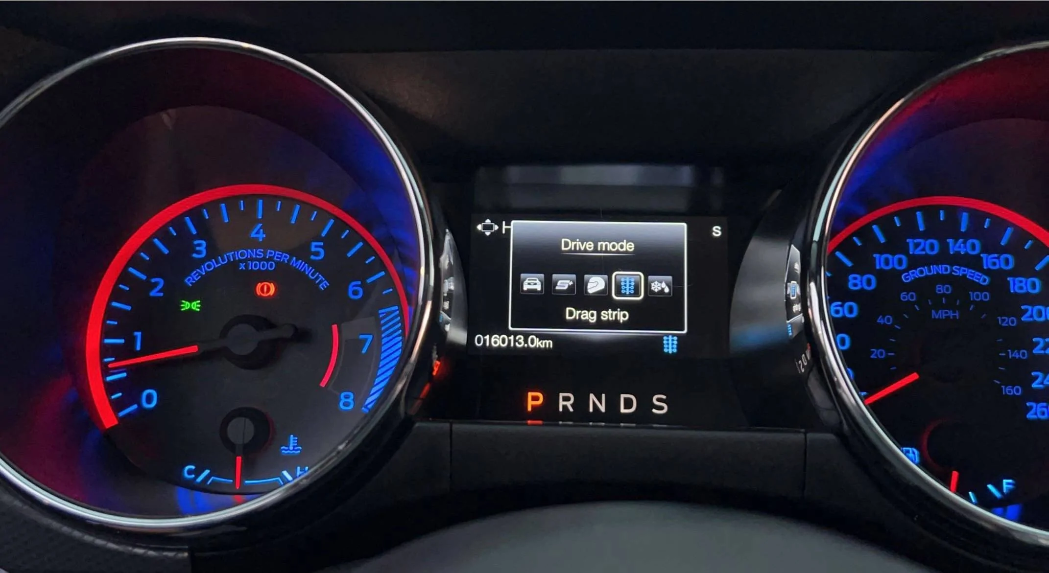

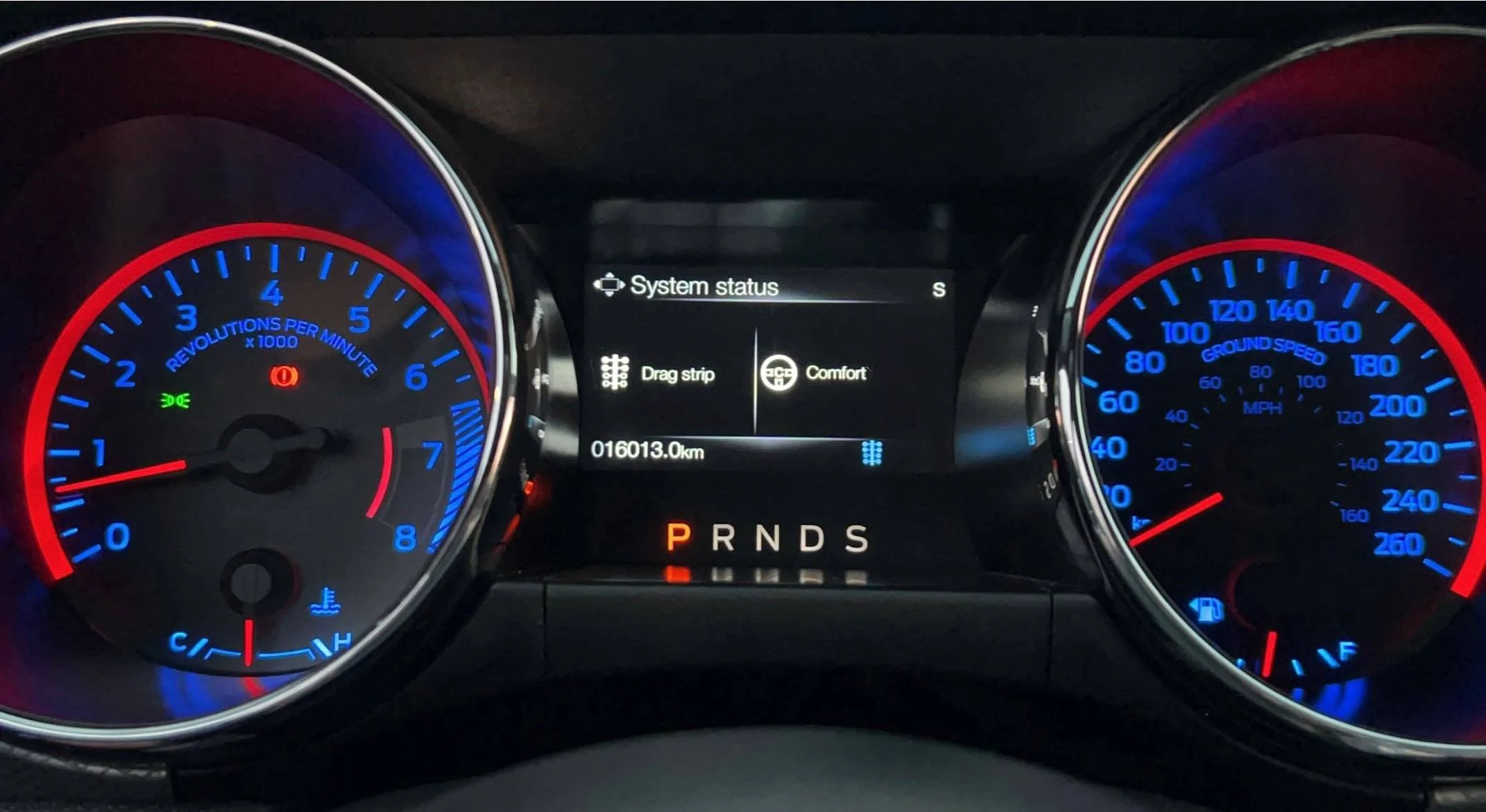

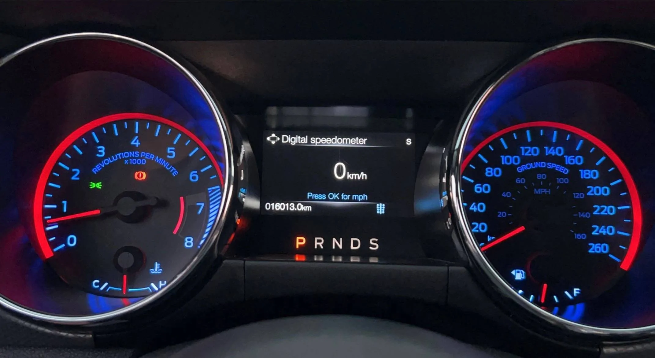

Boy oh boy look at that halo it looks pretty ain’t it? Speedometer also working. Not only this but I did found out that I now have the drag strip mood!
Now I have it in place and checked that everything is working, I just need to upload my as built IPC data which I saved from my stock cluster.

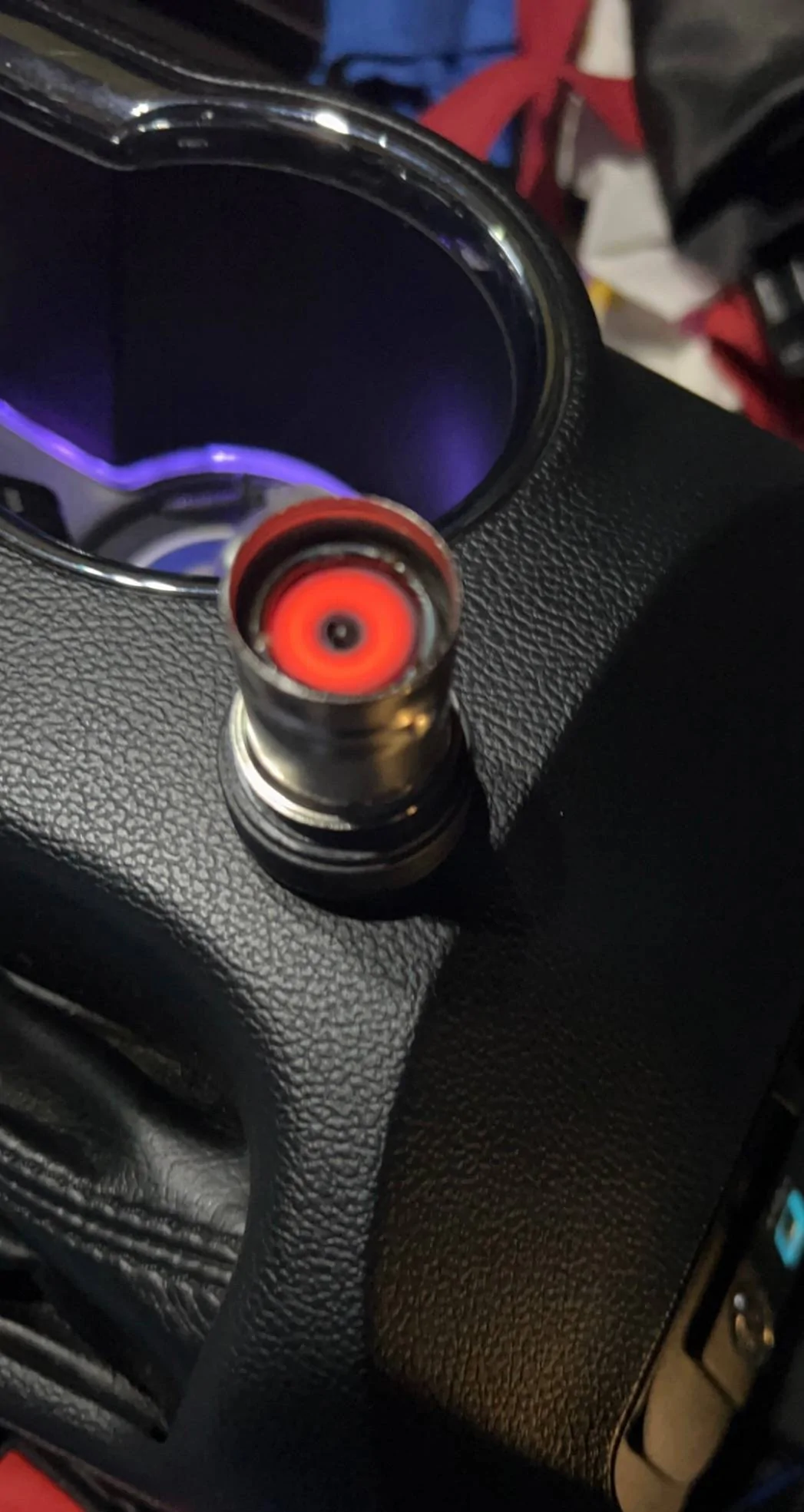

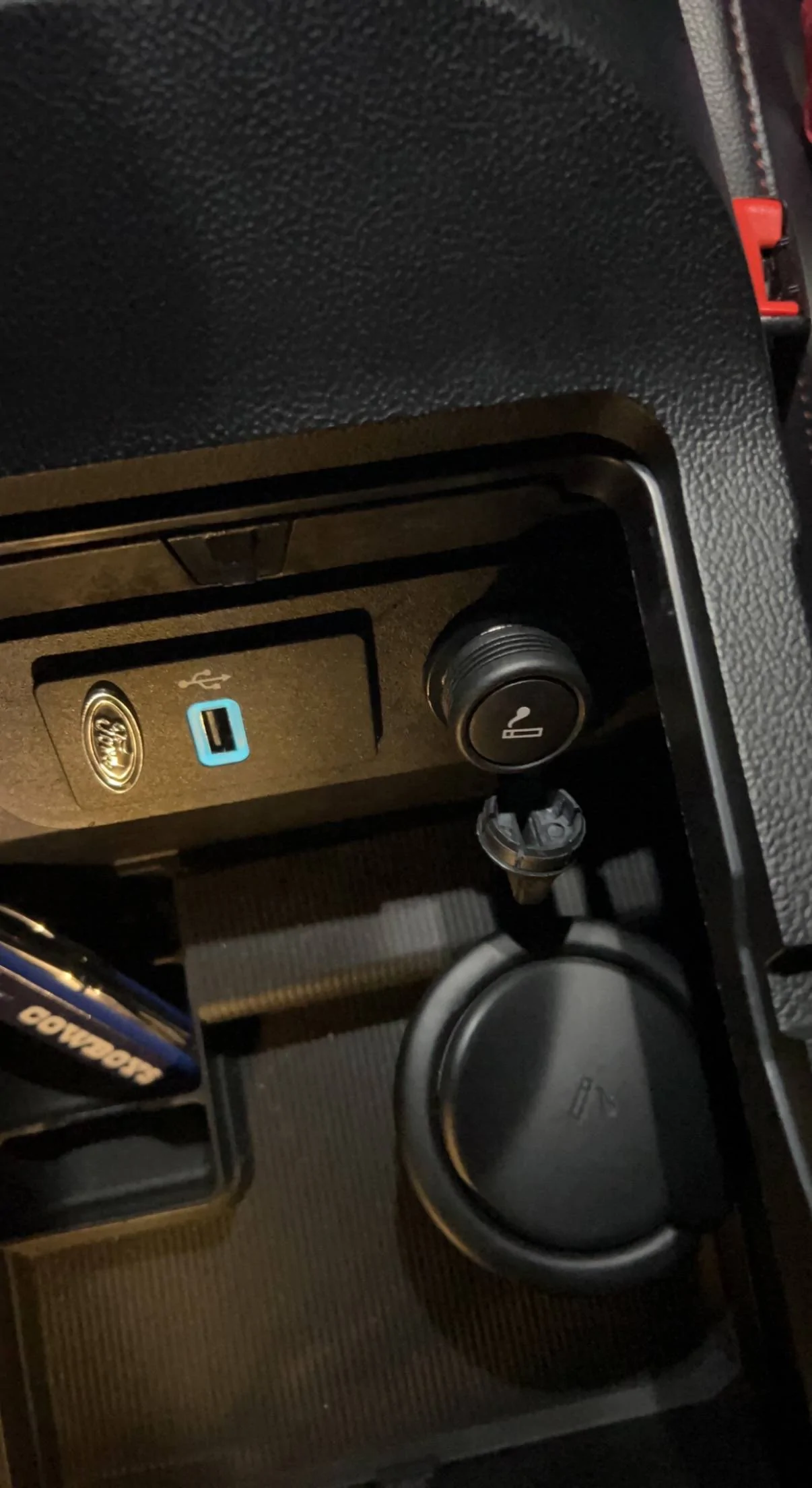

I have managed to install a cigarette lighter on my arm rest console. You’ll need to buy a specific part in order get the lighter knob working. It was fairly easy just plug and play. It comes as a set and the part number is XC3Z-15055-AA.

Boy oh boy look at that halo it looks pretty ain’t it? Speedometer also working. Not only this but I did found out that I now have the drag strip mood! And it’s working.
Other than seeing it display the Drag icon, what makes you think it's working? I also have a 18" analog cluster I plan on installing in my 15 but I don't see any way that any additional setttings would actually function in Drag mode since nothing would have been programmed into the rest of our car.

Why didn't you get the cluster with the raised redline?

** Unrelated topic **
I think it has been discussed before that at least the first 18+ export/KPH GT analog clusters still had 6500RPM tach faces even though the computers were programmed for 7400RPM.

I always think it’s weird to see cigarette lighters now in cars. hood job with the dash.

Regarding the drag mode, sure it shows the icon and it did not show me any error or disable message when I choose the mode. How do I know it’s working? I have no idea how it should works to be honest.
That's precisely why I absolutely love that my GT came with one as standard. 😁
I don't smoke, never have, never will, but I hate political correctness with a passion. A car that has a cigarette lighter and an ashtray in this day and age of affectation and eco smugness looks like it was made for men, not for virtue-signalling sissies. I like that. :devil:

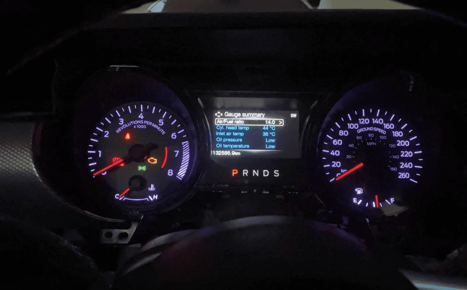

I wanted to share my experience with a cluster swap on my 2017 Mustang EcoBoost Base Automatic.
I bought a new (0 km / mile) 2018–2021 cluster (KR3T-10849-FD) for $120 and completed the swap in about 45 minutes.
Before starting, I backed up my original IPC and recorded a video of the IPC configuration table using FORScan, just to be safe.

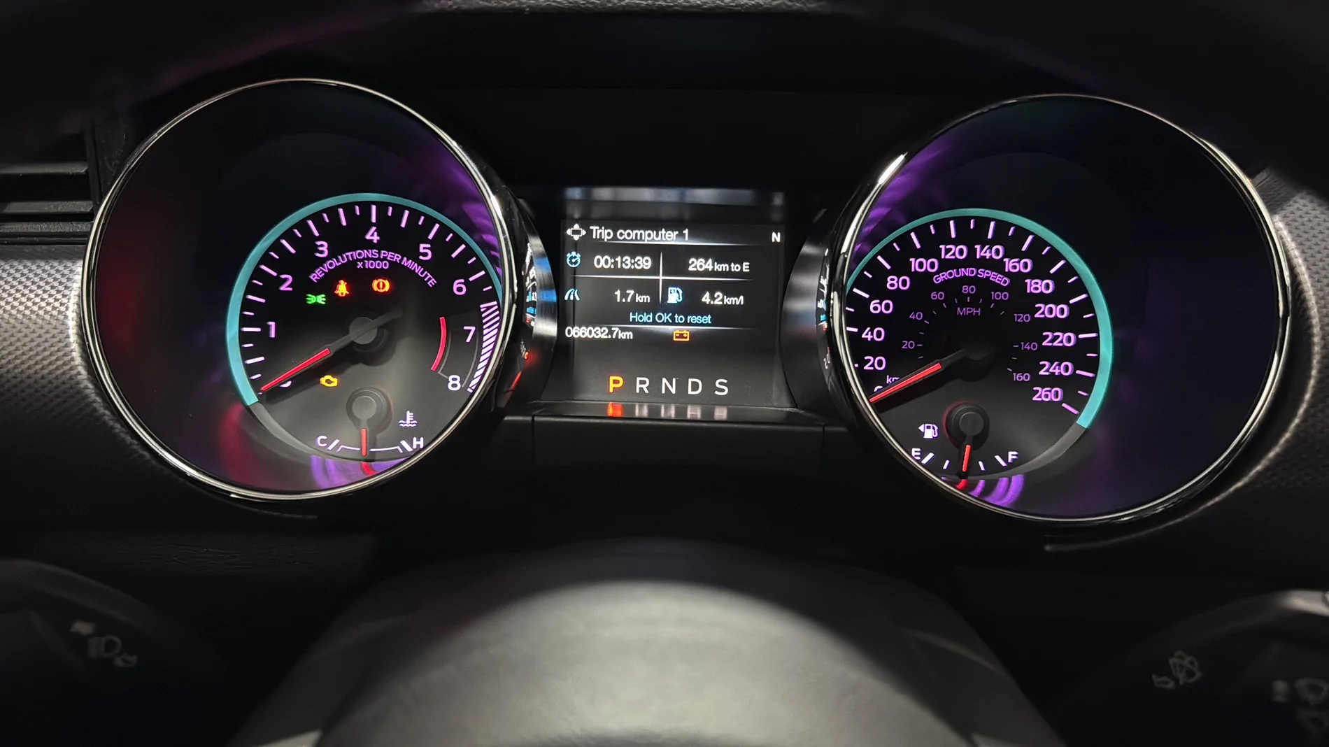

After the swap, I manually enabled and disabled the required features. Everything worked correctly except for the fuel gauge — the fuel level readings are different compared to the original cluster, as shown in the images below (before vs. after swap).
Before:
After:
I believe I may need to load the original IPC data into the new cluster to make sure the calibrations match correctly.
I’ll update this post once I try that.
