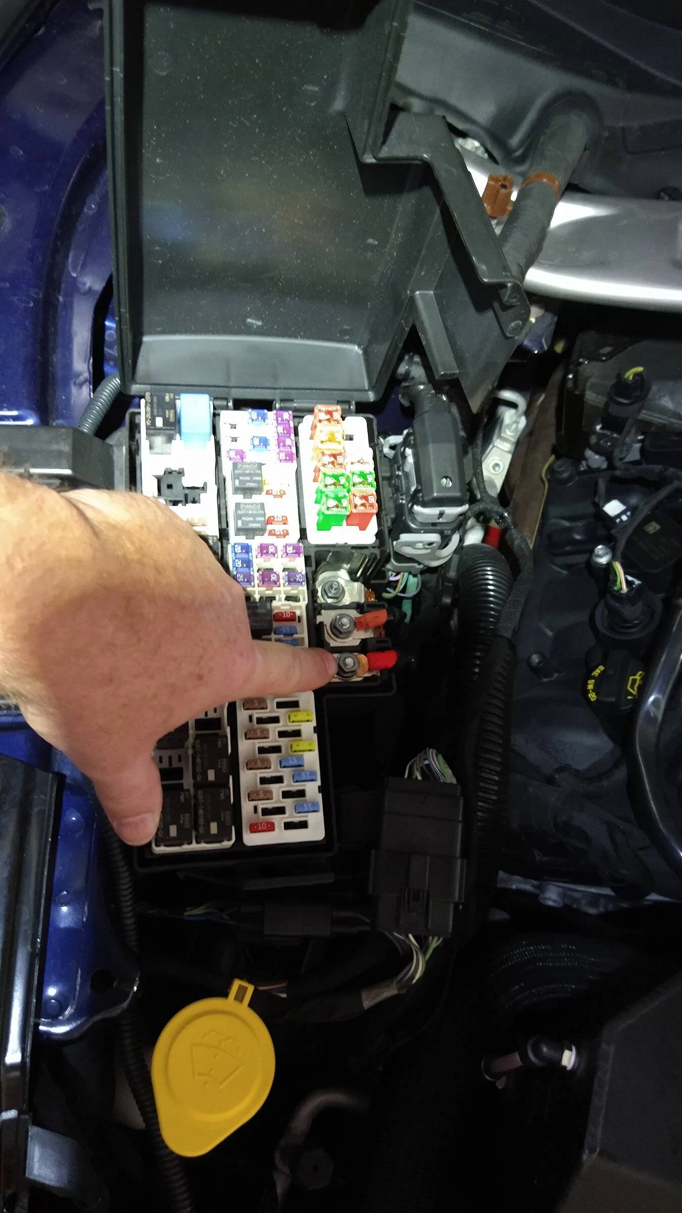

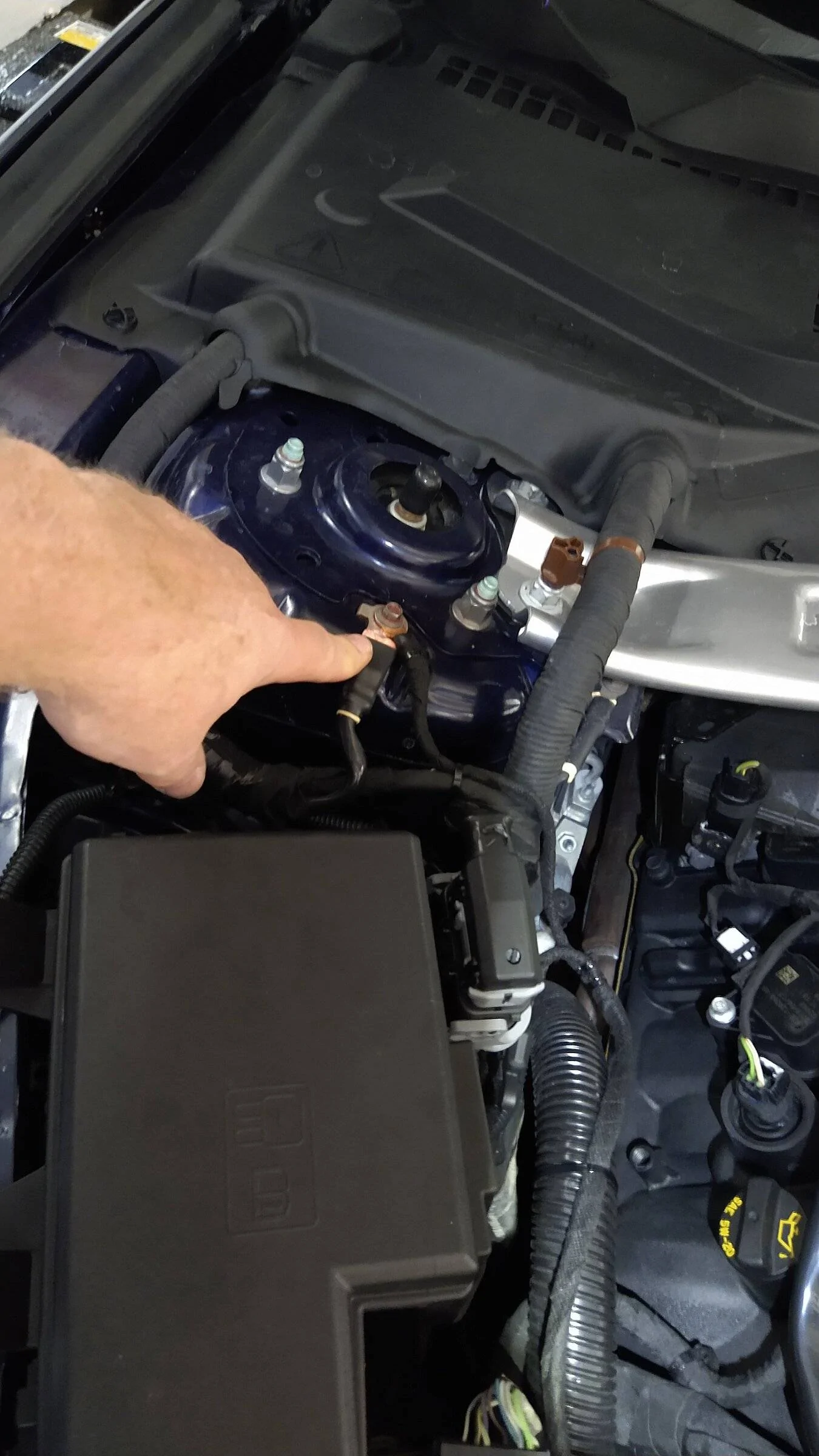

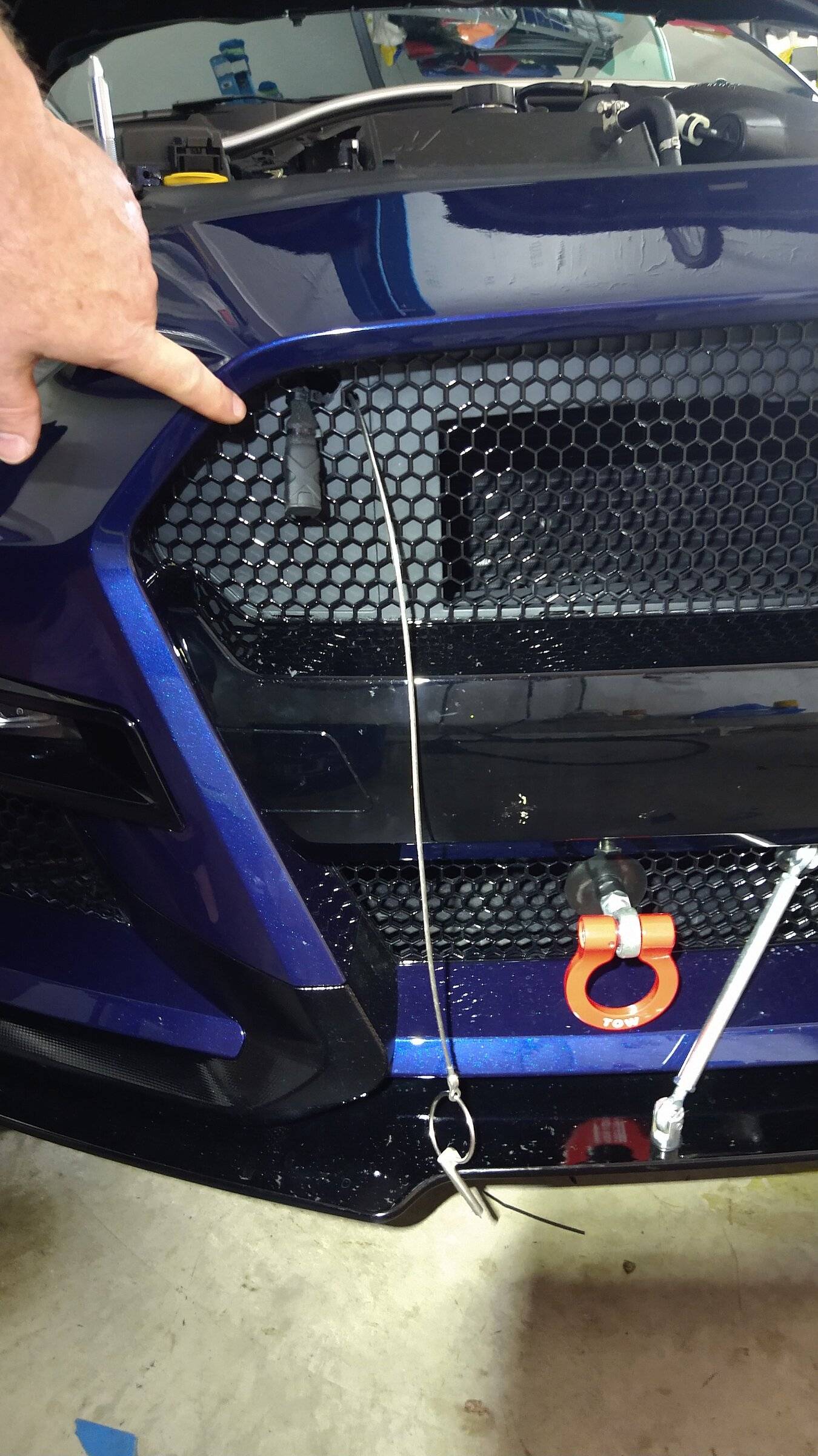

I got tired of opening the hood and remove the battery cover to charge/trickle charge my battery. So I installed a remote charging cable and mounted the external connector on my upper grill. Worked great.

The NOCO Genius 10 amp Smart charger, charges up to 10 amps when needed, refreshes battery if needed and trickle charges, maintainer if I want. I just hated opening my hood all the time.

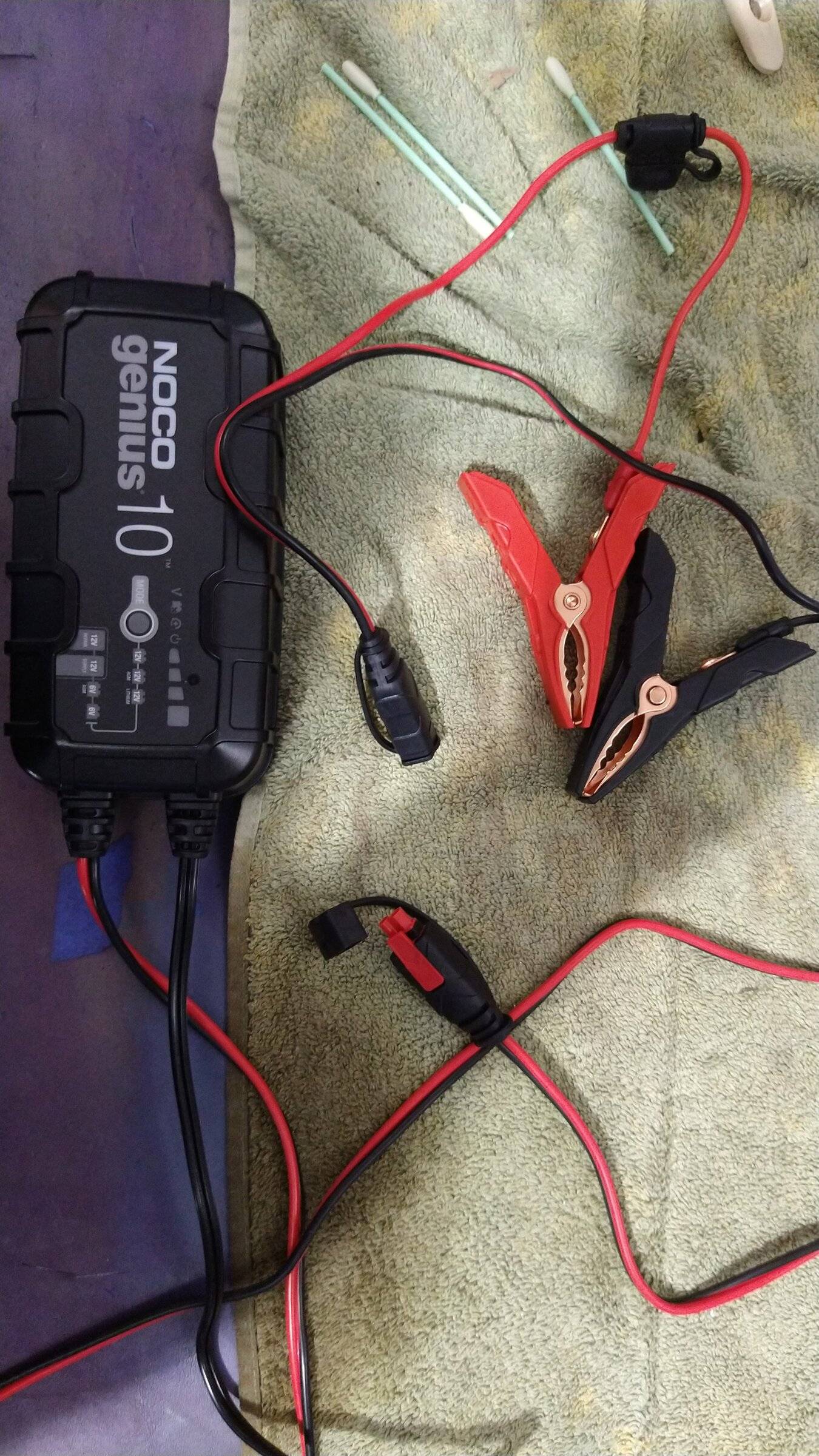

Here is a picture of the charger which has a connector to connect other cords to

Better to have it and not need it then to need it and not have it. My car sits quite a bit and when I work on the interior, the car amp draw is quite high, I think the last time I checked it was like 7-8 amps. To each his own as they say.
