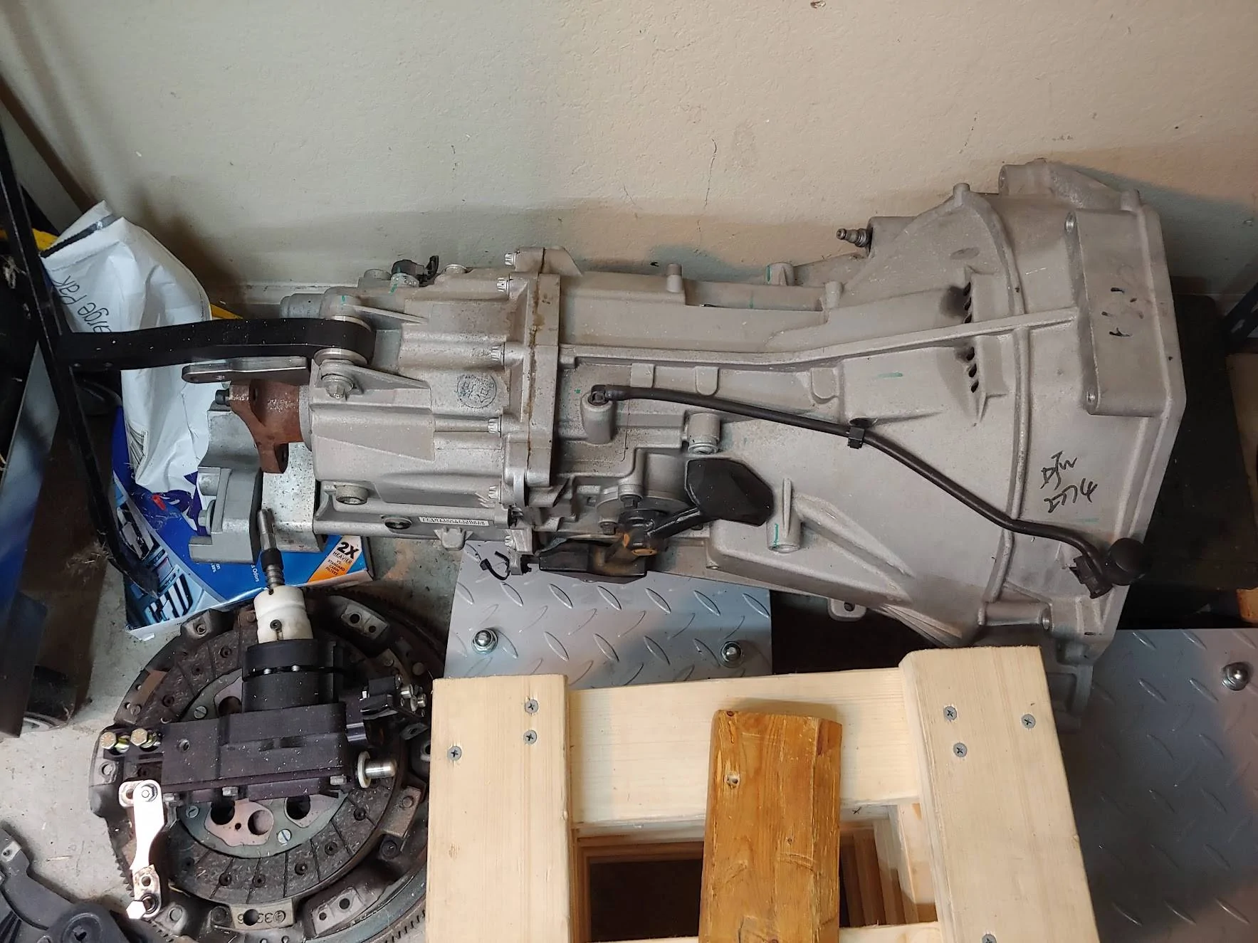

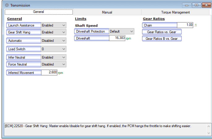

Beautiful, exactly what I wanted to hear.Run it on the original CARB Whipple tune for the emissions test if you're concerned. I have run my Magnum swap on the original whipple tune while troubleshooting a few things. Your speedo will be off, cruise control will not work and it will rev hang between shifts. The rev hang is a bit annoying, but it's totally drivable. No check engine light and the emissions monitors will all go green.
