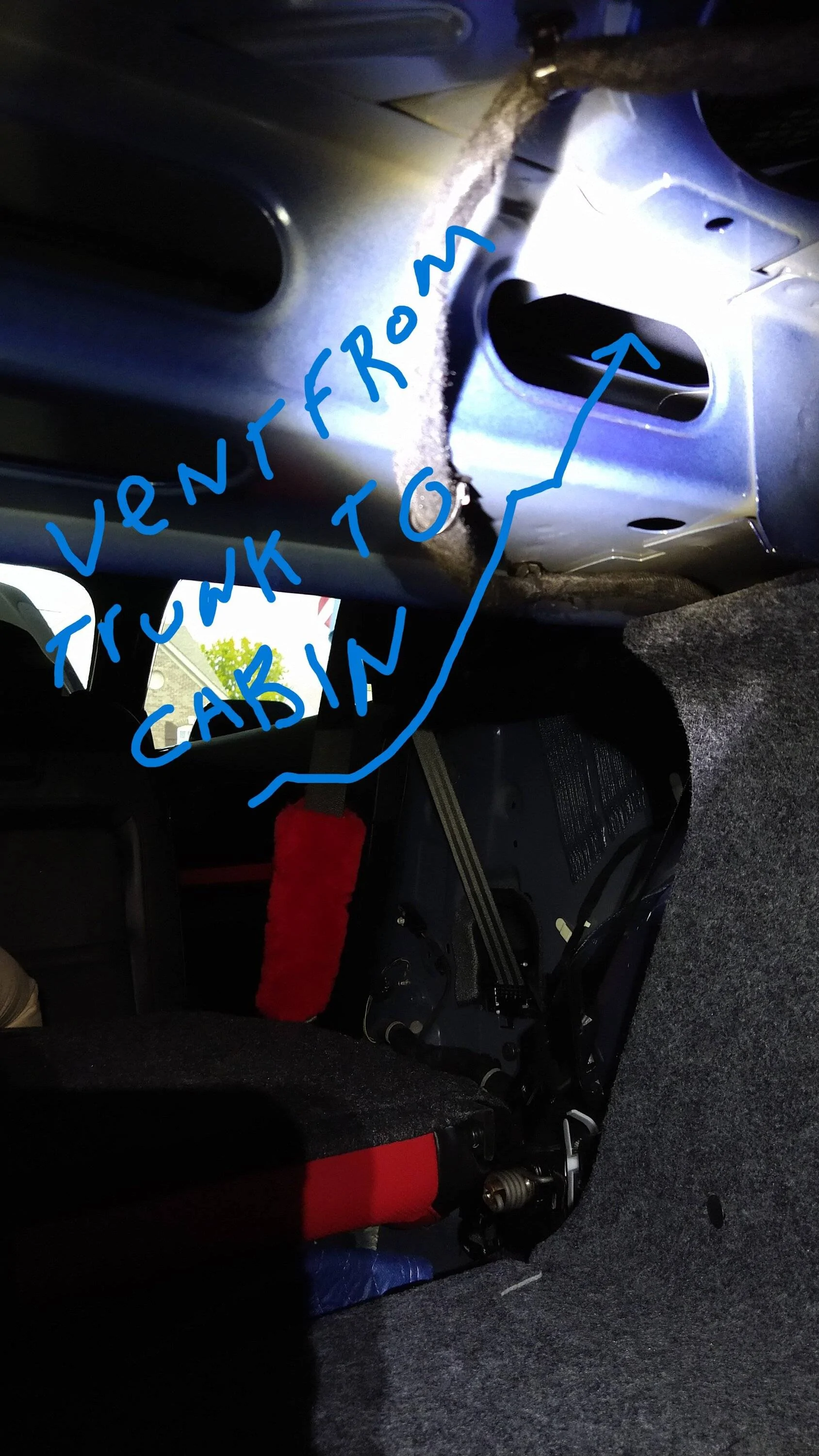

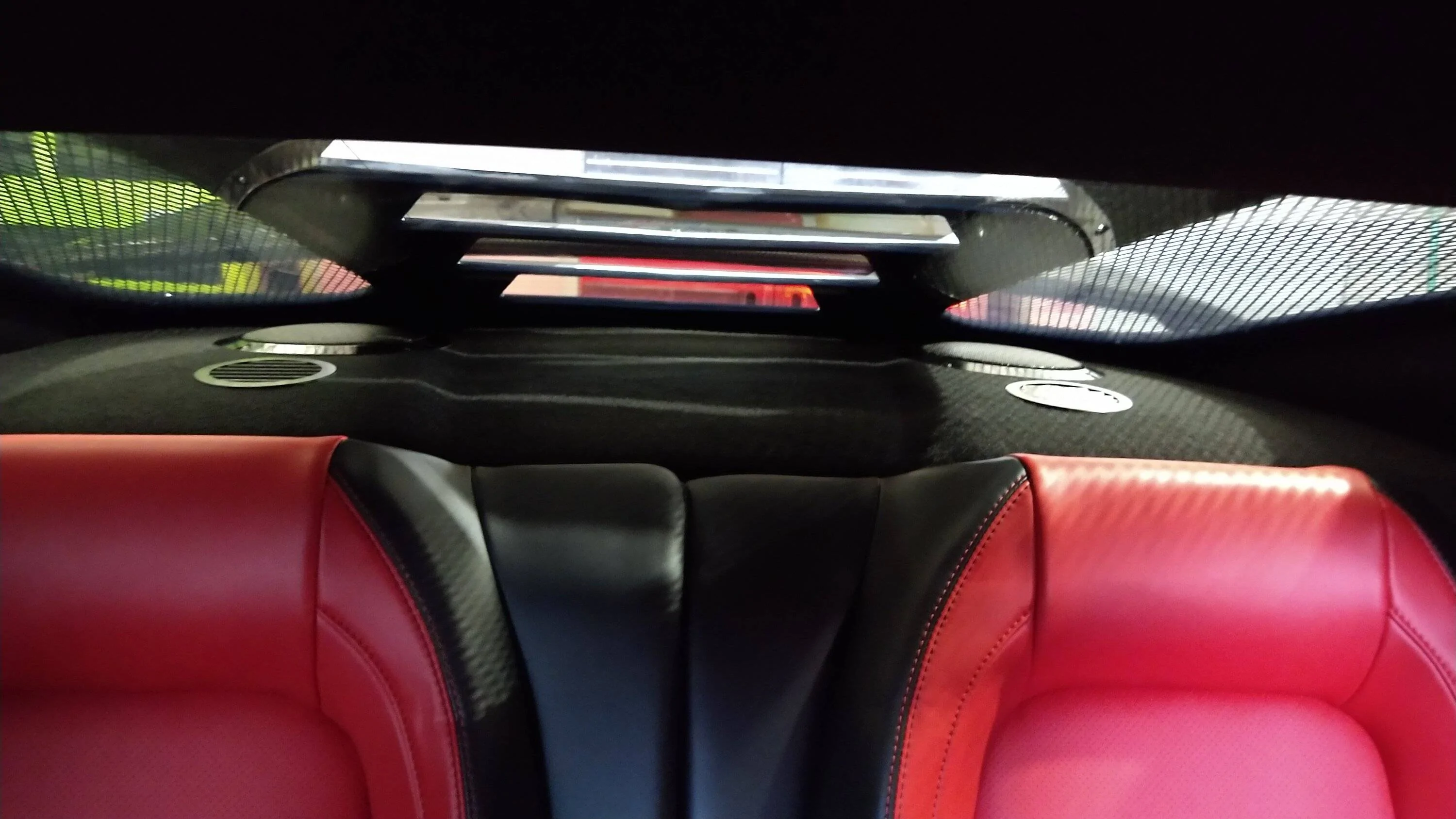

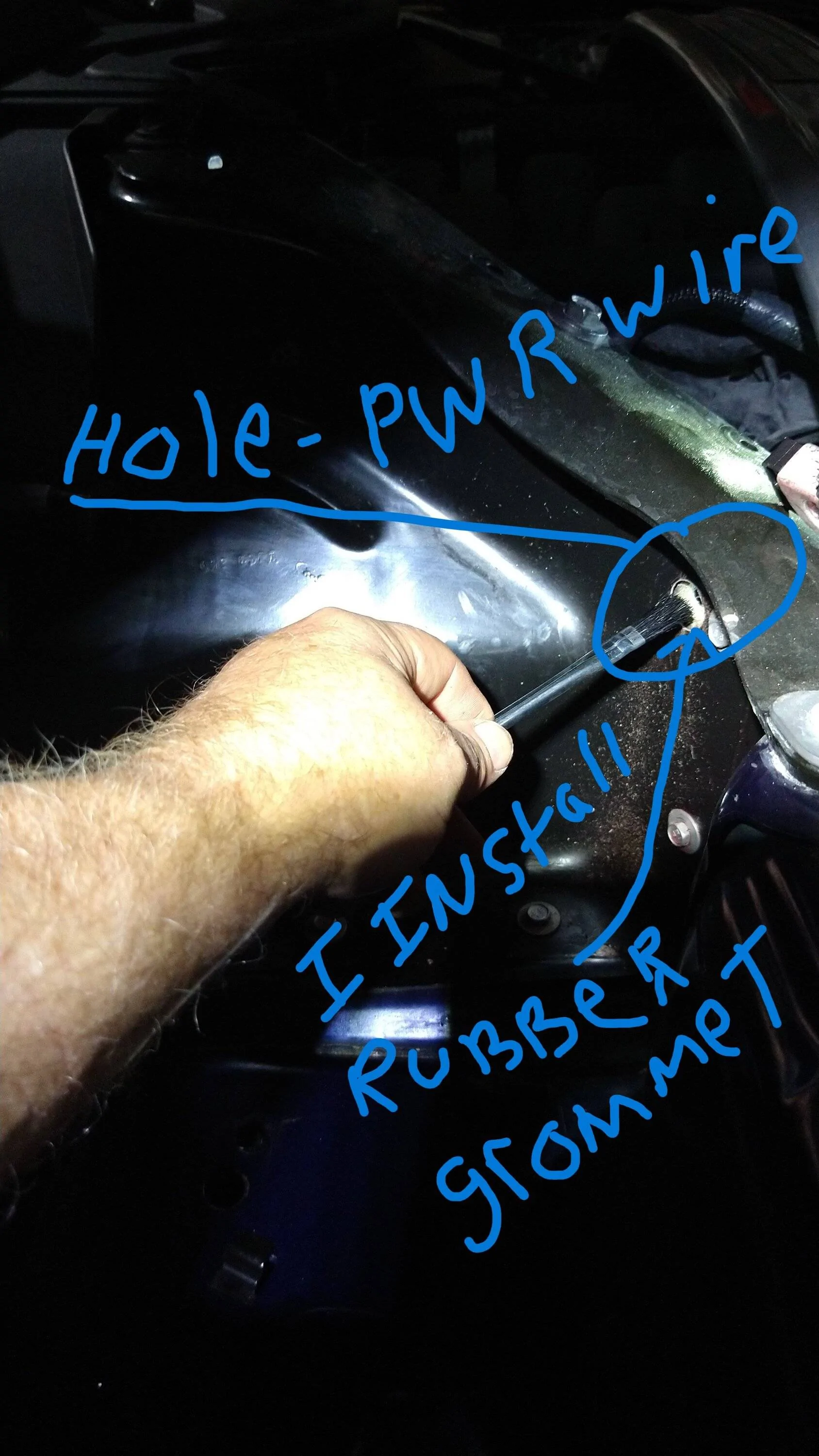

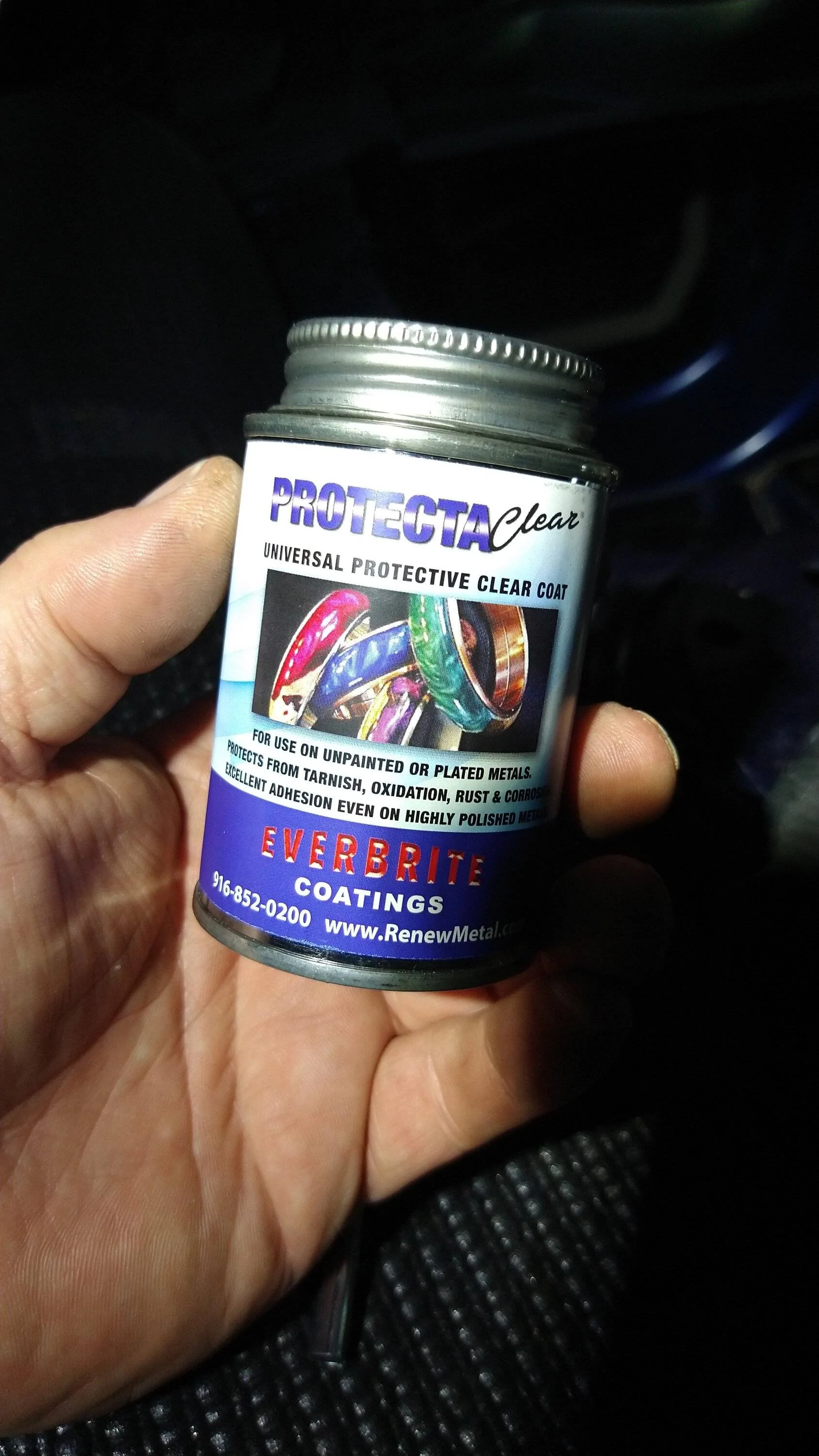

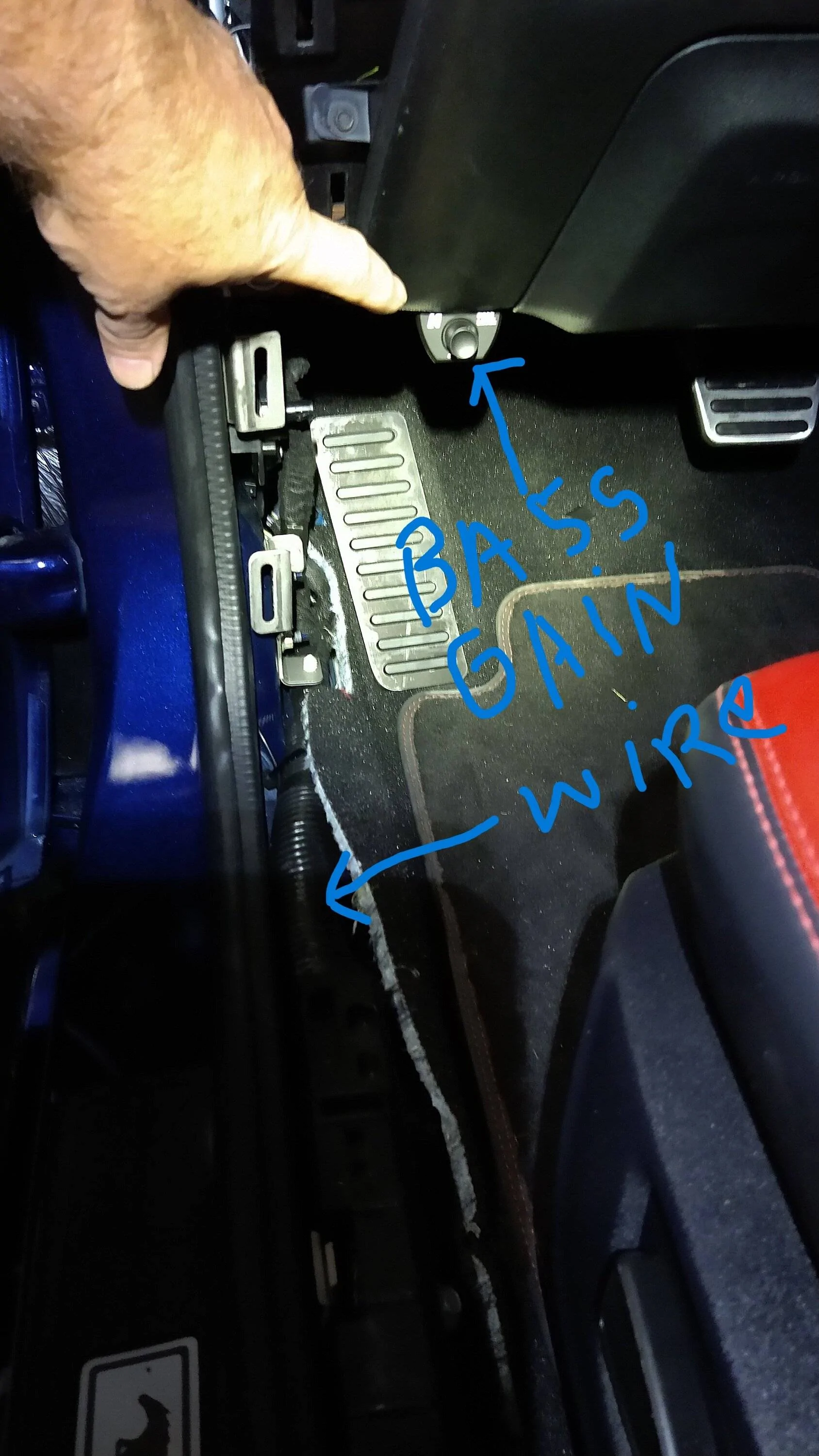

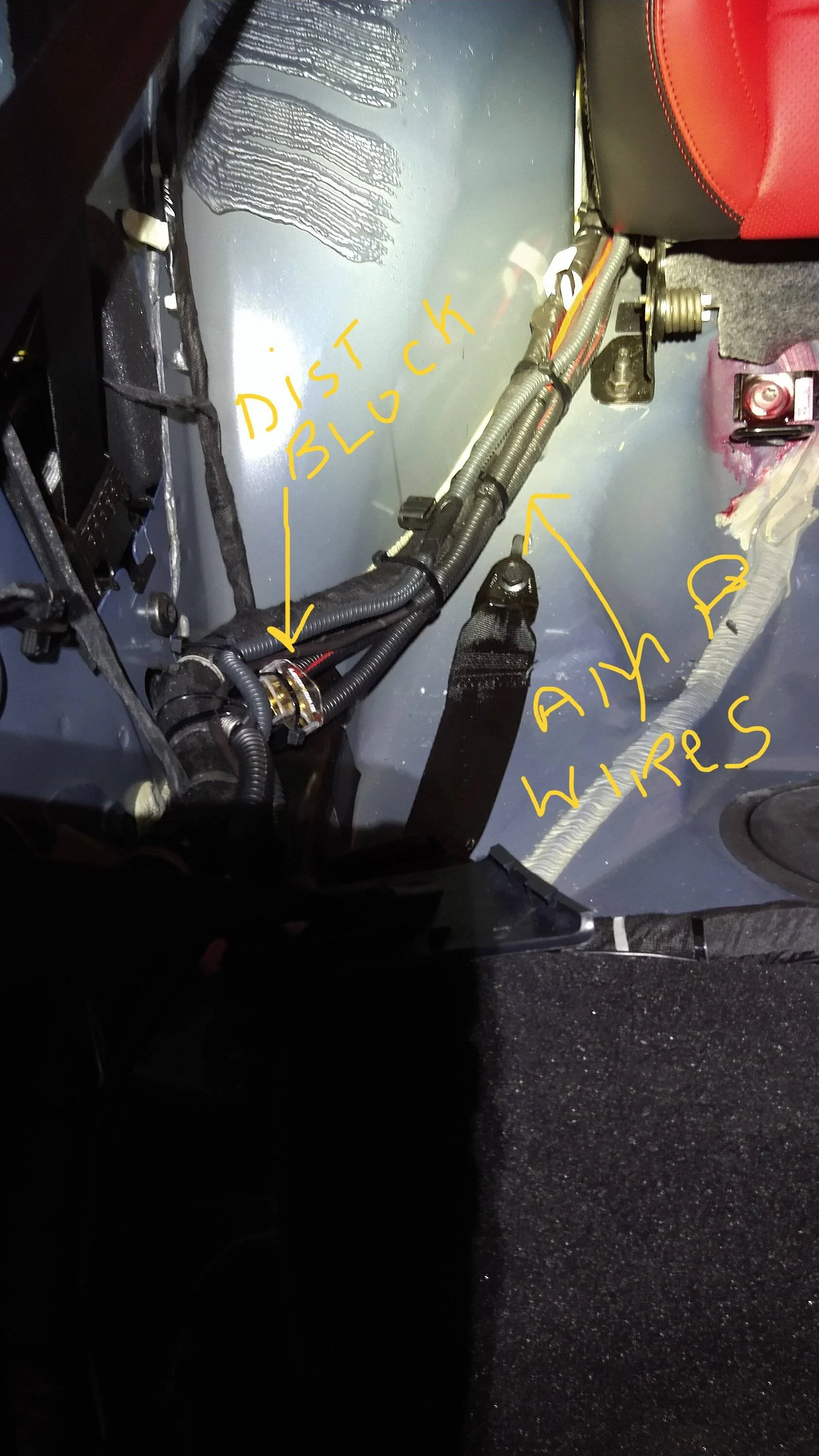

Hi. I was just asking for those that installed after market subs to get their opinions and experience as to whether our mustangs which are pretty finnicky had any issues.

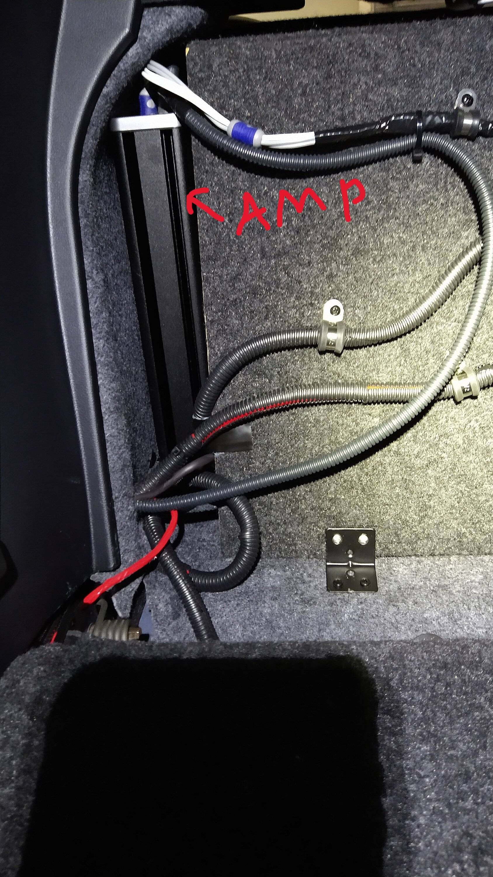

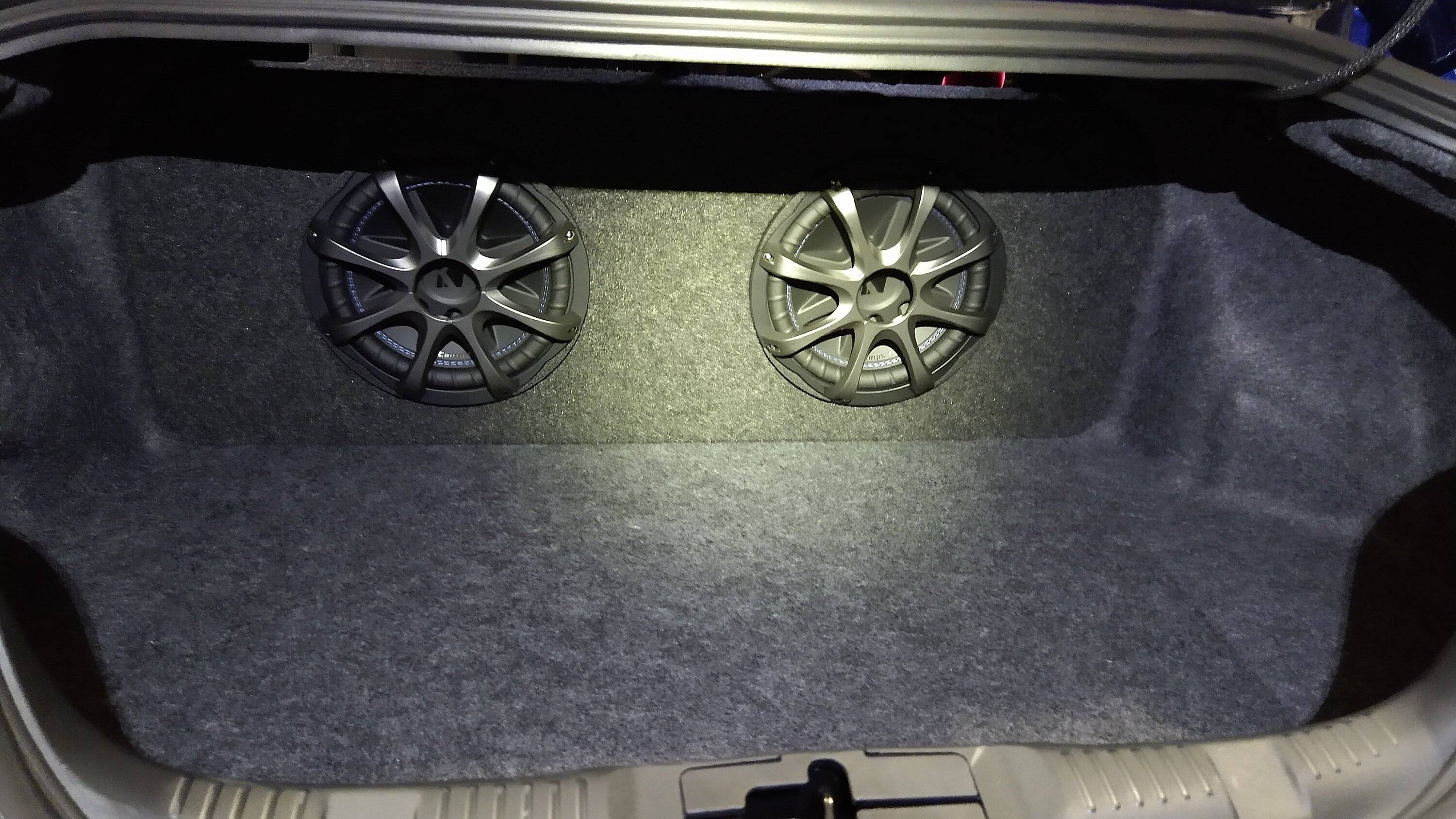

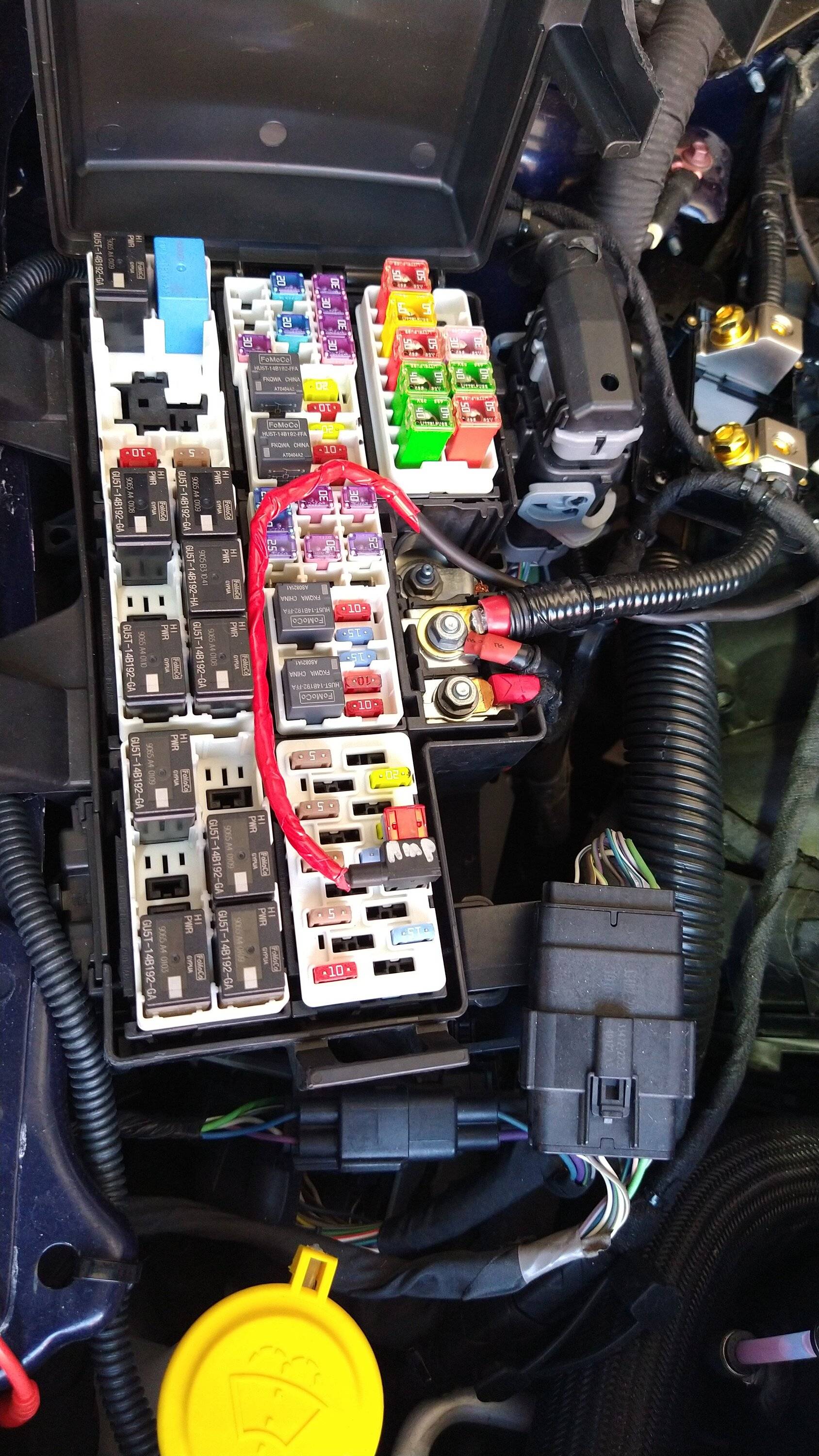

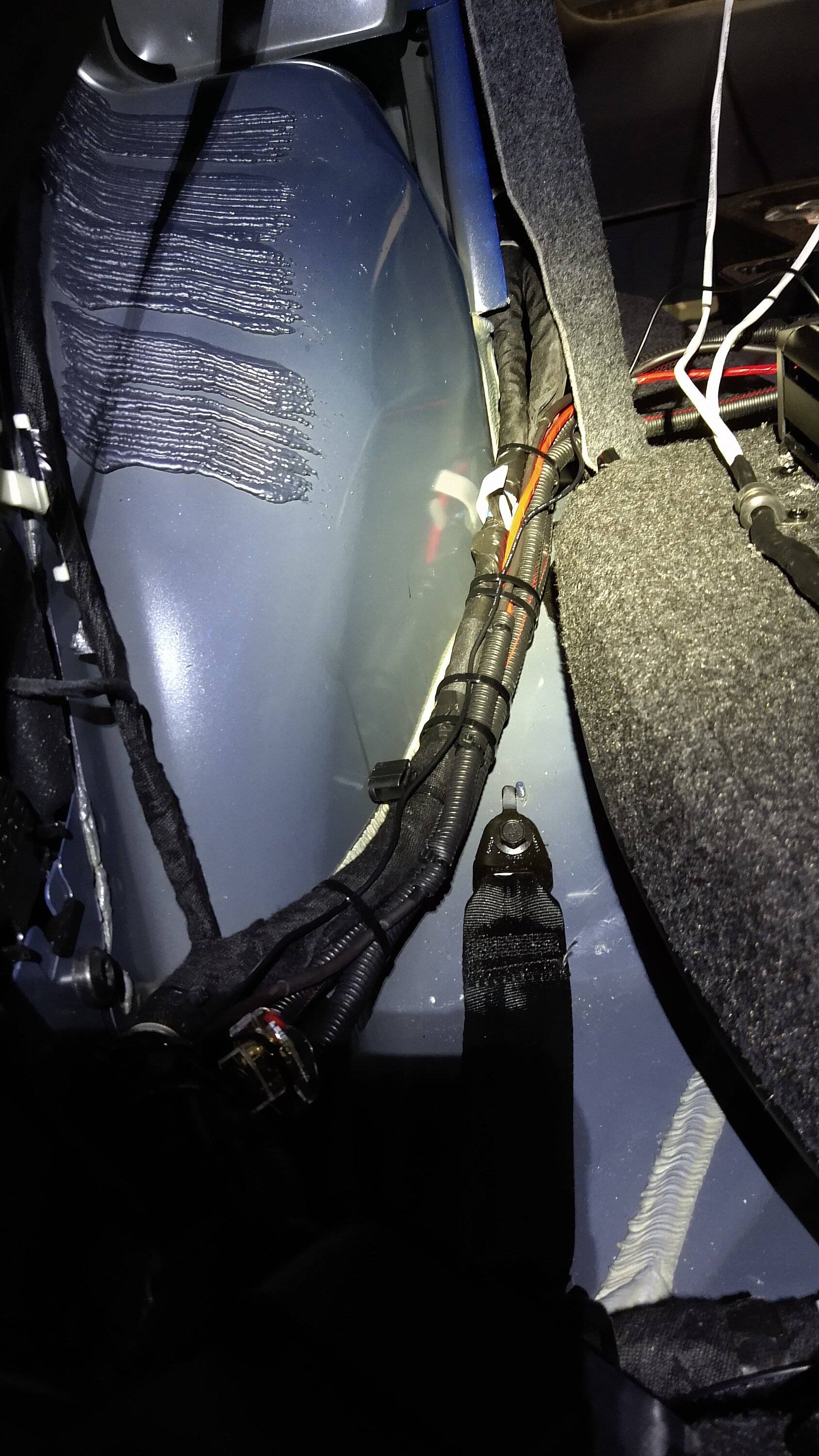

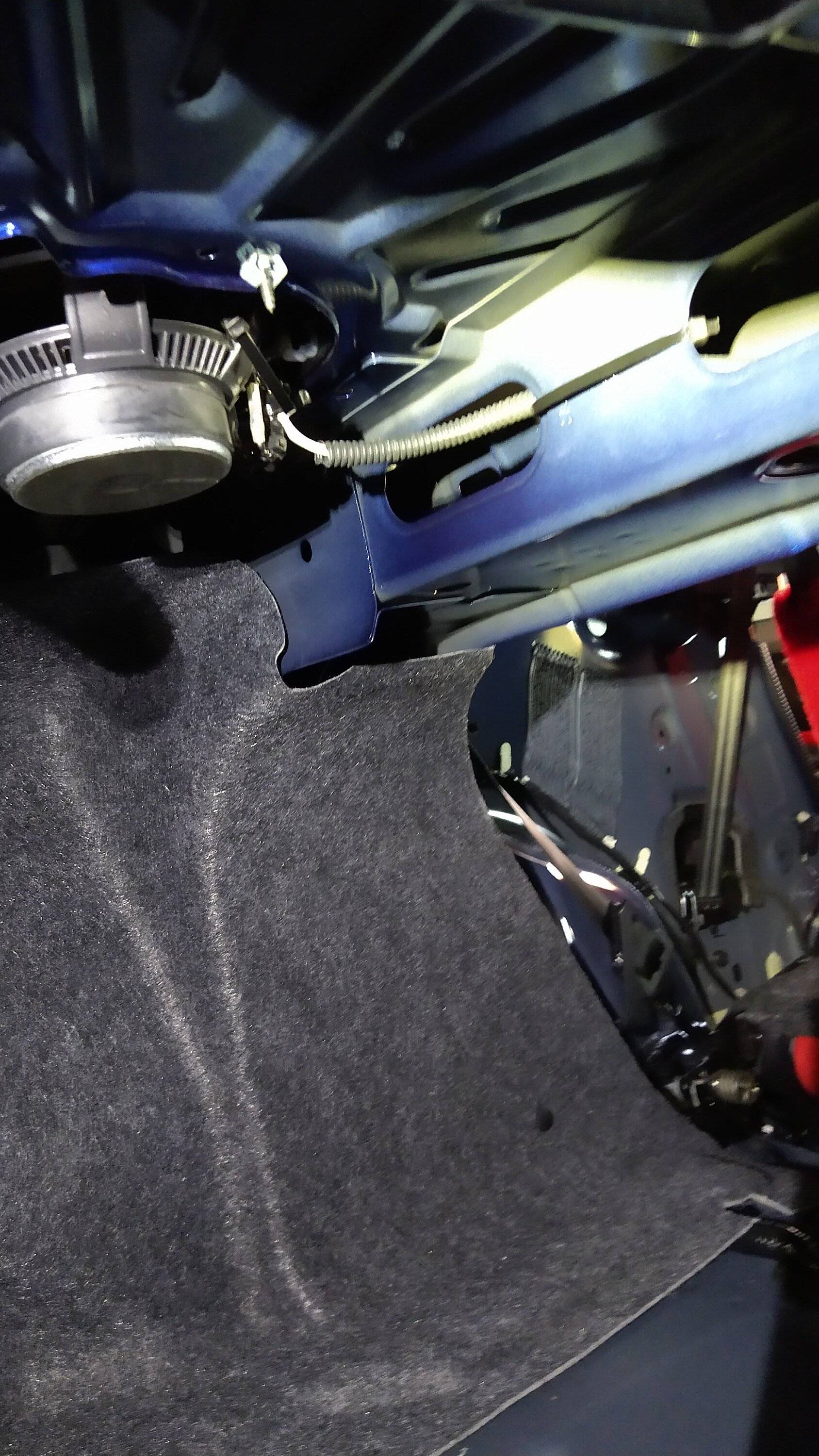

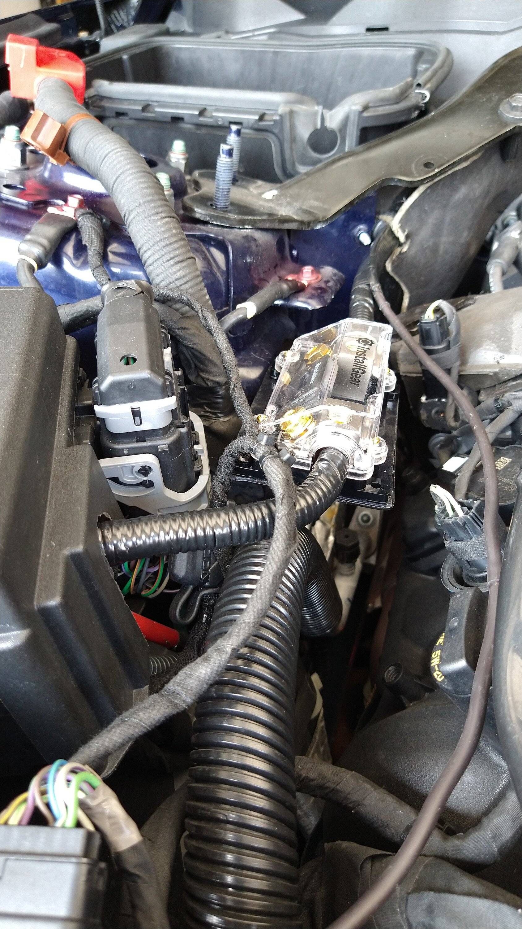

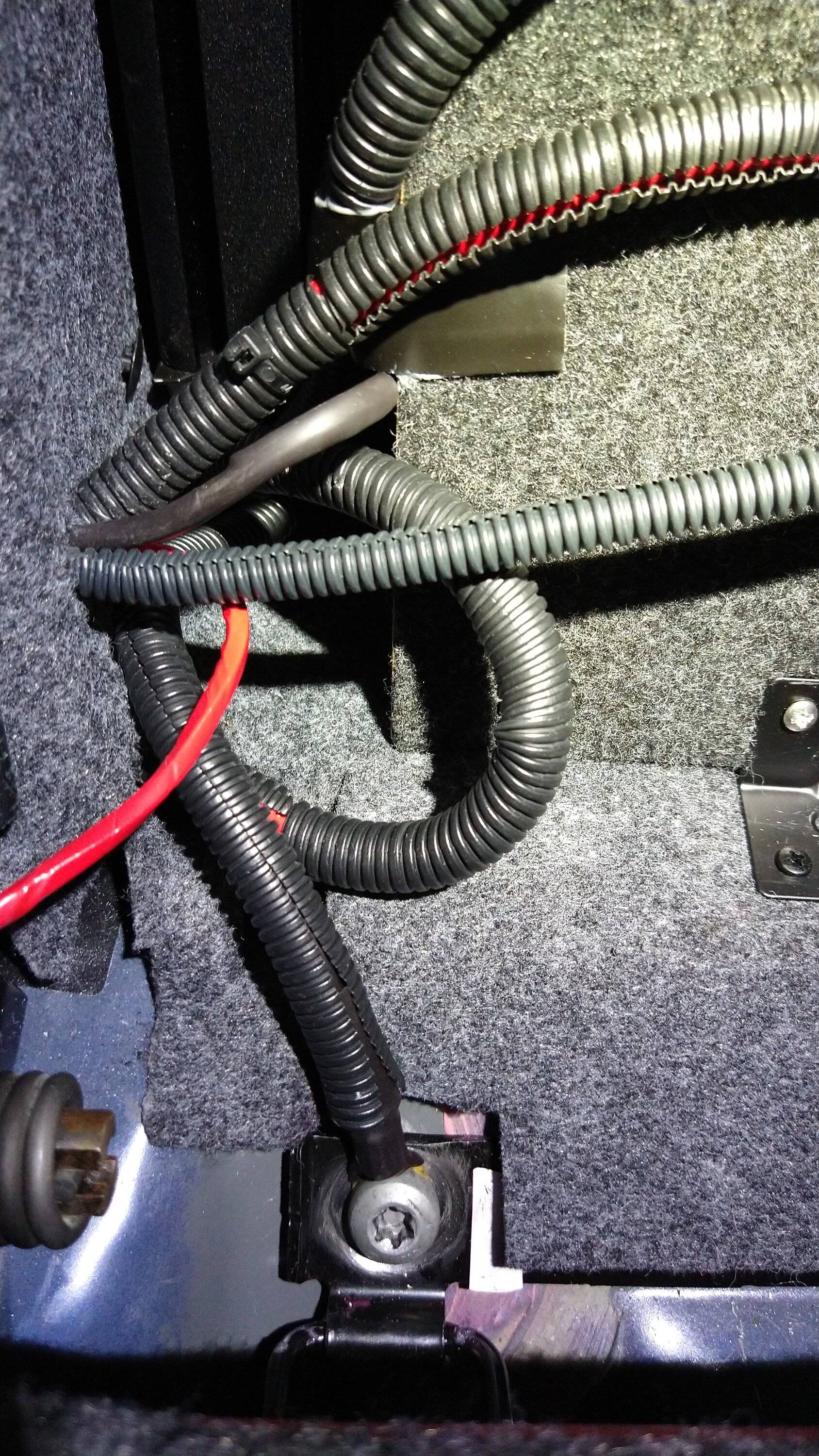

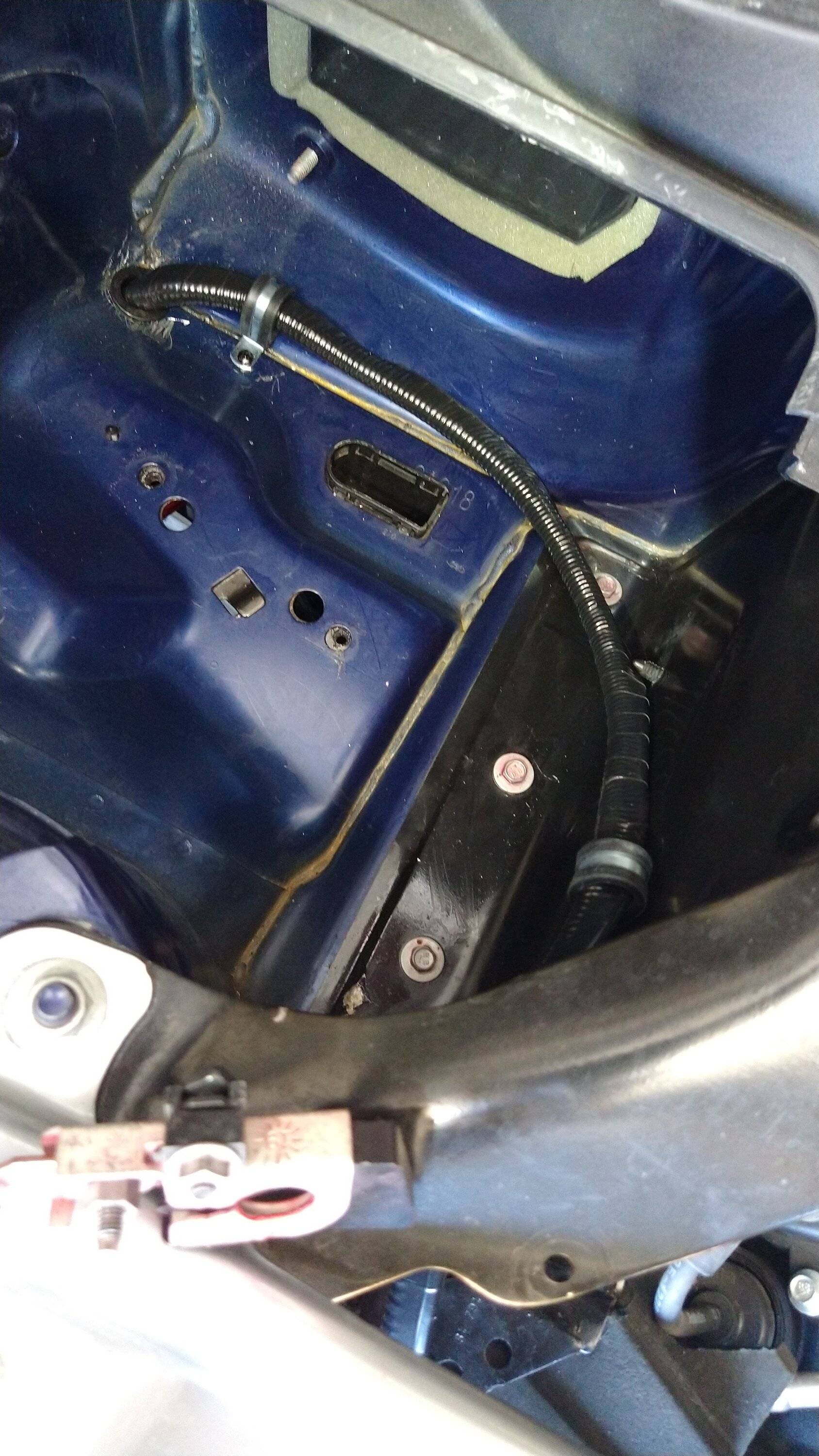

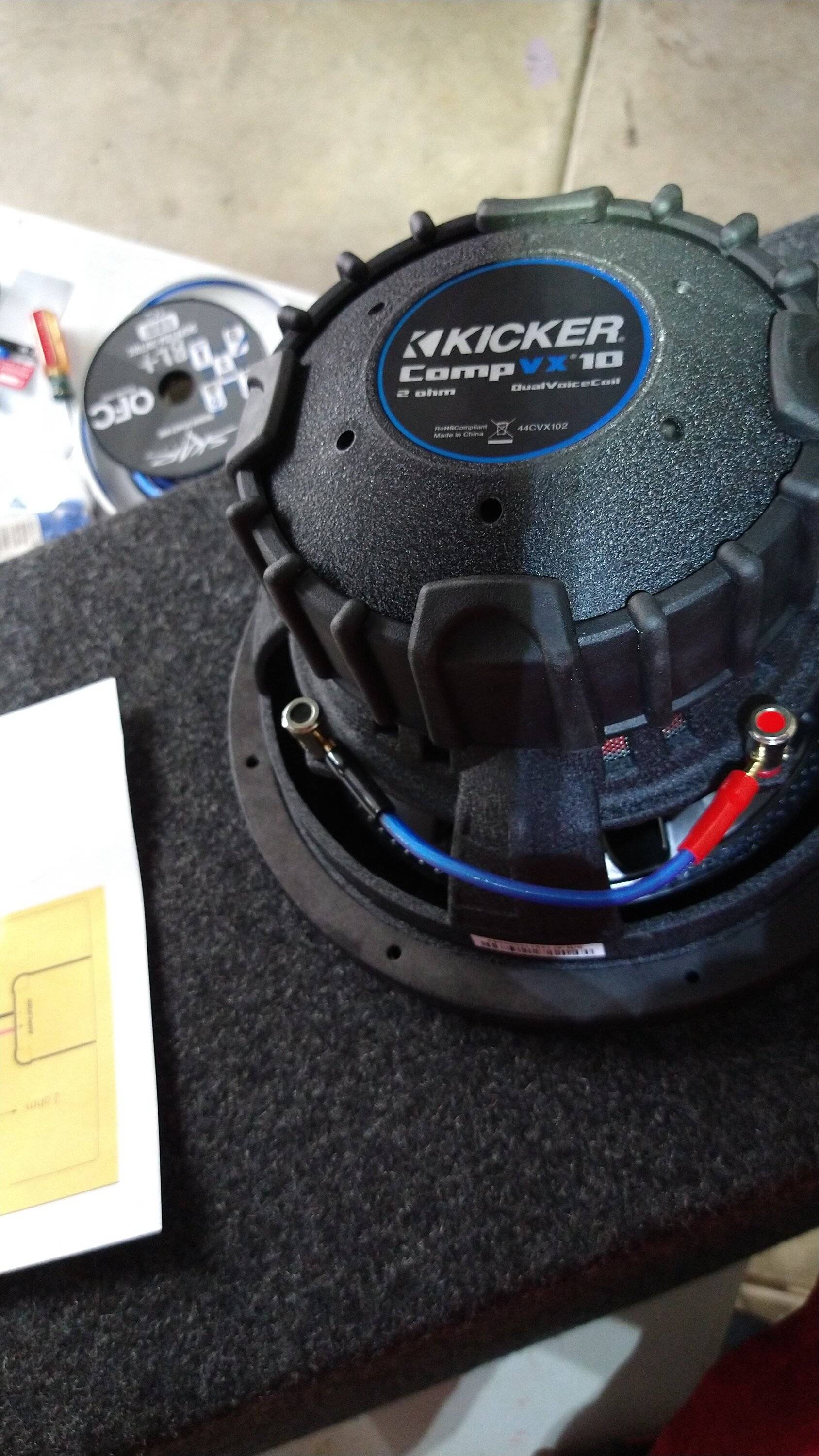

** I just finishes my Sub Enclosure and Amplifier Install
1: Custom made, Birch wood, Dual 10" Sub Enclosure (Non-Ported) .8cf per chambered
2: Two each Kicker 2ohm, CVX102 COMPVX 10" Dual Voice Coil woofers
3: Kicker CXA1200.1t, 1200 Watt Class "D" Amplifier, Variable Boost, Start Delay, Sub Sonic Filter, Bass Remote.

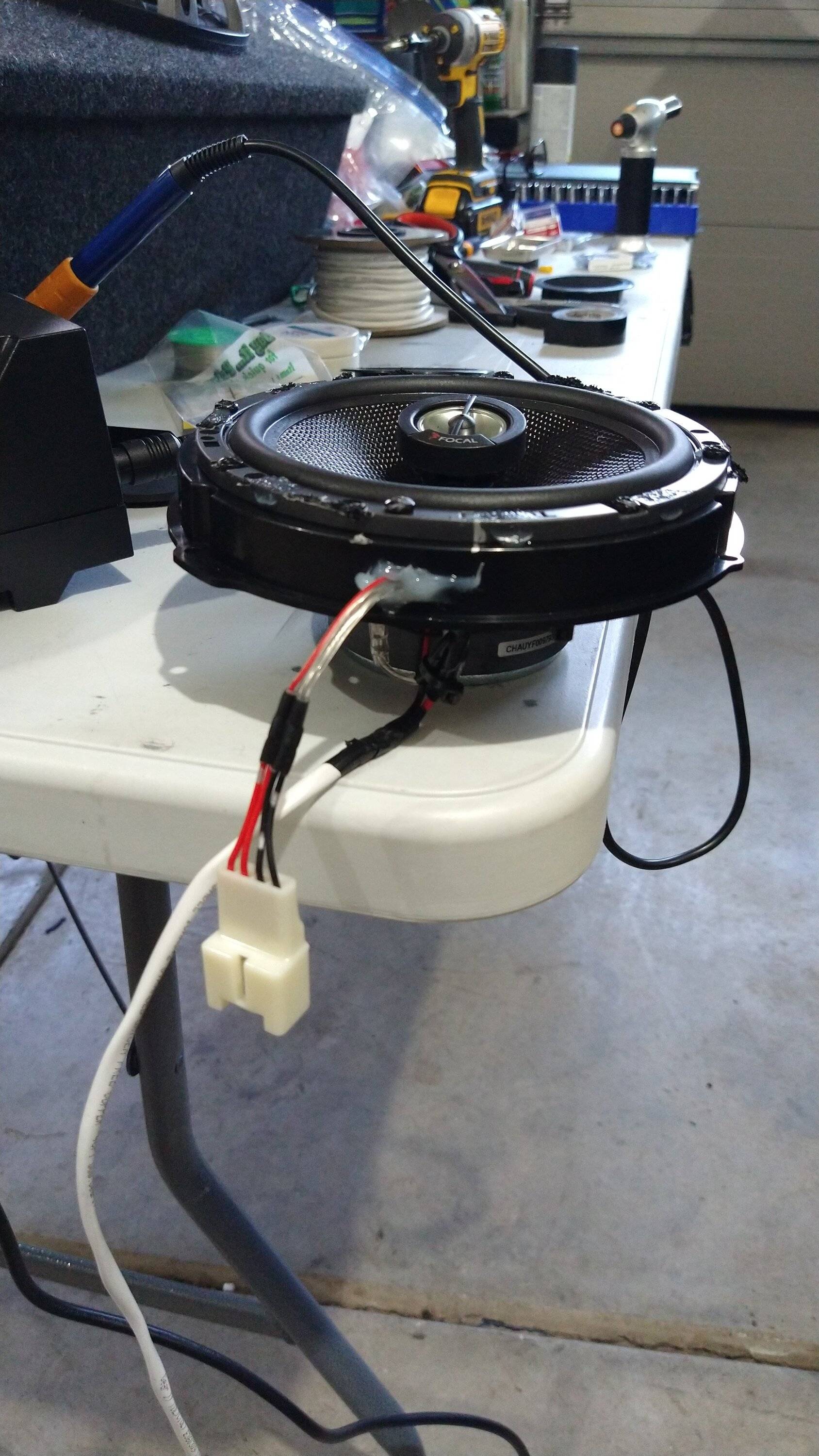

4: Two Each Focal 165CA1 SG2 6.5 rear deck speakers

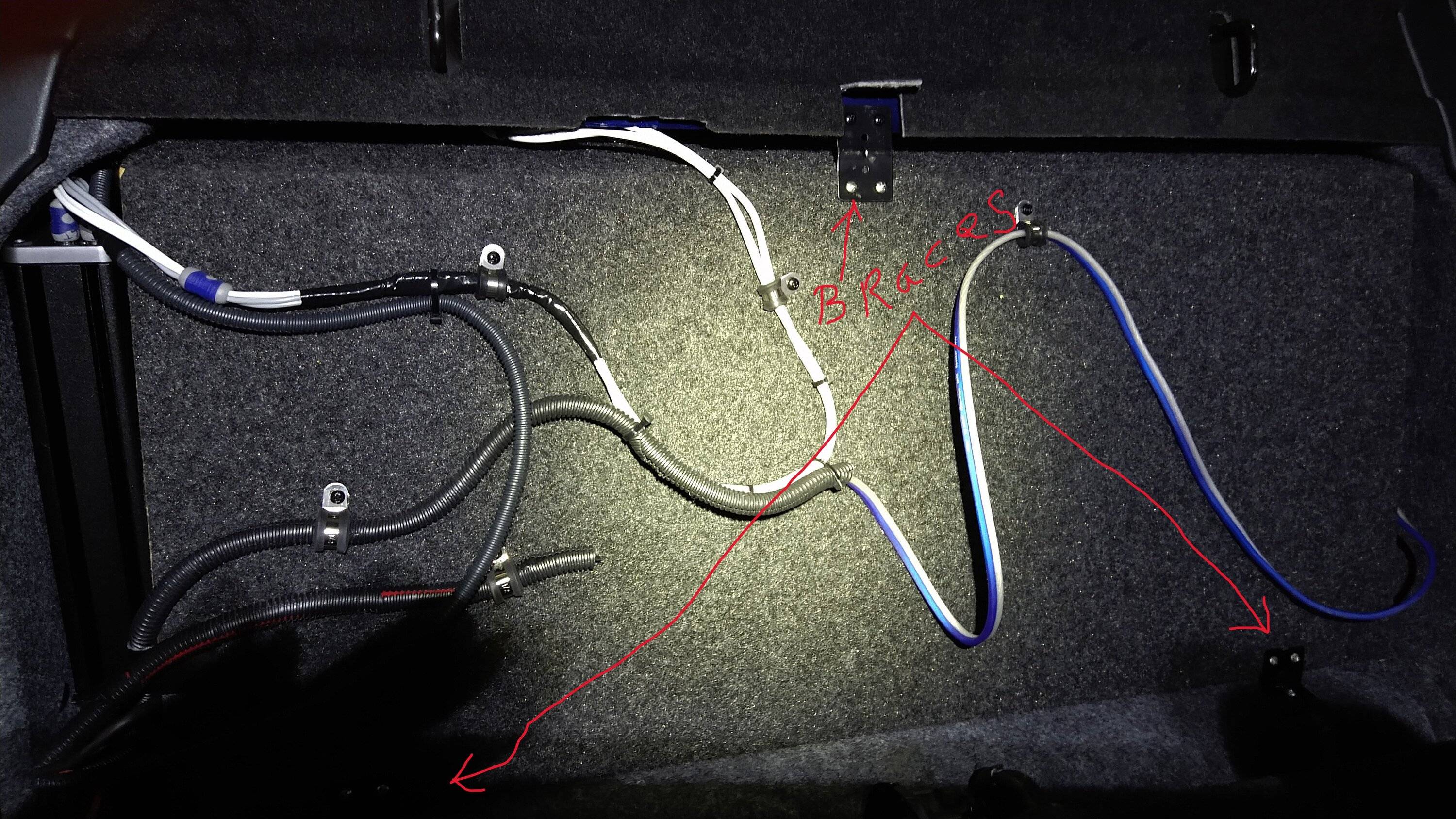

5: Installgear 4AWG, OFC, Pure Copper Power wire
6: Skar Audio, 12AWG Elite, OFC-True Spec Speaker wire
7: Installgear 0/2/4AWG Inline ANL Fuse Holder
8: GearIT 24K Flex Bannana Plugs for Sub Woofers
9: Leige Audio 0/2/4 IN, 4/8 out Copper Power wire Distribution Block.

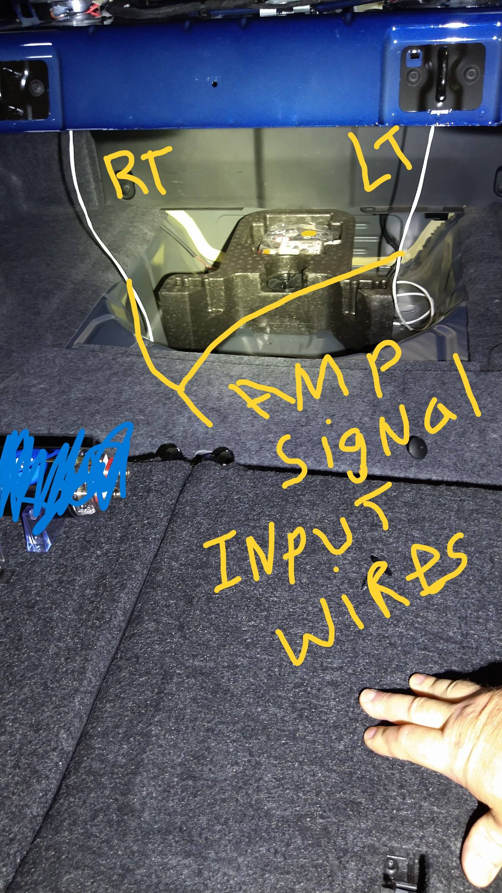

The system even the back Focals are Great. I can actually hear and adjust my rear deck speakers to even out my front and back sound. The Bass hits fast and as hard as I desire. I play mostly Old and new Rock, Classic and current country and some top 40. So I designed my system for the music I will be playing.

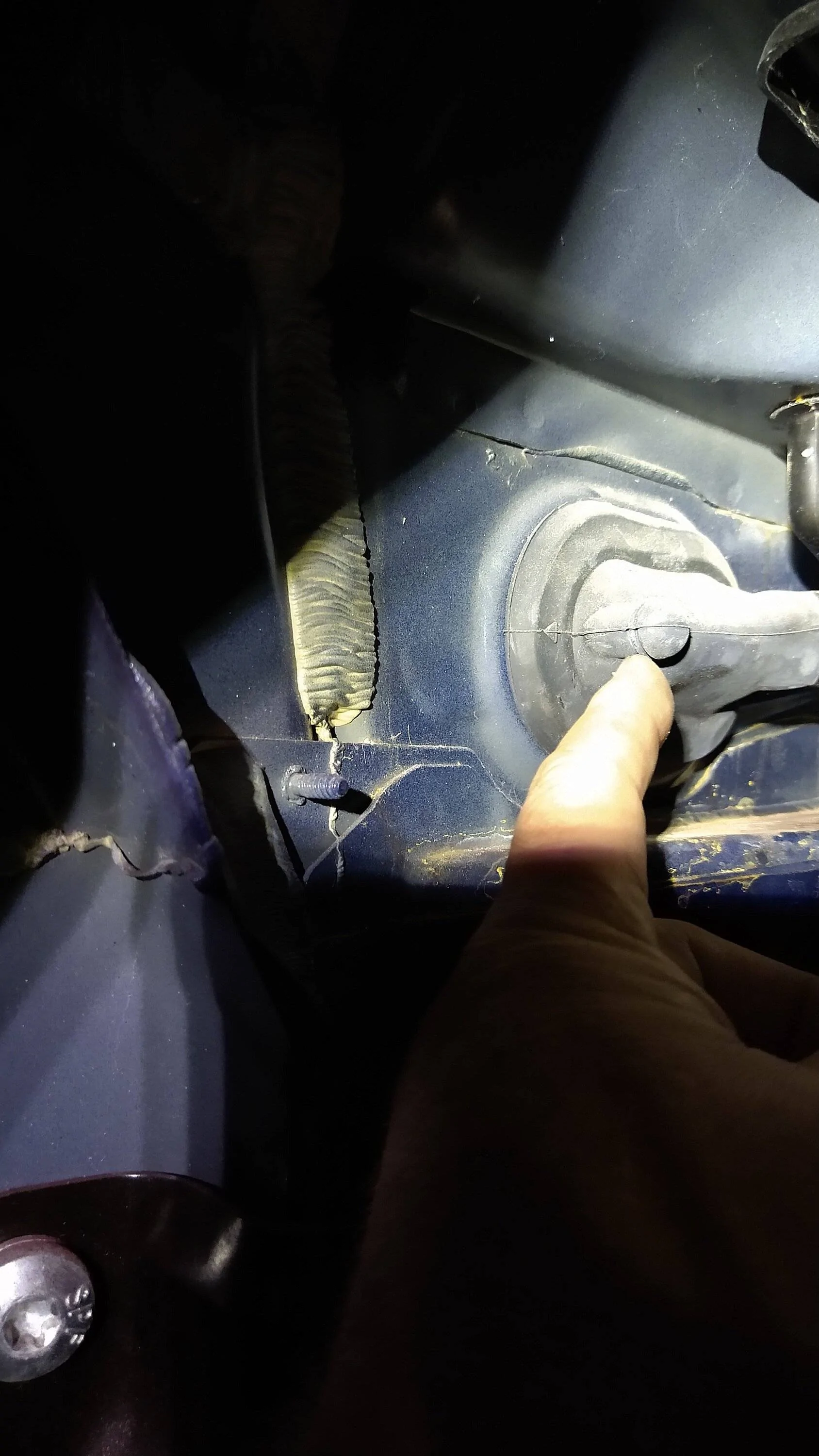

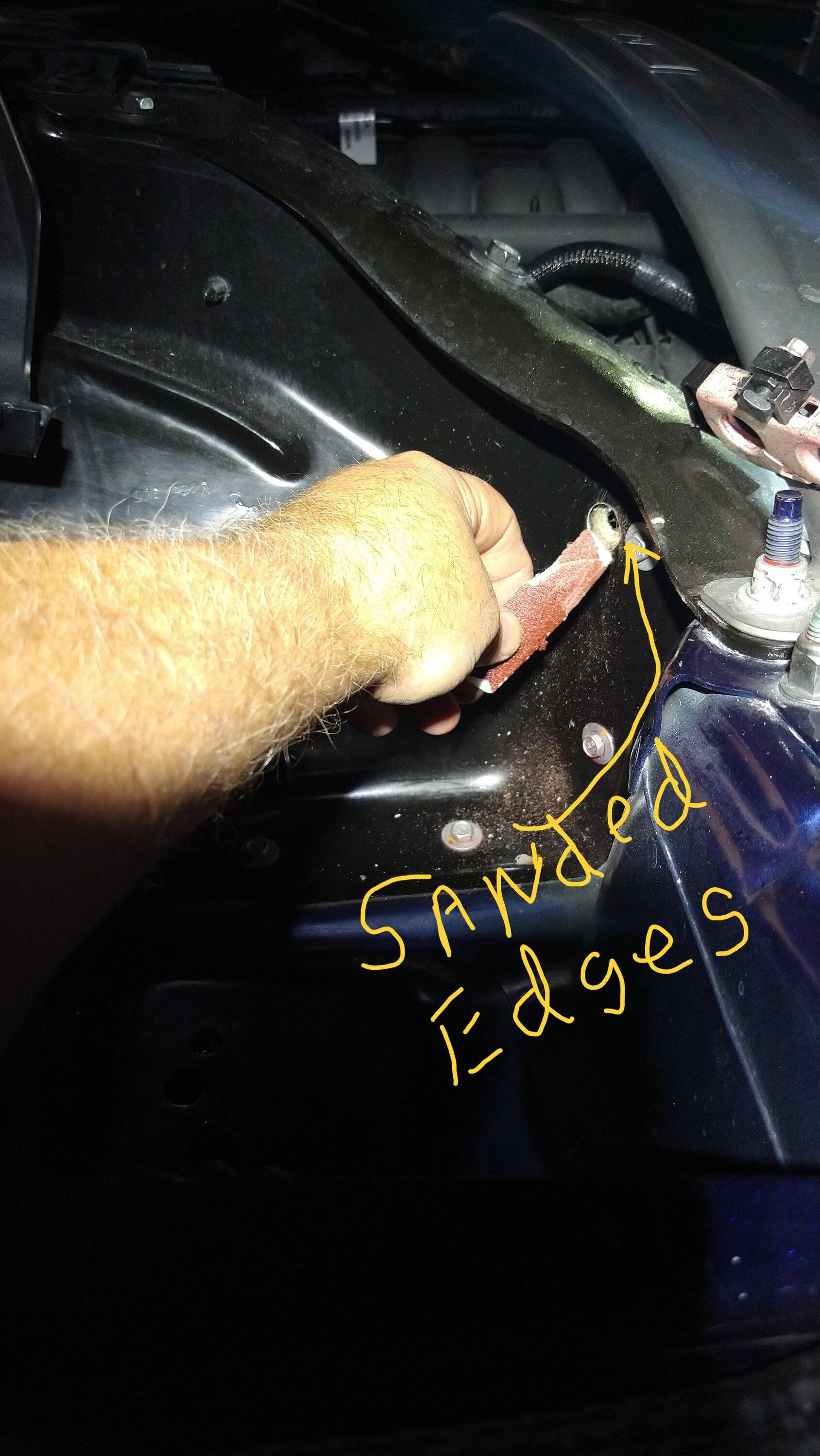

I routed the power wire through the battery box to the underside to where I could route the wire through the fire wall grommet. I secured the wire in the battery box with Adel clamps. I used Grommets on both holes I made in the battery box area and treated "ALL" Bare metal with a Anti-Rust, Anti-Corrosion treatment application. All wire are hidden, secured, protected within the system. The Amp I mounted to the Pass side of my Sub Enclosure. The AMP ground is less than 12".

This was challenging to say the least. I installed to where I would have a clean, usable trunk and everything hidden. But, I will say. Putting the speaker grills in and new speakers I can actually hear good quality sound from them. Before, nothing. But, this did add weight.

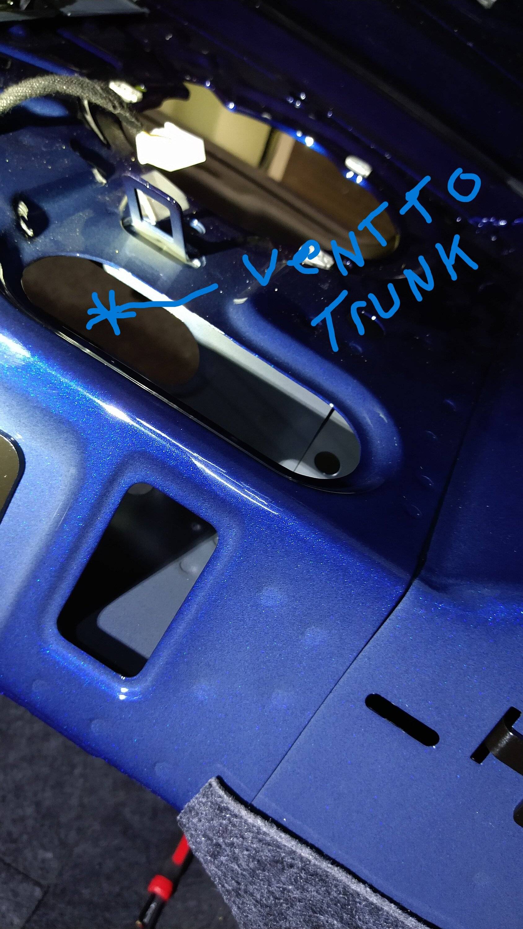

For the Back rear deck speakers which I could never hear music from, once I replaced them and put grill covers over them to allow the sound to go through the rear deck panel without being muffled by the closed, covered panel.
