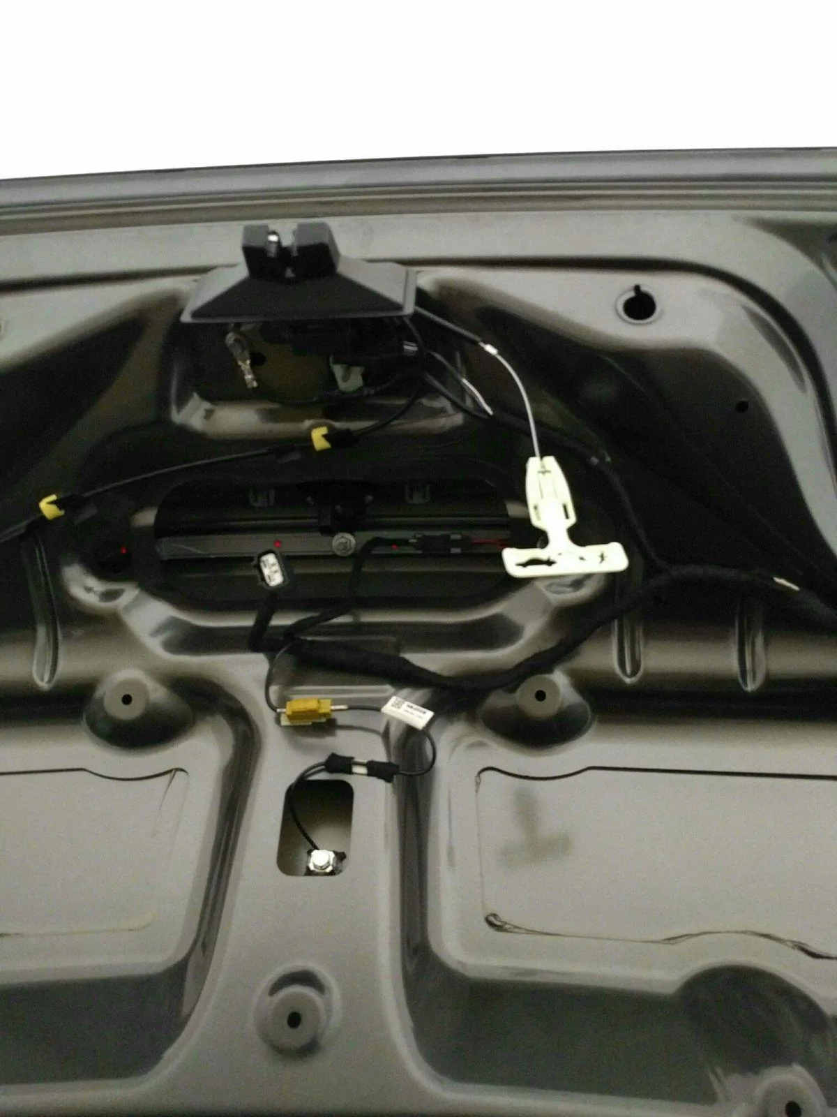

Well, I got the camera fixed so now I don't care if the decklid is stuck now lol.
I pulled off the cover under the trunk lid and had direct access to the camera. Went bought a 5.5m socket to take the camera screws out. Pictures attached.

Thanks a lot guys. It was a pain in the ass and thankfully I was able to access the camera from underneath. Otherwise, I'm 99% sure that decklid would have broken with the amount of force that was required.
I noticed that putting the decklid on was a LOT more difficult than it was putting the stock one back on, but I wouldn't have thought that it would be because the camera was upside down.
