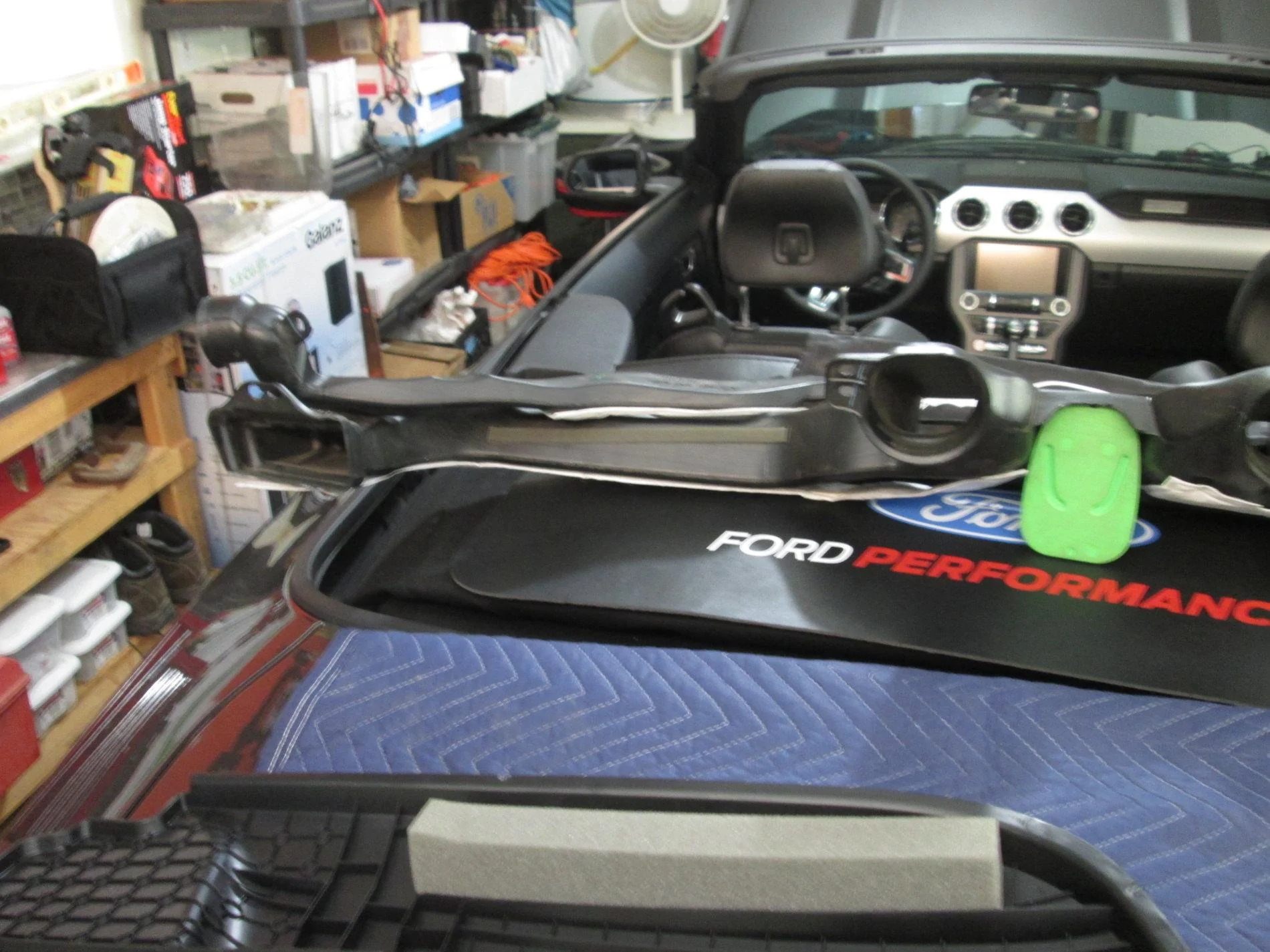

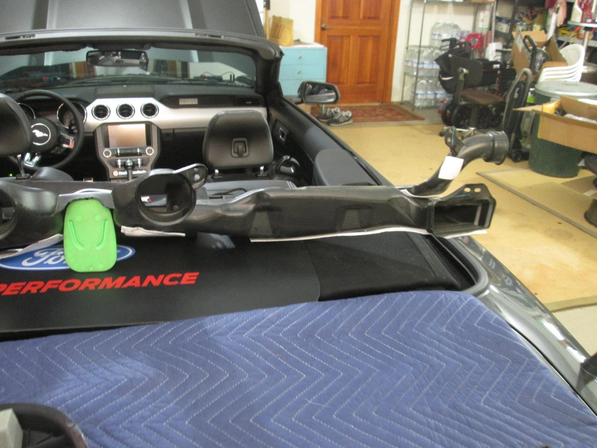

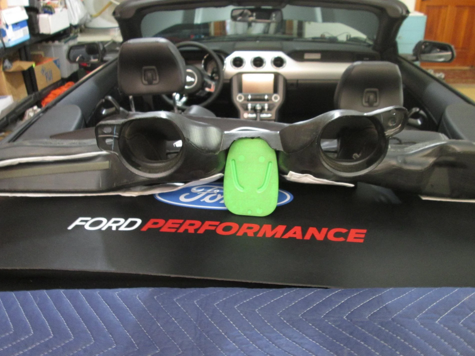

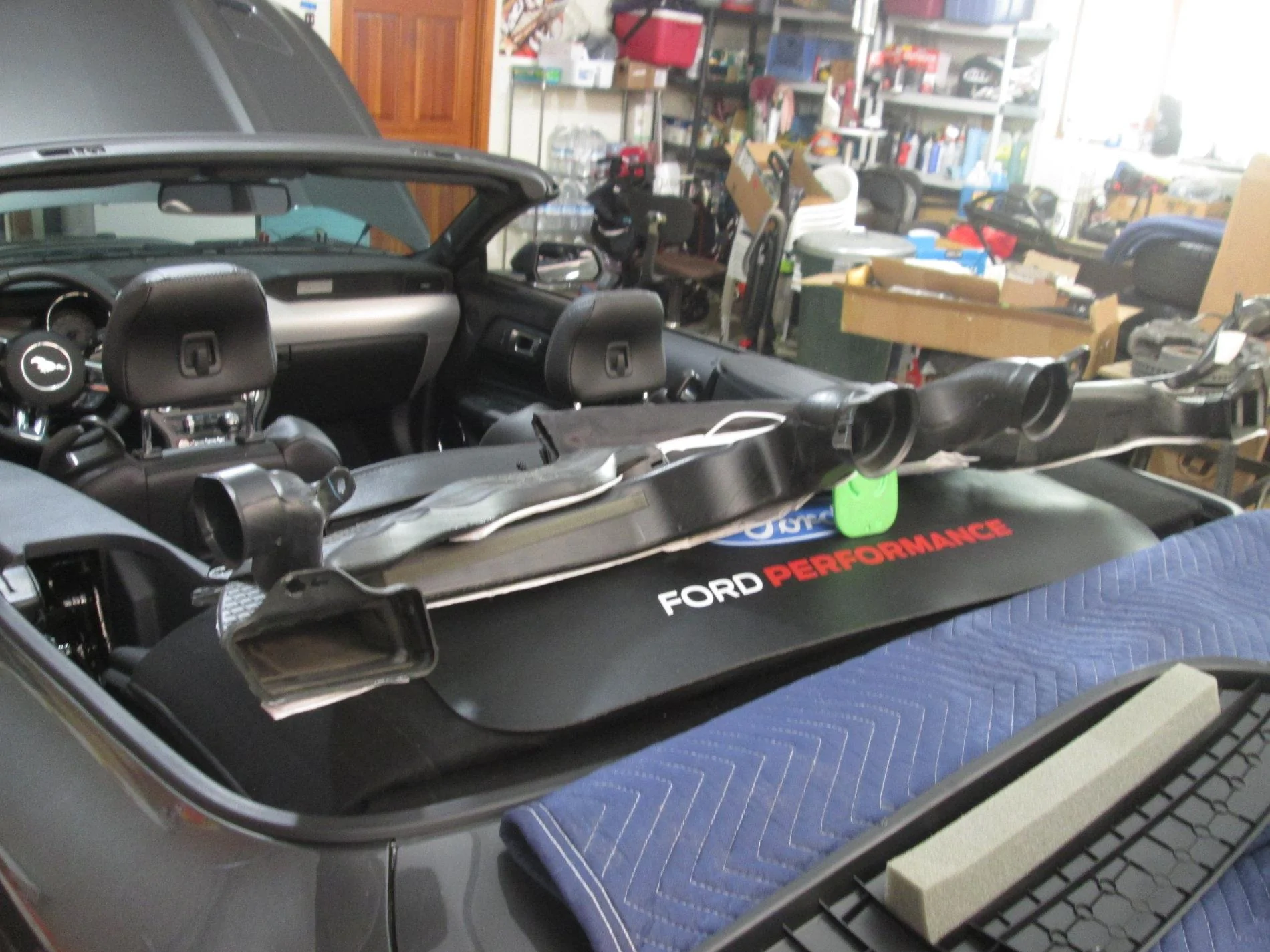

Thanks and I did I found the correct screws from another Mustang parts guy. You can order them thru ford also. I also found the PP1 plastic air vent assembly like new. Anyone wanna see a pic.? This part will be perfect for the conversion.. Here are some pics of the duct work. So any tips on installing this?@canyon ed were you ever able to find part# or screw size? about to go hit up hardware store and find a screw that fits. . . lol. Thx
