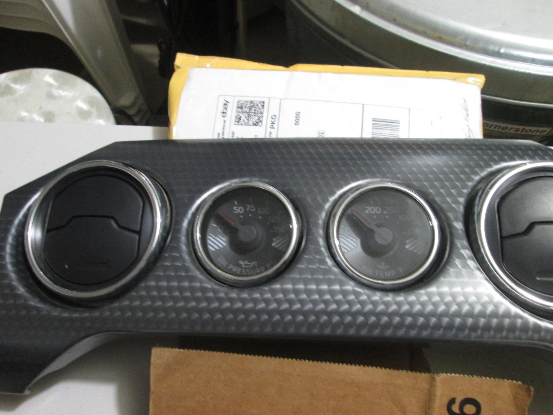

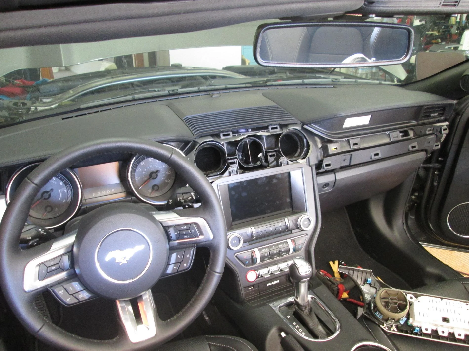

Thanks and I did I found the correct screws from another Mustang parts guy. You can order them thru ford also. I also found the PP1 plastic air vent assembly like new. Anyone wanna see a pic.? This part will be perfect for the conversion.. Here are some pics of the duct work. So any tips on installing this?
In order to put the plastic piece in you would have to pull the whole dash out of the car to do. The hardest part is the two bolts in the engine compartment due to the windshield wiper stuff and plastic cowl piece that is glued on in our convertible cars.

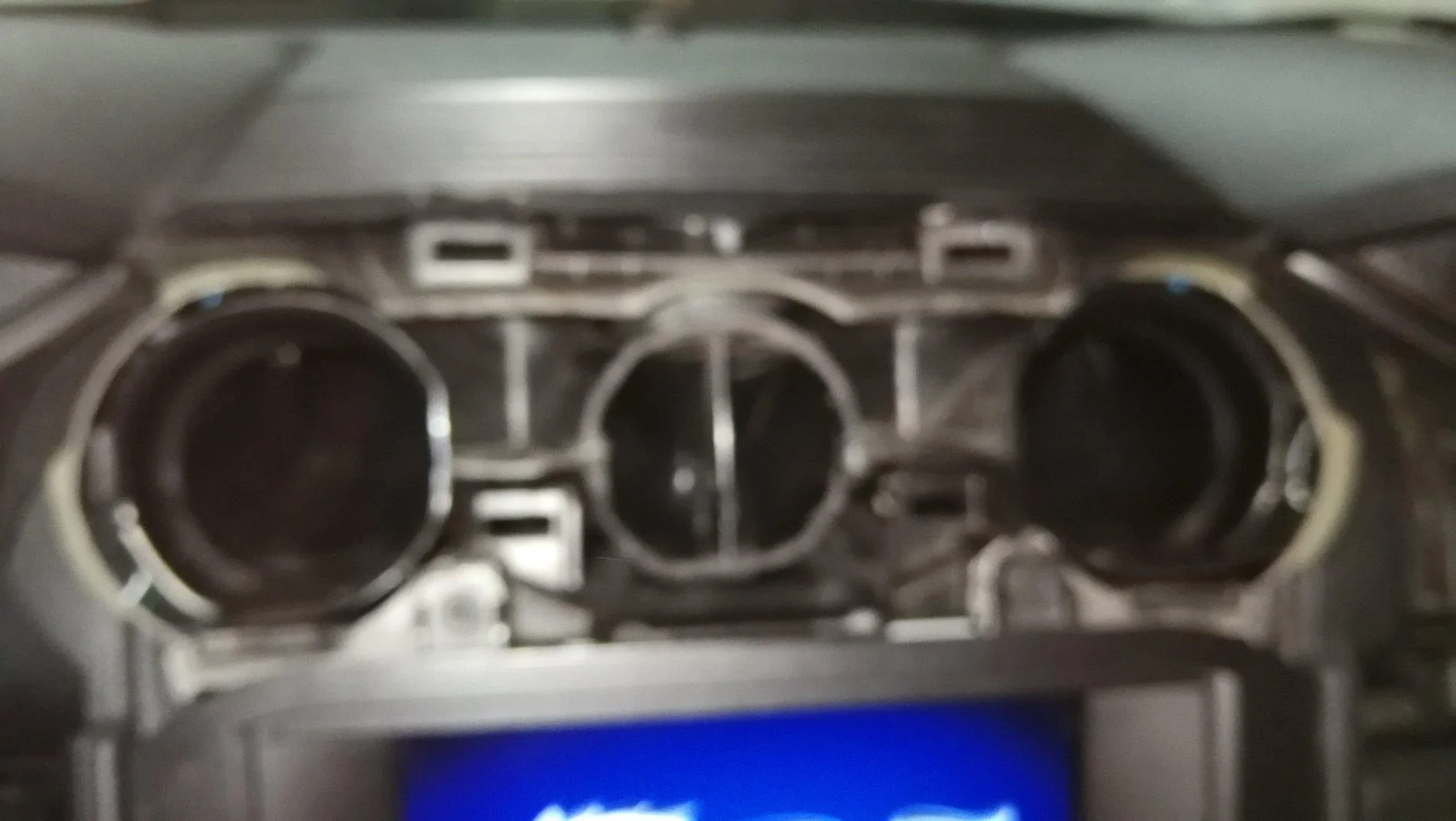

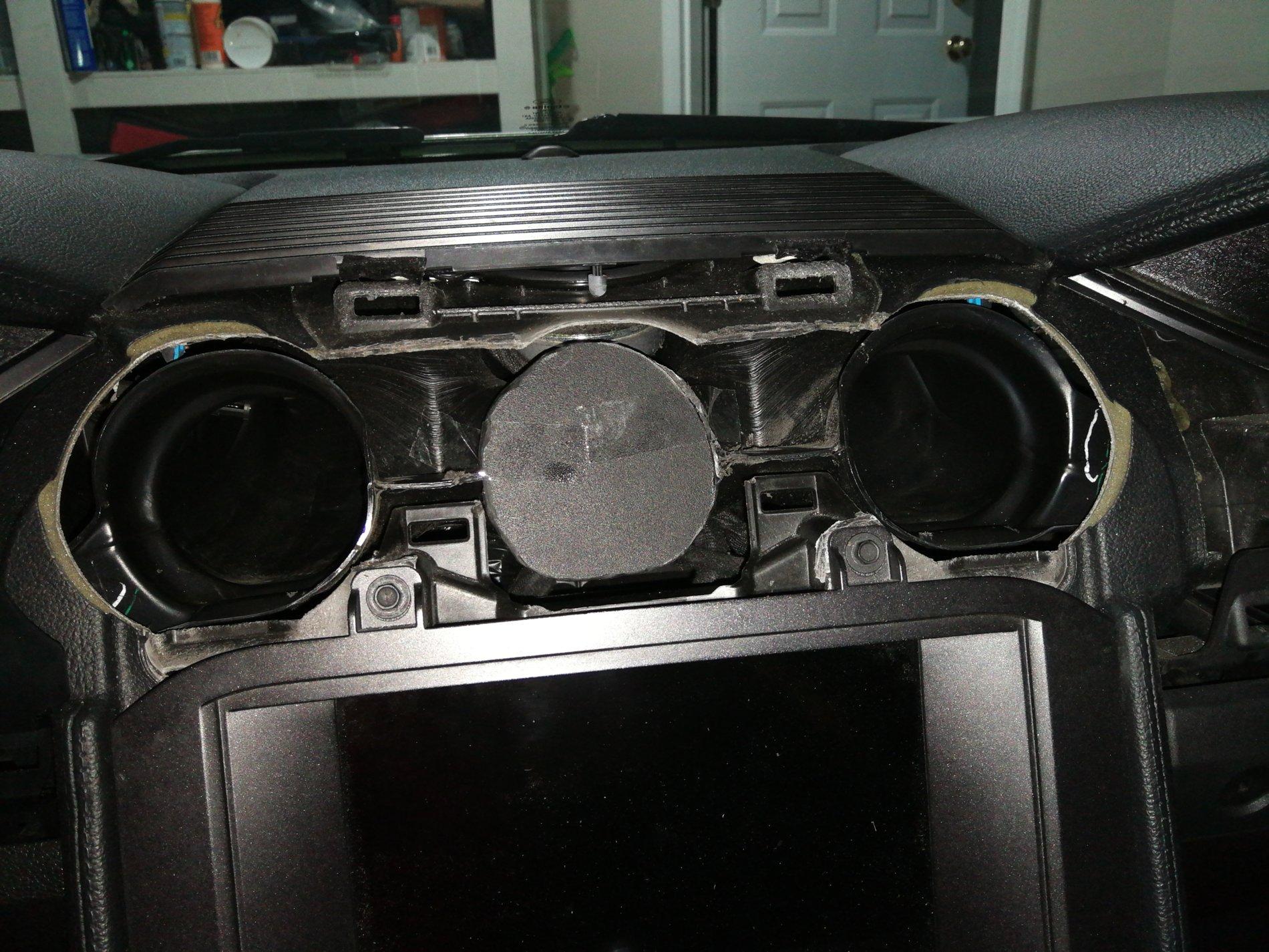

that would be nice if you can replace the air duct assembly. I started doing the necessary modification to the dash for gauge installation. I decided to block off the center vent by cutting a piece of 1/8 plastic and securing over vent hole with a couple dabs of plastic epoxy.(pic below shows it taped in place while I was testing fitment)

That looks easier that taking out the dash. Was the wiring there already on your car?
yeah it was in that square slot in the plastic dash structure behind display. just had to push out from front and grab from behind.

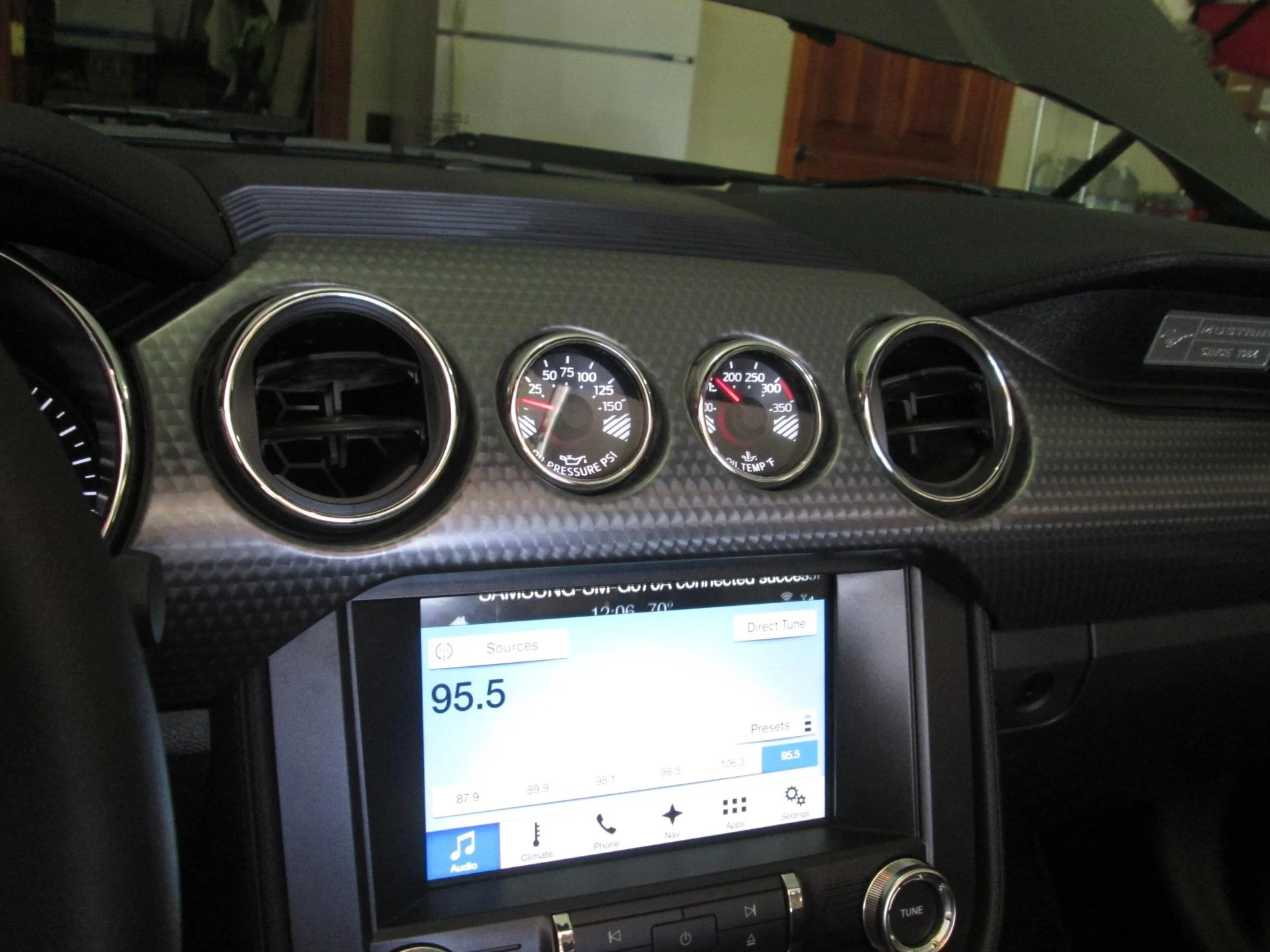

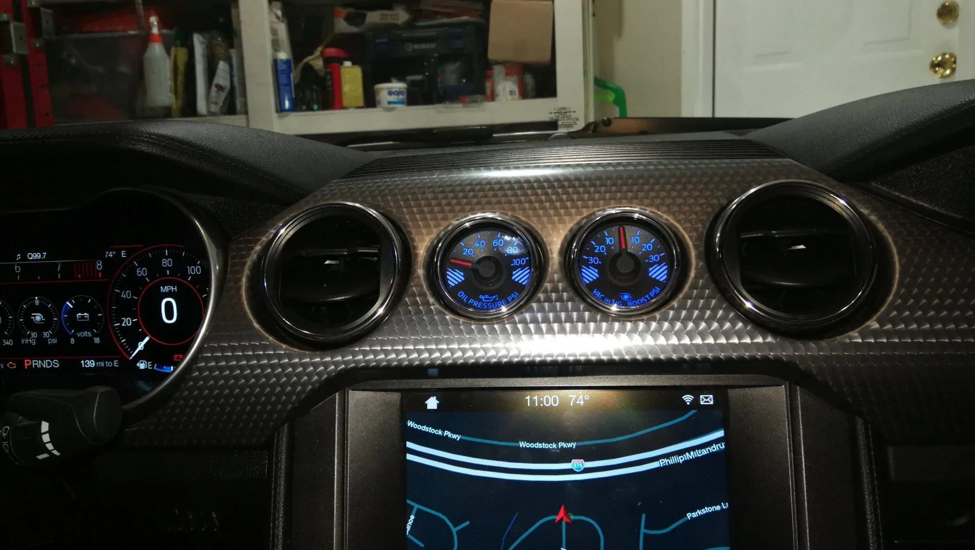

PP Guage installed, boost gaude working, next step to tune and get oil pressure working.

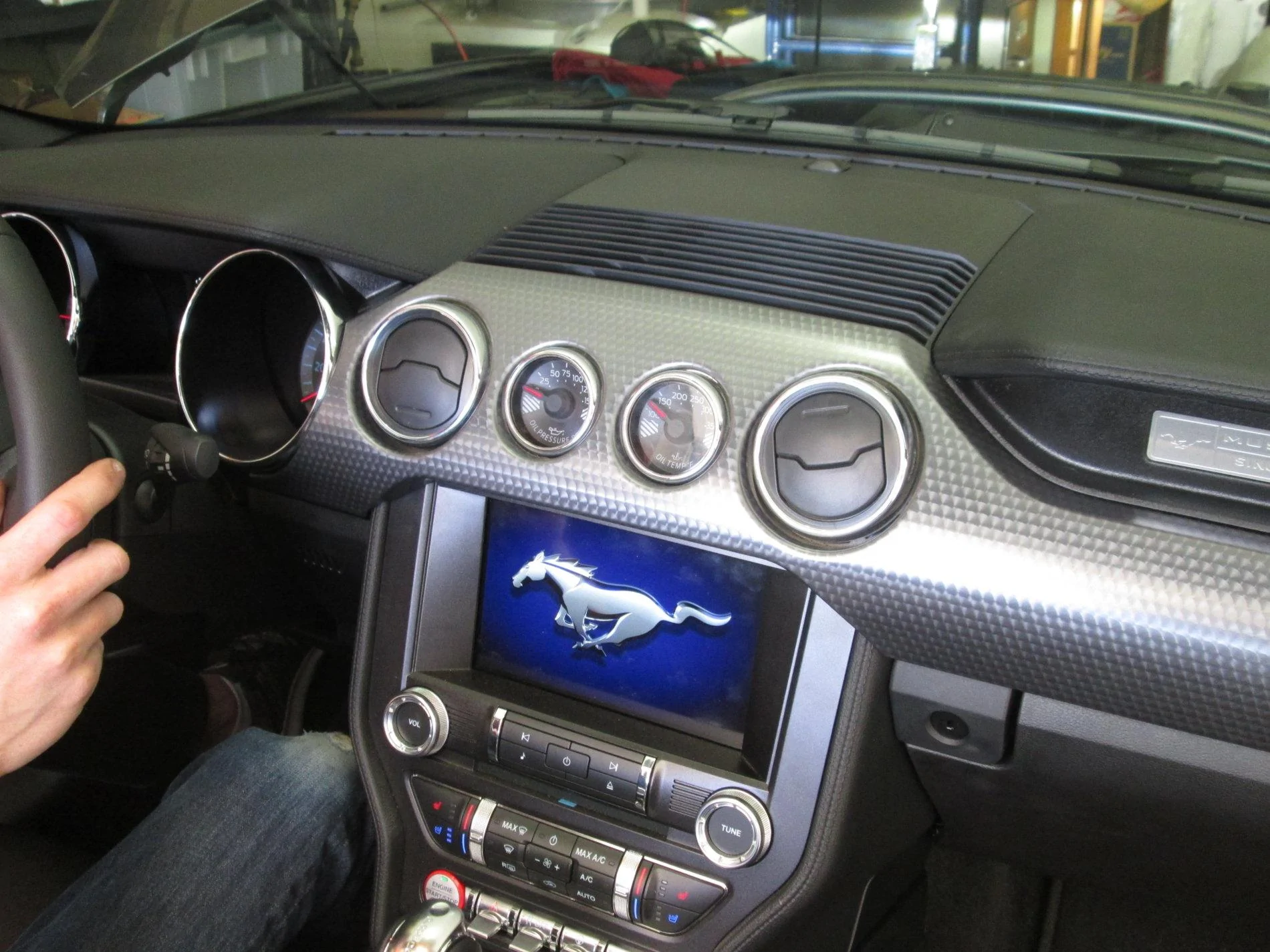

Good news and I am installing mine this weekend.
The plug was there and we installed the GT 350 PP1 gauges but the oil pressure gauge is not working any ideas on what to do next. Oil temp works fine, We are almost there

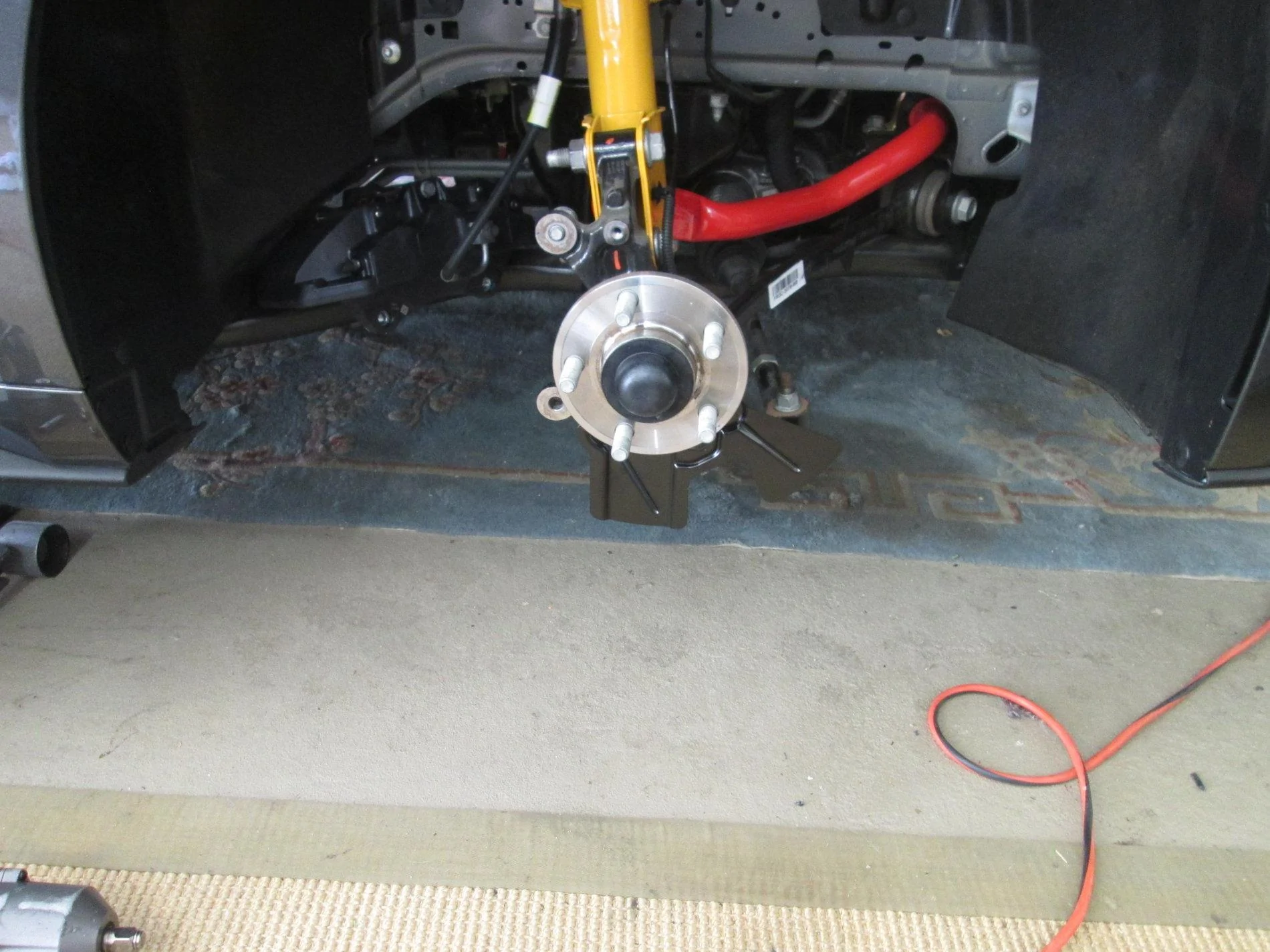

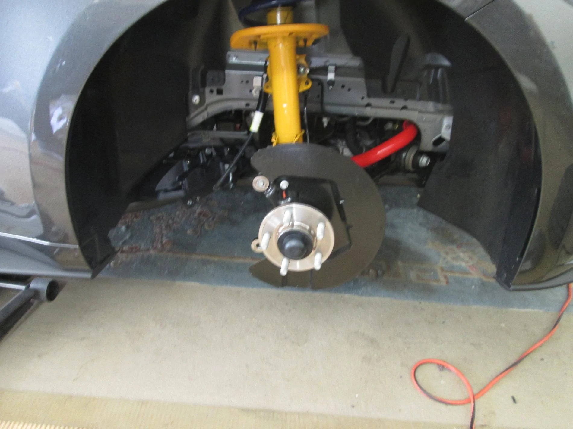

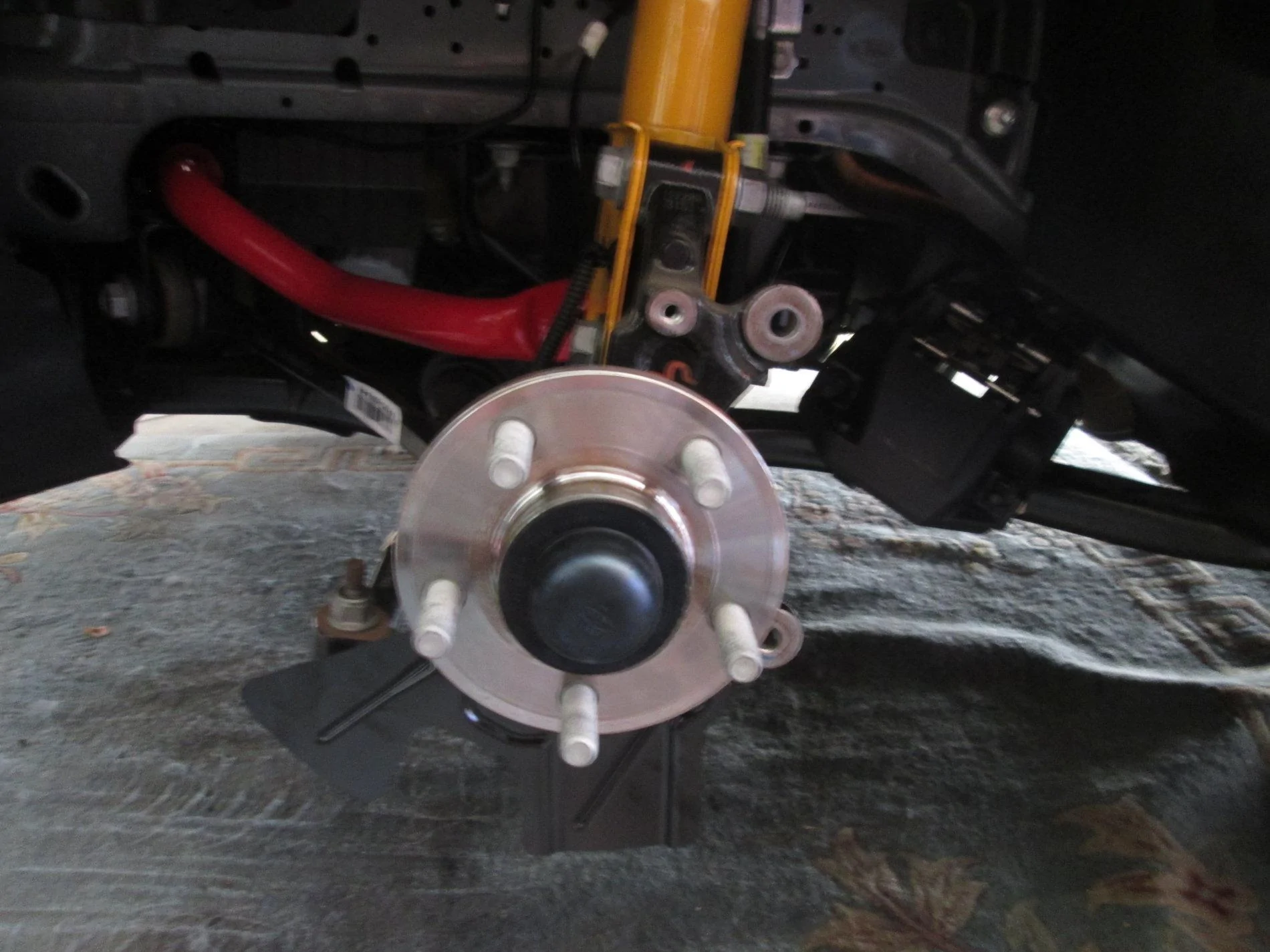

We Also took off the front Brembo's and installed the correct dust shields for way better cooling and installed a New PP1 wheel set. Next is the the PP1 radiator installation.
need the sensor turned on in PCM, this is done with custom tune. Either that or you can find shop to make changes to PCM, one forum member had his shop that was able to make. change with hp tuning software.I was planning to buy Cobb tuner in future so Im going to go with custom tune.

need the sensor turned on in PCM, this is done with custom tune. Either that or you can find shop to make changes to PCM, ONE forum member had his shop that was able to make. change with hp tuning software.
Will Forscan work?
