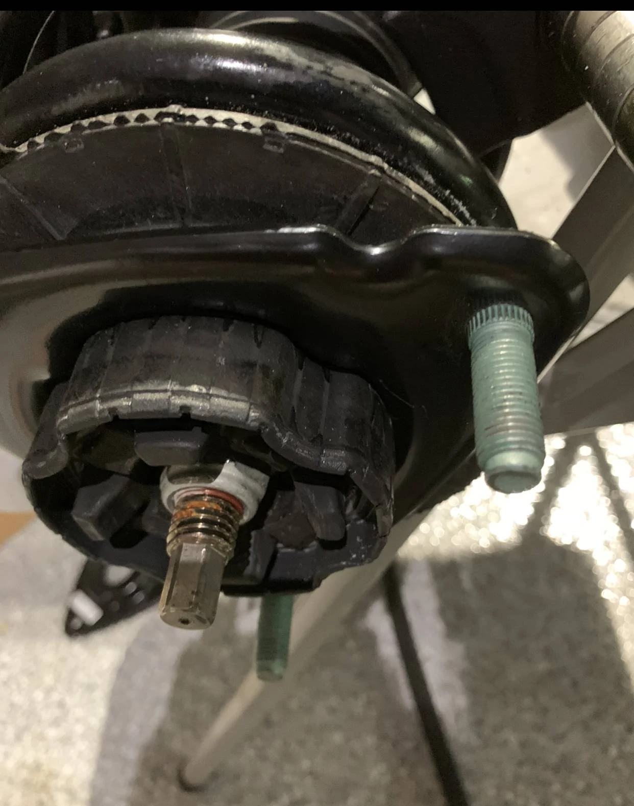

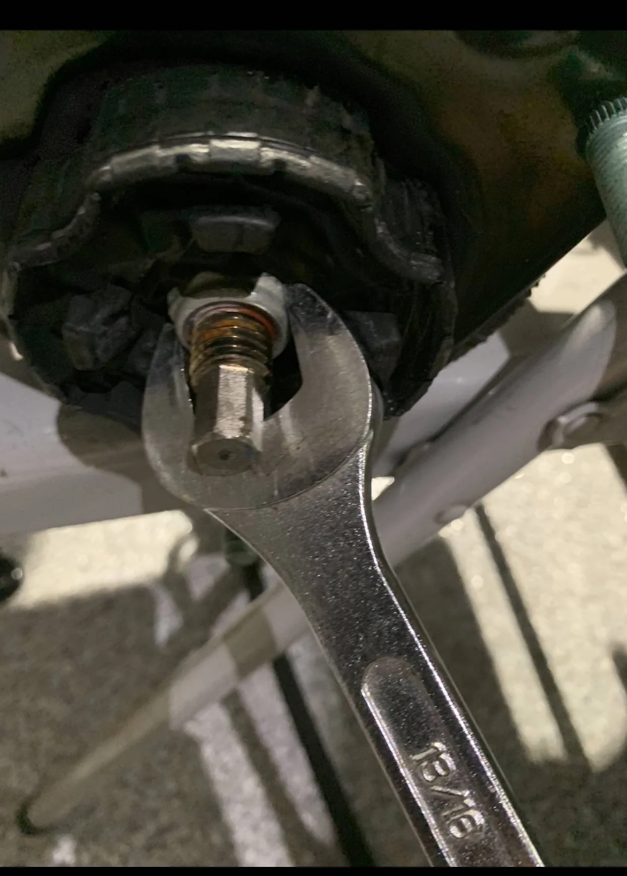

Ok what specialized tool do I need to remove the strut nut? See photo below.
Issue is you can’t get the wrench on the nut to remove the nut. You can’t use a socket because you need to hold the top of the strut so it doesn’t rotate with the strut.
I know several people have done is so what did y’all use?

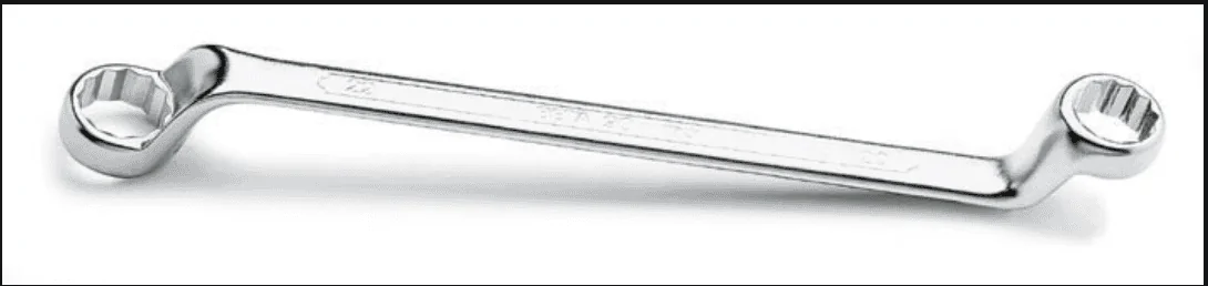

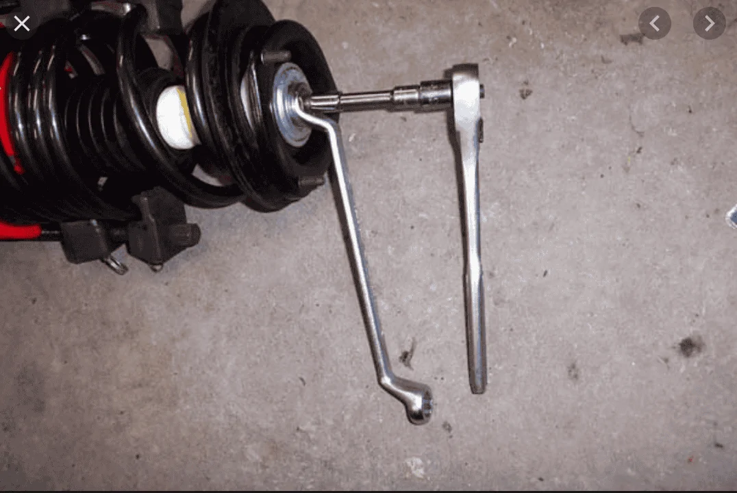

I ain't gonna lie, I always use a socket and impact gun......
Your other option is an offset boxed wrench for the nut, and anything you want to hold the Allen stud (I usually use a socket on a ratchet).

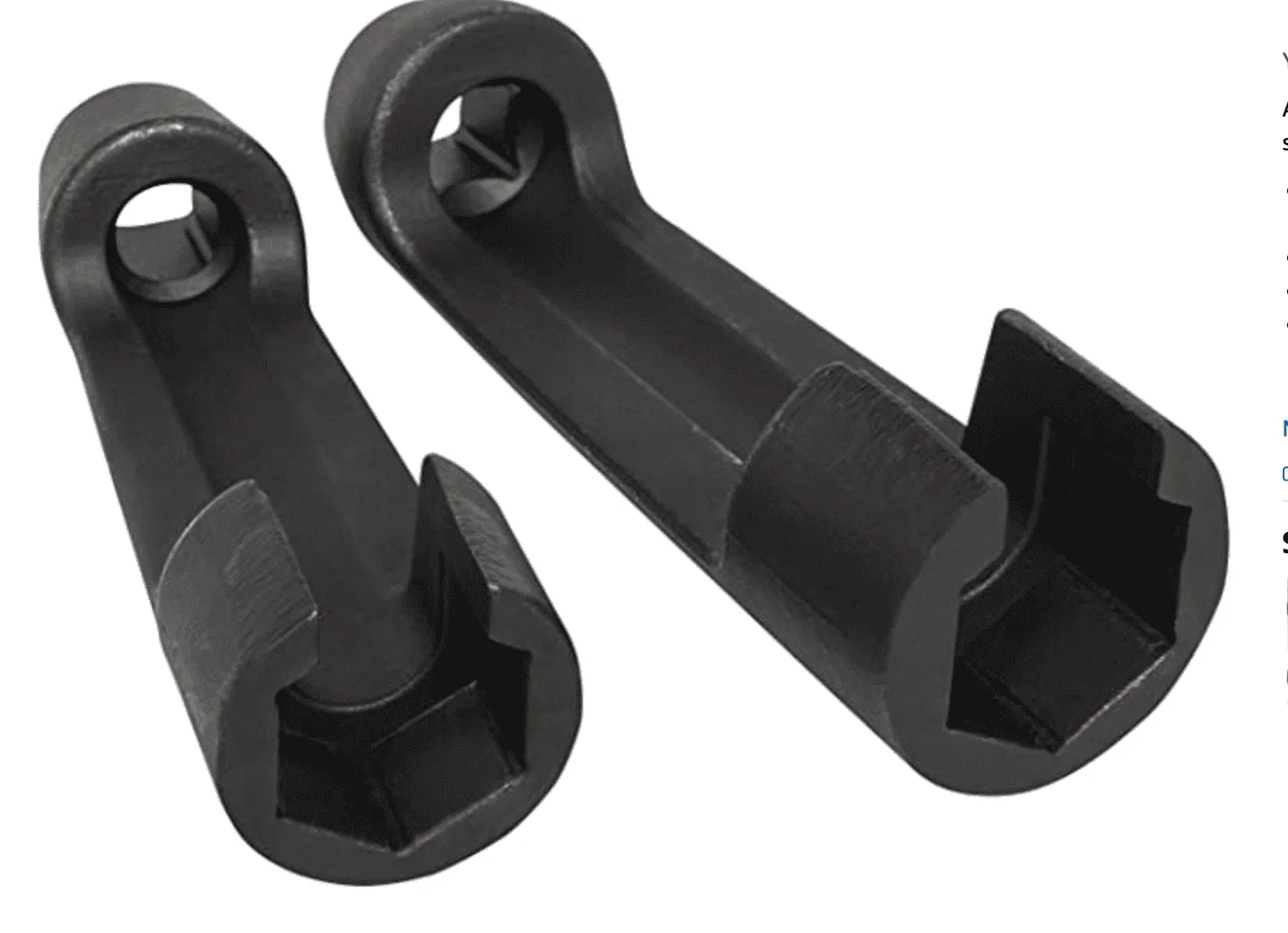

You can also get specialized sockets for this very purpose

That offset wrench is what I was thinking.
Thanks
