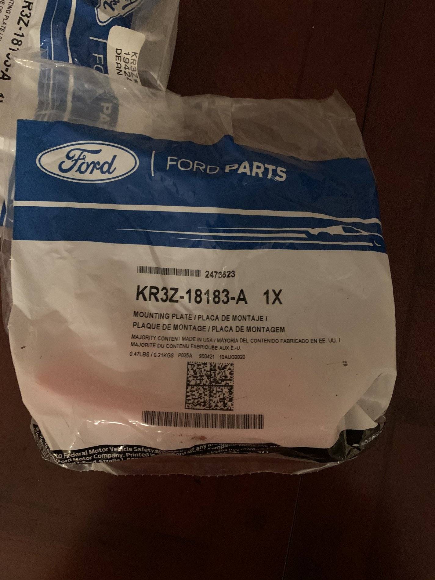

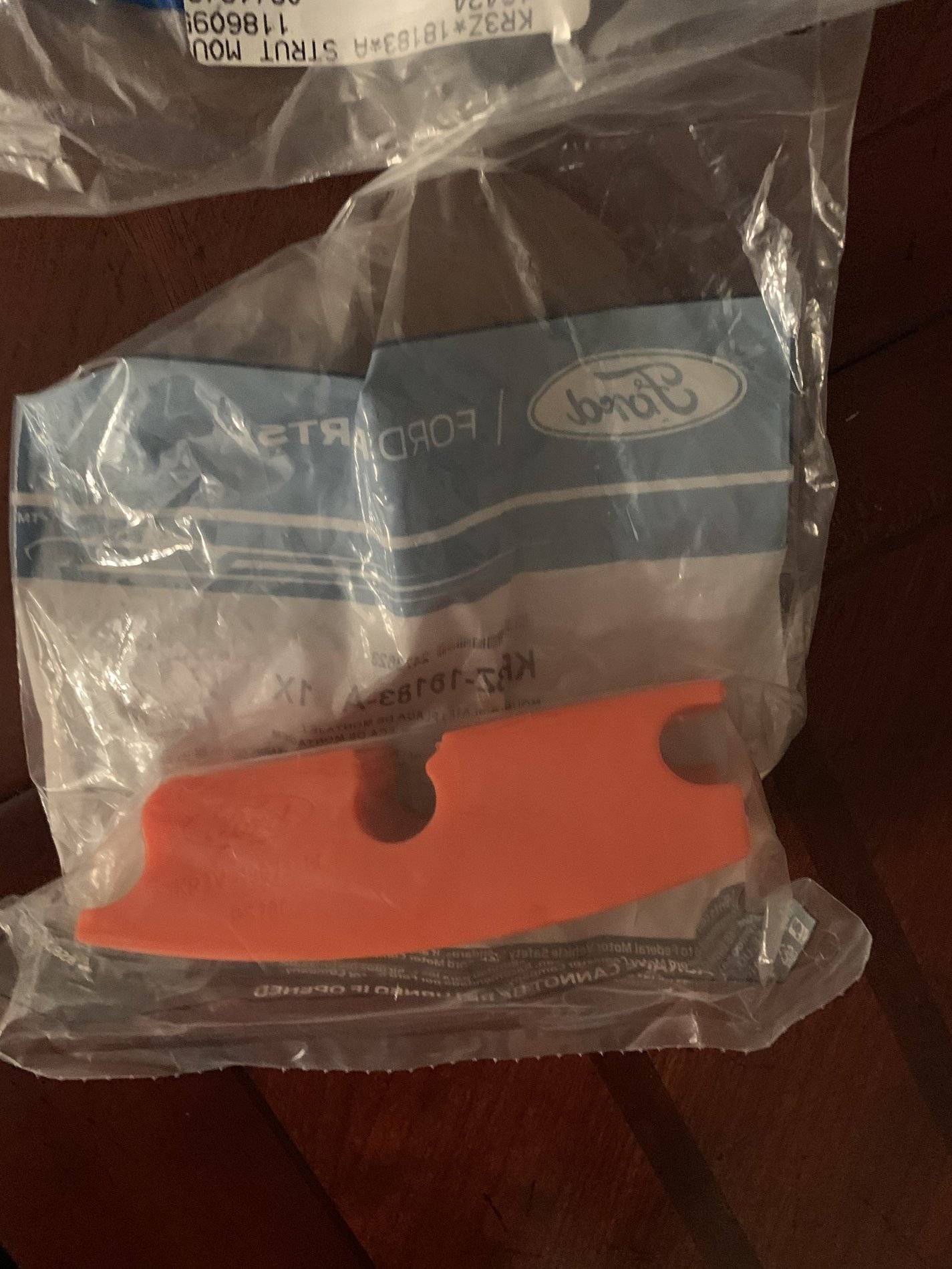

I am trying to figure out what is the correct part I should receive. I was just shipped 2 orange rubber parts. This is what Ford parts department produced. Any help here would be appreciated.

Those are front shipping spacers that came on CFTP cars from the factory.
Thanks. I knew they were not what I was asking for. I will continue the search. I know it has been difficult for everyone to get them.

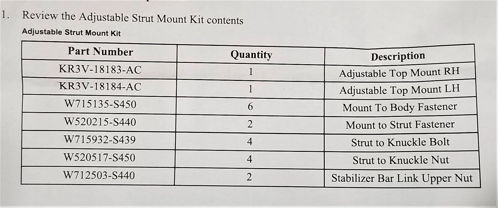

If you purchased a CFTP car, the adjustable top (front) shock mounts come already installed on the car. You can peek inside the top of the towers and see the labels for the parts, right side and left. This was for all CFTP cars that were made for Job 2 (after Jan 1, 2020, I believe) If you ordered a Base GT500 and added the "Handling Package" Option, they should have come with the car, but in the trunk. The link I posted above is for the FPP parts that they list for 2018-2020 Mustangs. I believe they are the same, but someone with a CFTP car can peek at the plates in their car and confirm the numbers

Job1 CFTP cars came without adjustable camber plates installed, they came in a box in the trunk. Job2 CFTP cars are coming off the line with them installed. These are the same camber plates Ford designates for the GT350R or base GT350 with the Handling Package. Again, exact same part.
Base GT500's with the Handling Package are not designated by Ford in an official capacity to have camber plates included as part of the option. If a Base GT500 with HP owner had plates given to him by the dealer it was an error, typically the plates were earmarked for a given GT350 but that owner never got them.
Part numbers for the individual plates can be seen below. If this is too complicated for your dealer they either aren't trying/don't care or are in the lower spectrum with respect to intelligence (insult intended).
