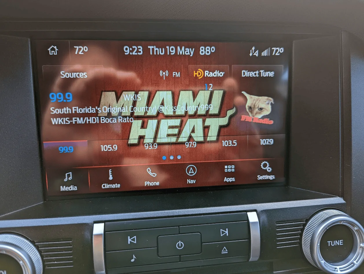

Gnatsum21
Oct 31, 2021
1,078
2,099
Fort Lauderdale FL
Former: GT 21 Roush Twister Orange RIP | ECO 2016
I made my kitty the default FM Radio station logo.
