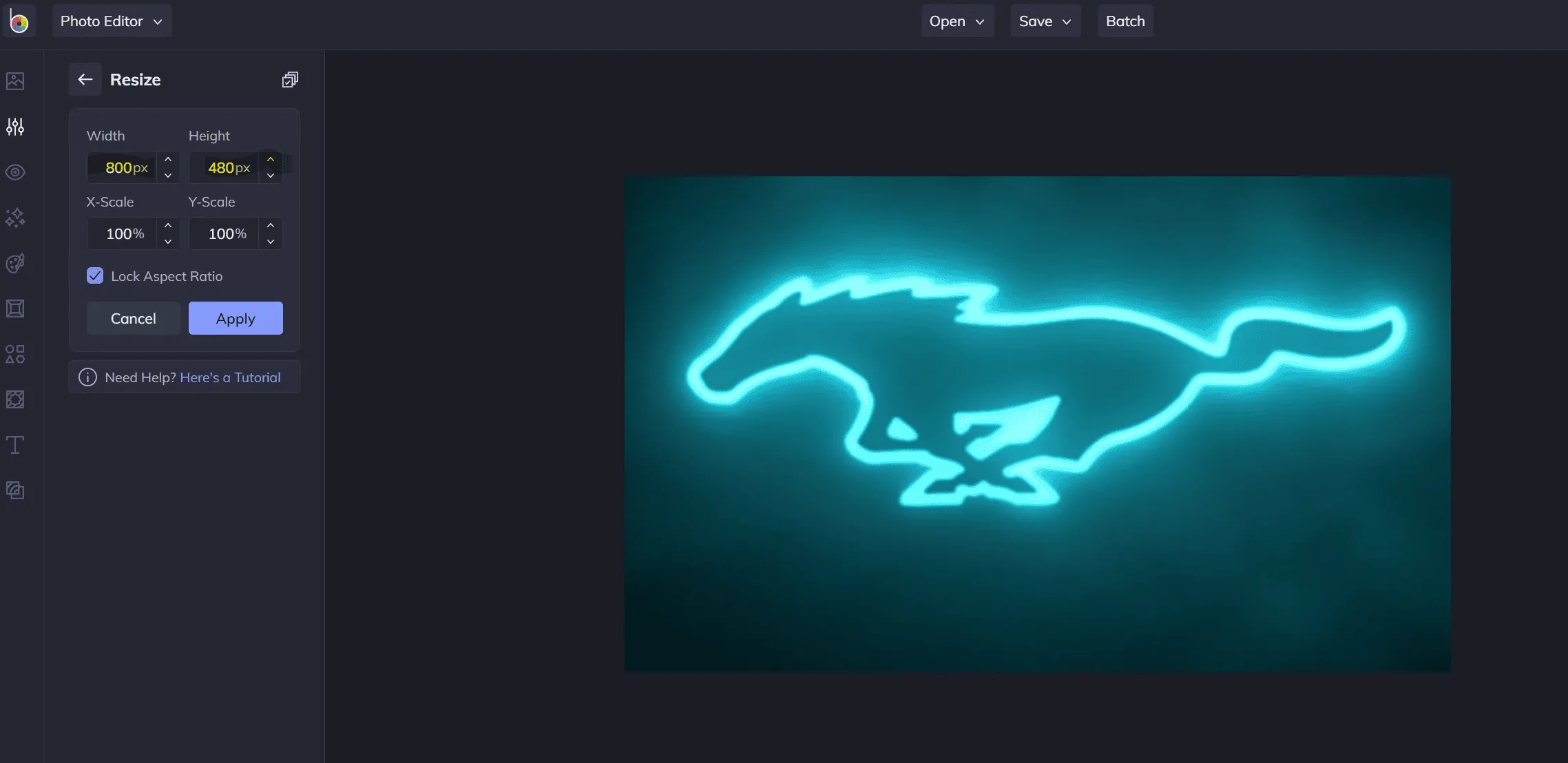

Without that piece you can't upload any pics. (pics need to be 800x480 pixels)

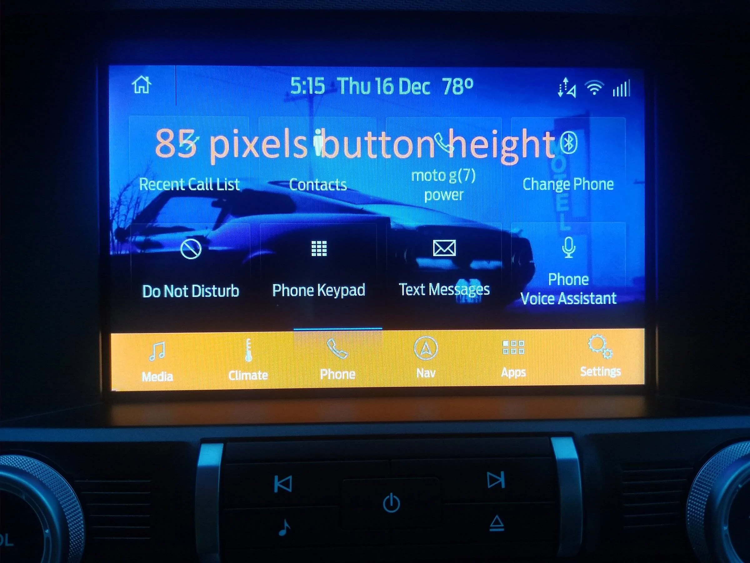

3. Create/edit or modify background images. I used a (somewhat free) website for editing my images. As I have found out images must be 800 pixels in length and 480 pixels in width. See below.

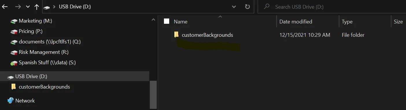

Once satisfied copy images to your USB stick. The main folder has to be in this format (customerBackgrounds).
Inside of it 2 folders, day and night.

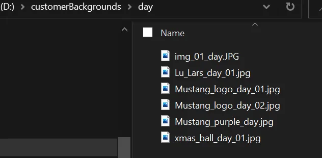

Example inside the day folder (no special characters). Sync needs those in order to find your day/night pictures.
Hint, when editing pictures adjust the contrast or brightness to dark for night pictures, but its totally up to you, you can leave them like the day pictures, as long they can be found in both folders.

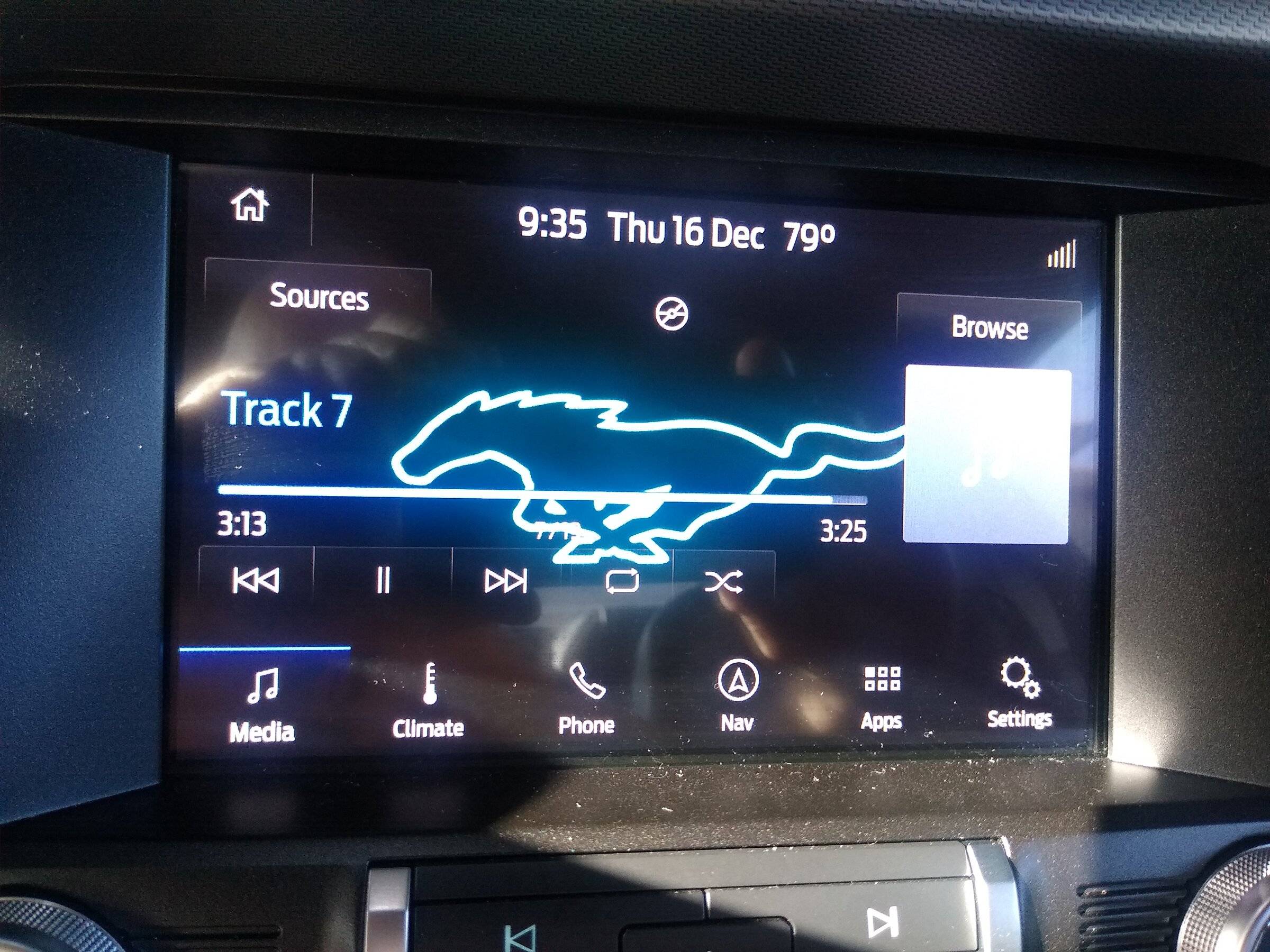

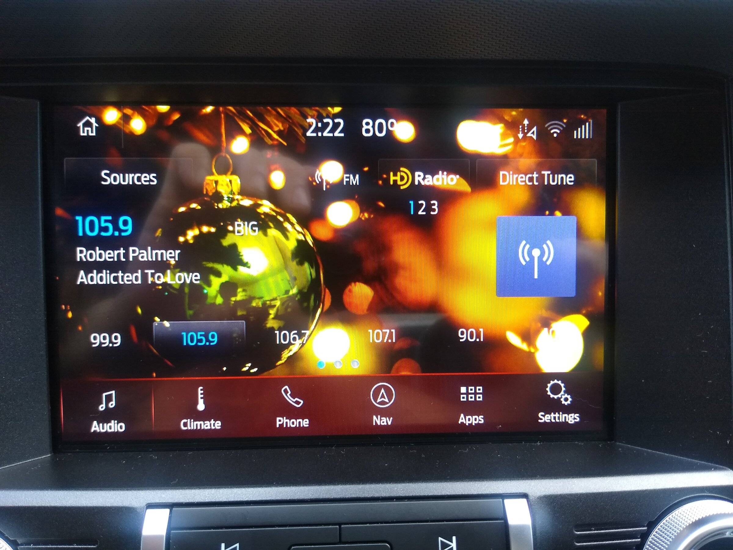

Oh, the themes can be found here. I chose the Aqua red theme for now.

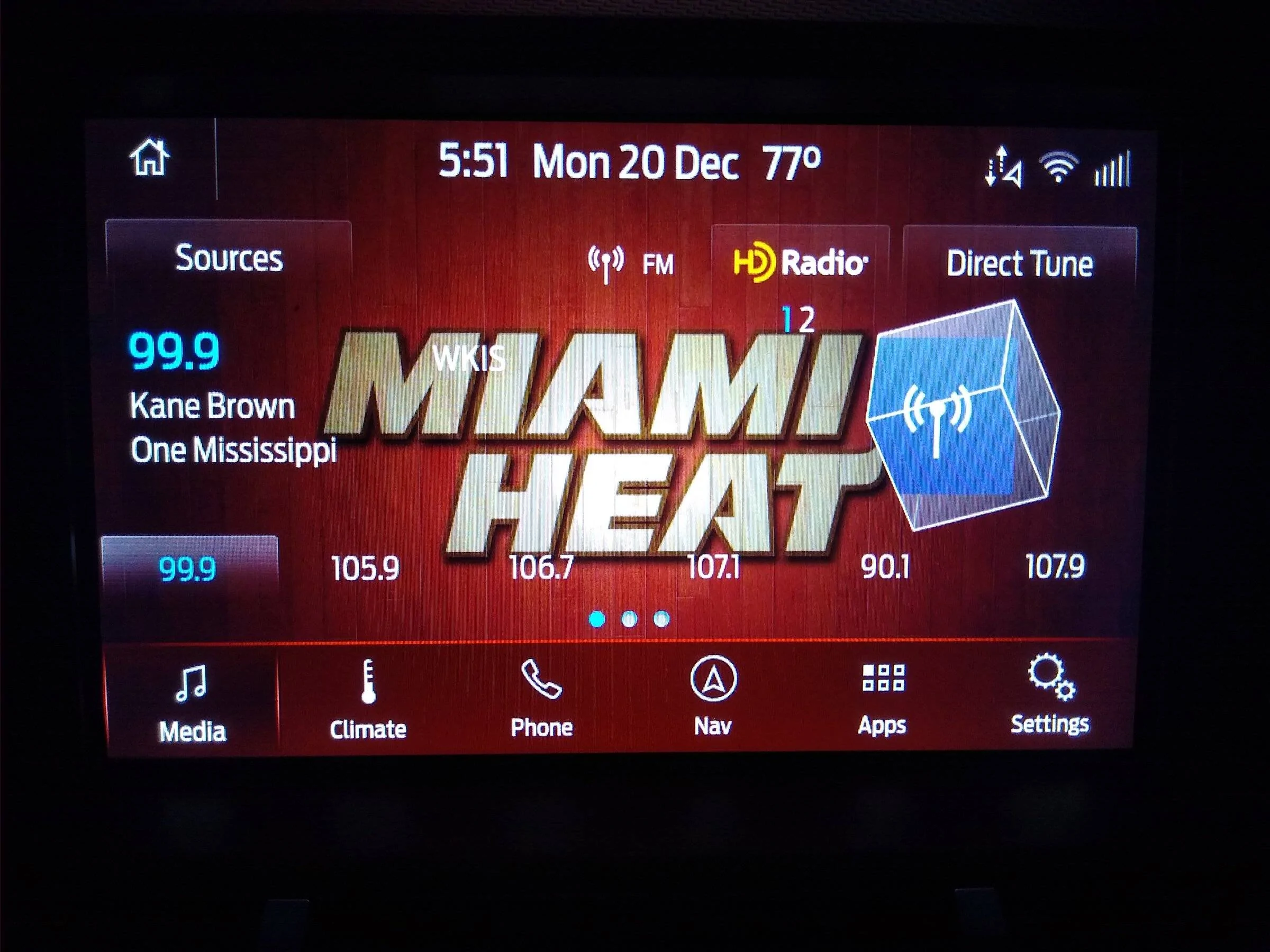

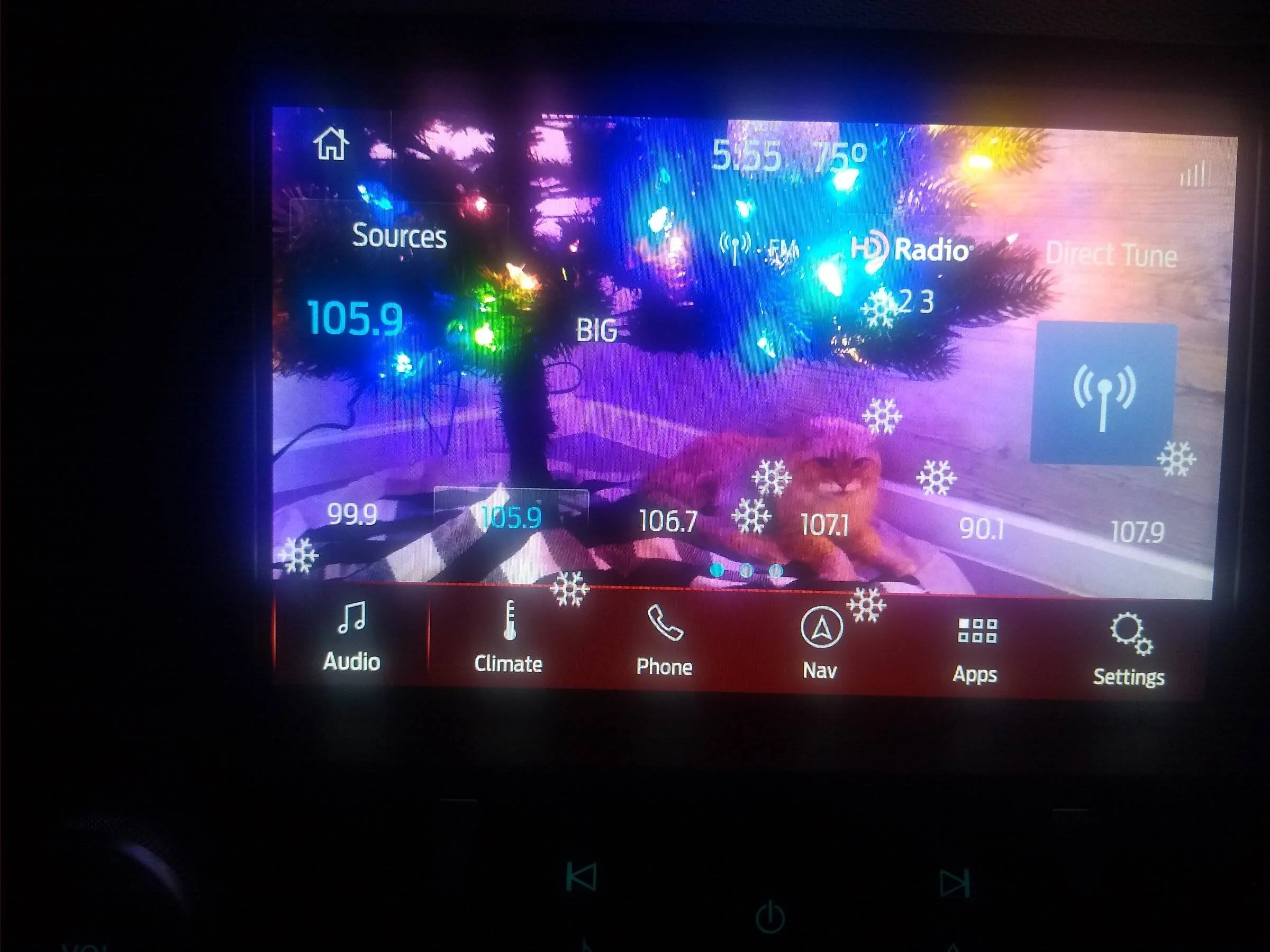

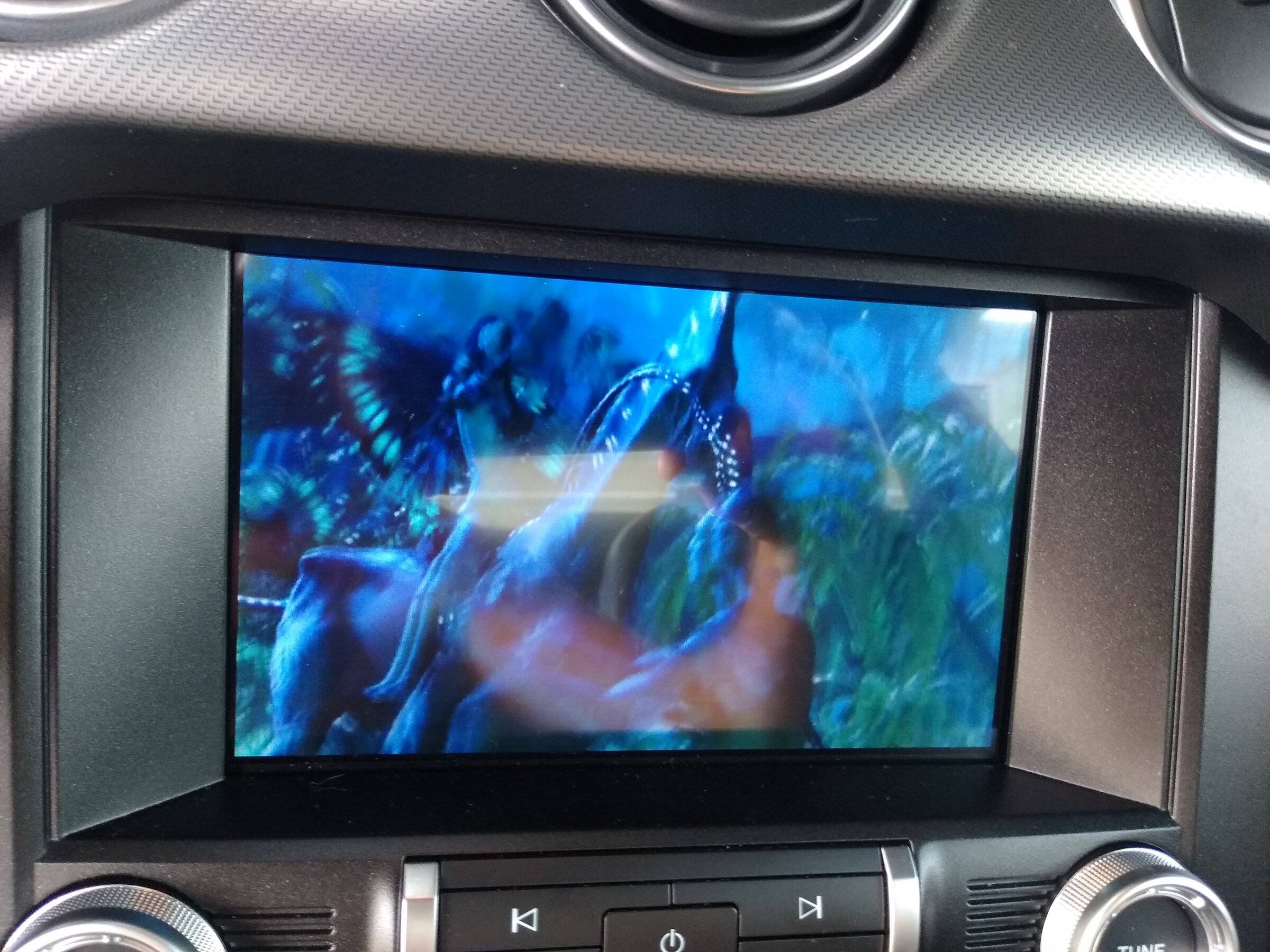

And the snowflakes and other cool tools (Video Player, etc.) can be found here. It will add moving snowflakes over the whole display, if you're navigating, inside Android Auto, everywhere. It needs to be enabled/disabled in Display after install.

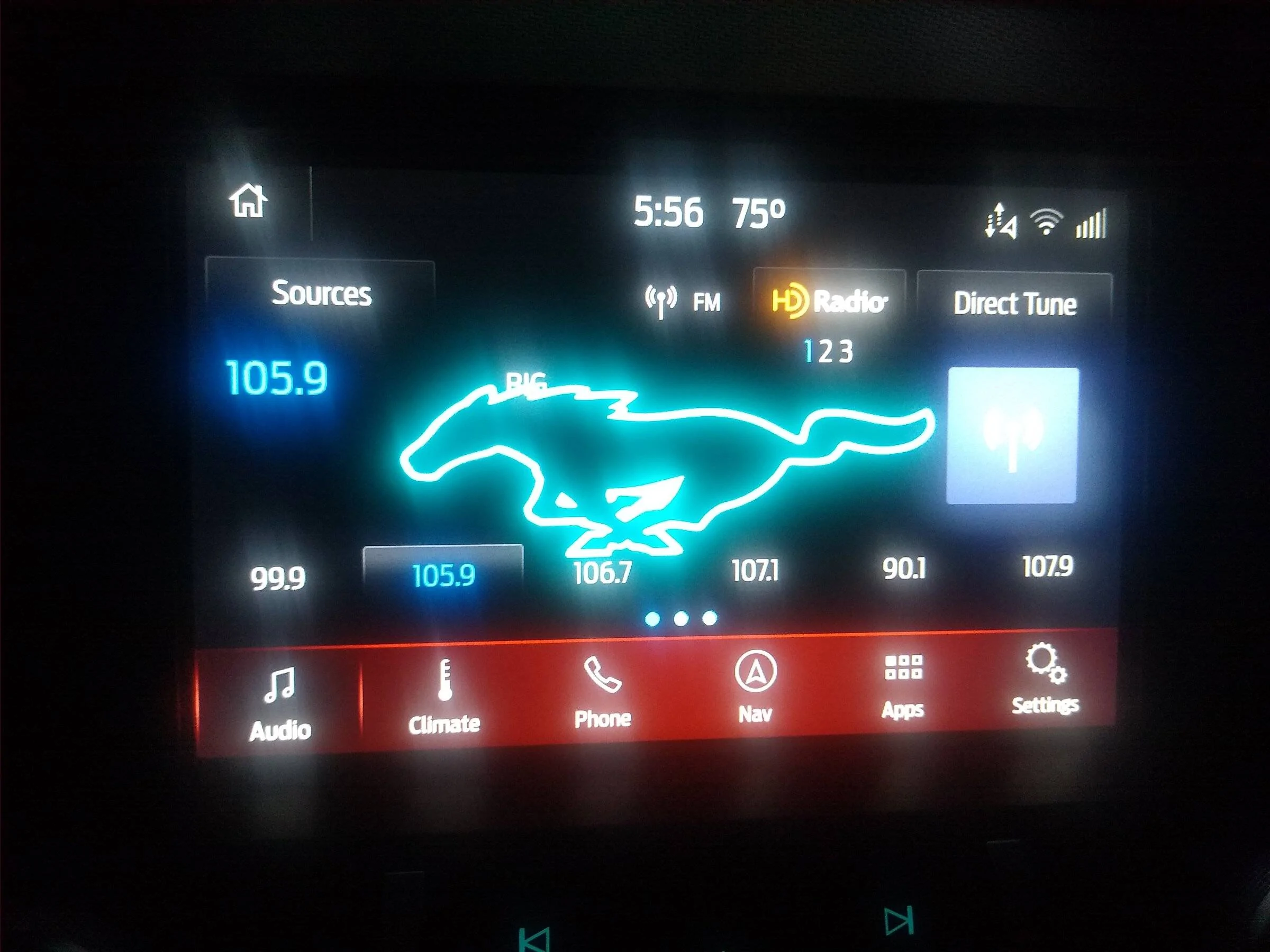

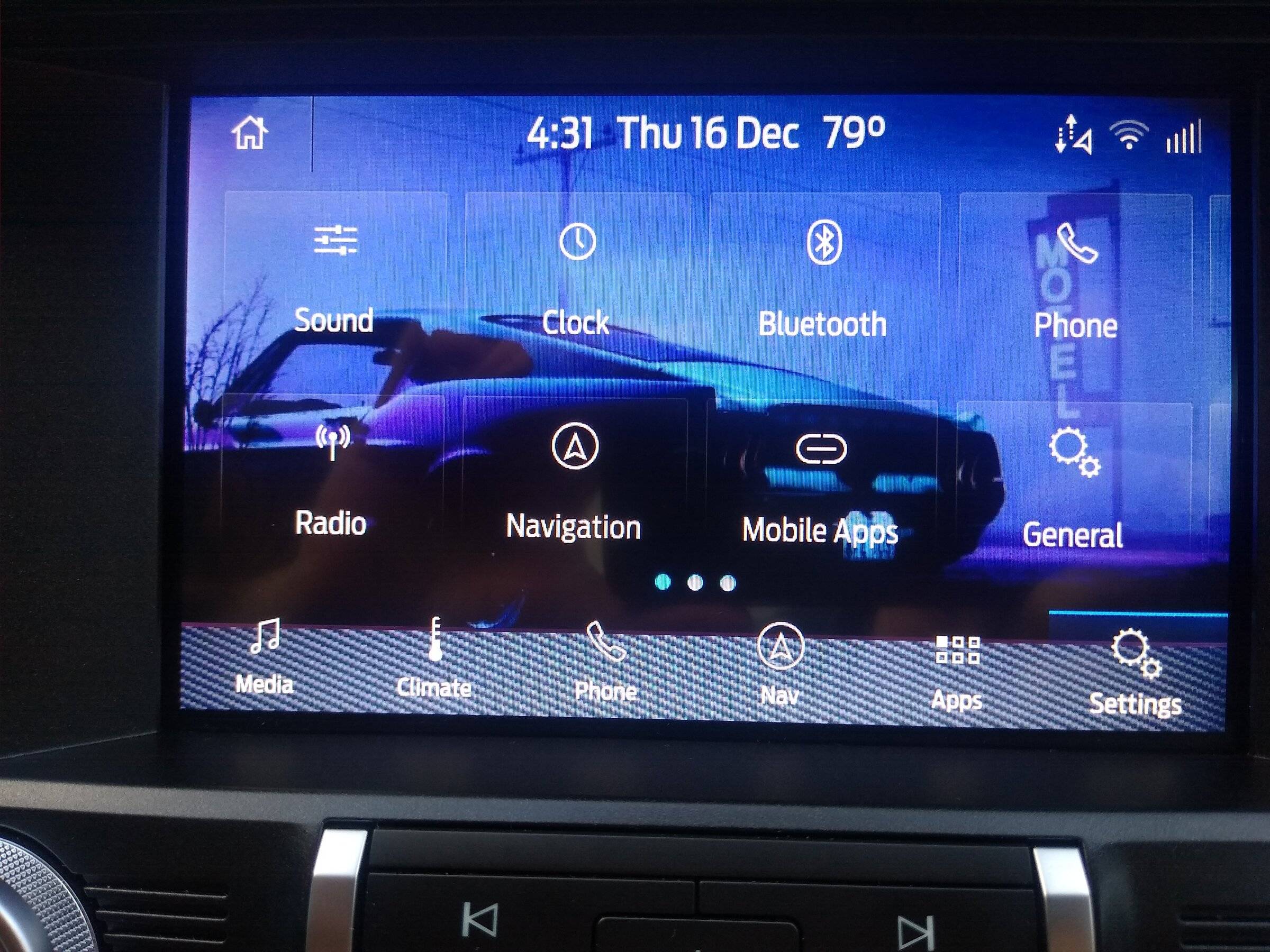

Result:

Result:
