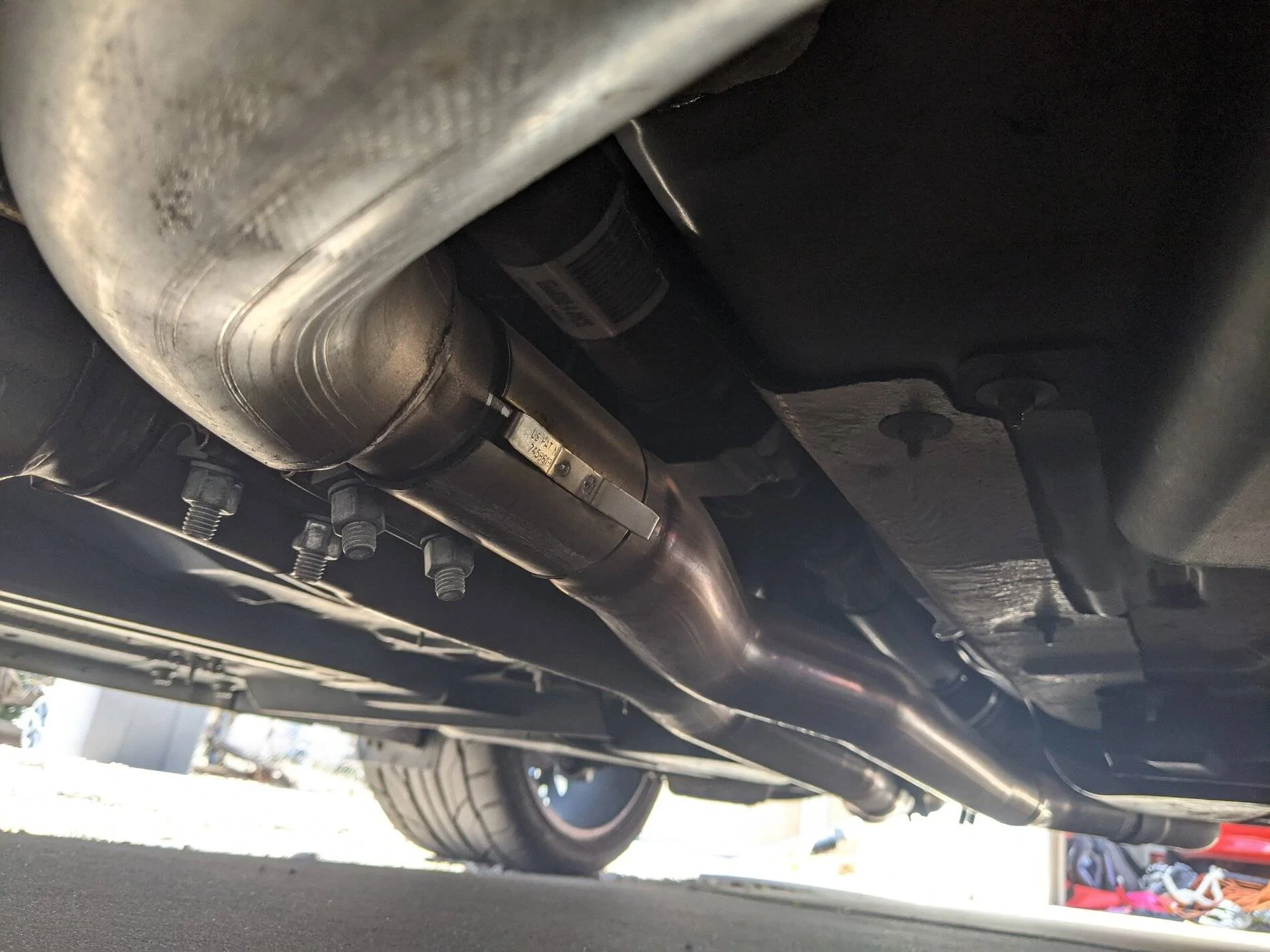

The exhaust - someone definitely did a nice conversion there. The rear bumper cover valence looks to be aftermarket allowing for the quad tips (2015-2017 only had dual exhaust from the factory). Also, looking closer at the rear mufflers, it looks like it might have actuators? I see what appears to be a flange at the face of mufflers where the tips mount. Wondering if someone possibly did a 2018+ active exhaust swap? Hard to say, but just an assumption seeing what appears to flanges. Unless the system is SS Borla or Magnaflow?

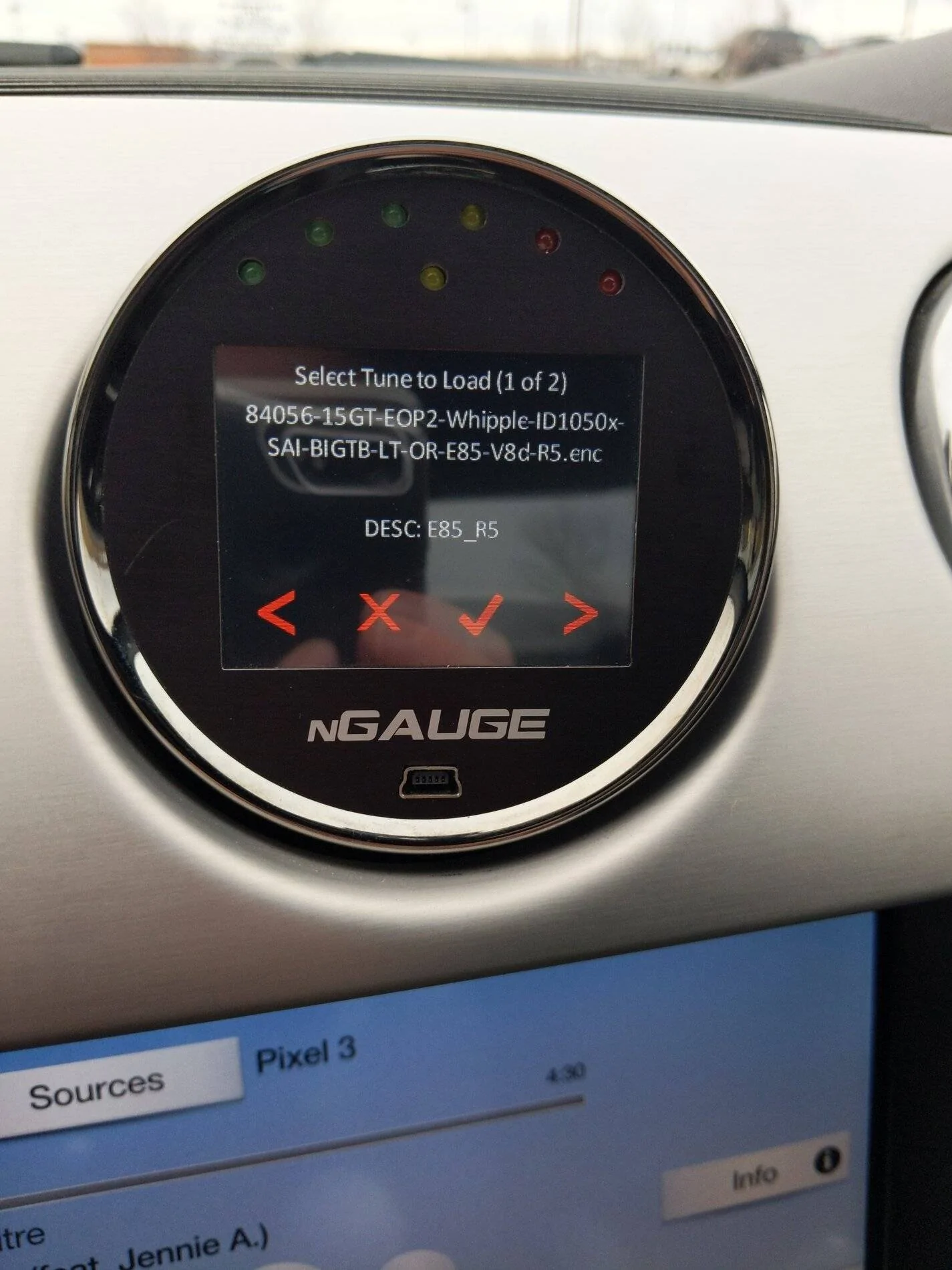

1) nGauge has been more sporadic with powering on and initially, thought it was due to the white wire being severed that plugs in with the little harness on the backside. Got that fixed with soldering, same issue, not powering on. Well heck, found out that goes to the boost box and not a power source (but still good to have connected) and tracked down other cable to driver side kick panel and made sure connection was solid. Wa-la, power! Still have a lot to learn about the functionality of the nGauge, but doing baby steps as to not overload my simple brain.
2) Speaking of the nGauge, it's obvious that there is a Lund tune on it - why not ask Lund for some additional info? Emailed them and within an hour or so, receive response. Nice Lund! No previous owner info but they provide me with some details about the tune:

Um, wrong tune? Everything listed looks accurate, as far as I can tell (and quite stoked about it too) except for the E85 as the nGuage obviously states that it's a 91-93 octane tune.
So I forward on some pics I've taken of the nGauge with detailed info, still waiting for a response back from customer support. From what I've read, it's my understanding that only Lund is able to provide the tune on this setup (locking it out), so it's perplexing why they don't have the most recent tune available. Anyways, give CS a little more time before following back up today.

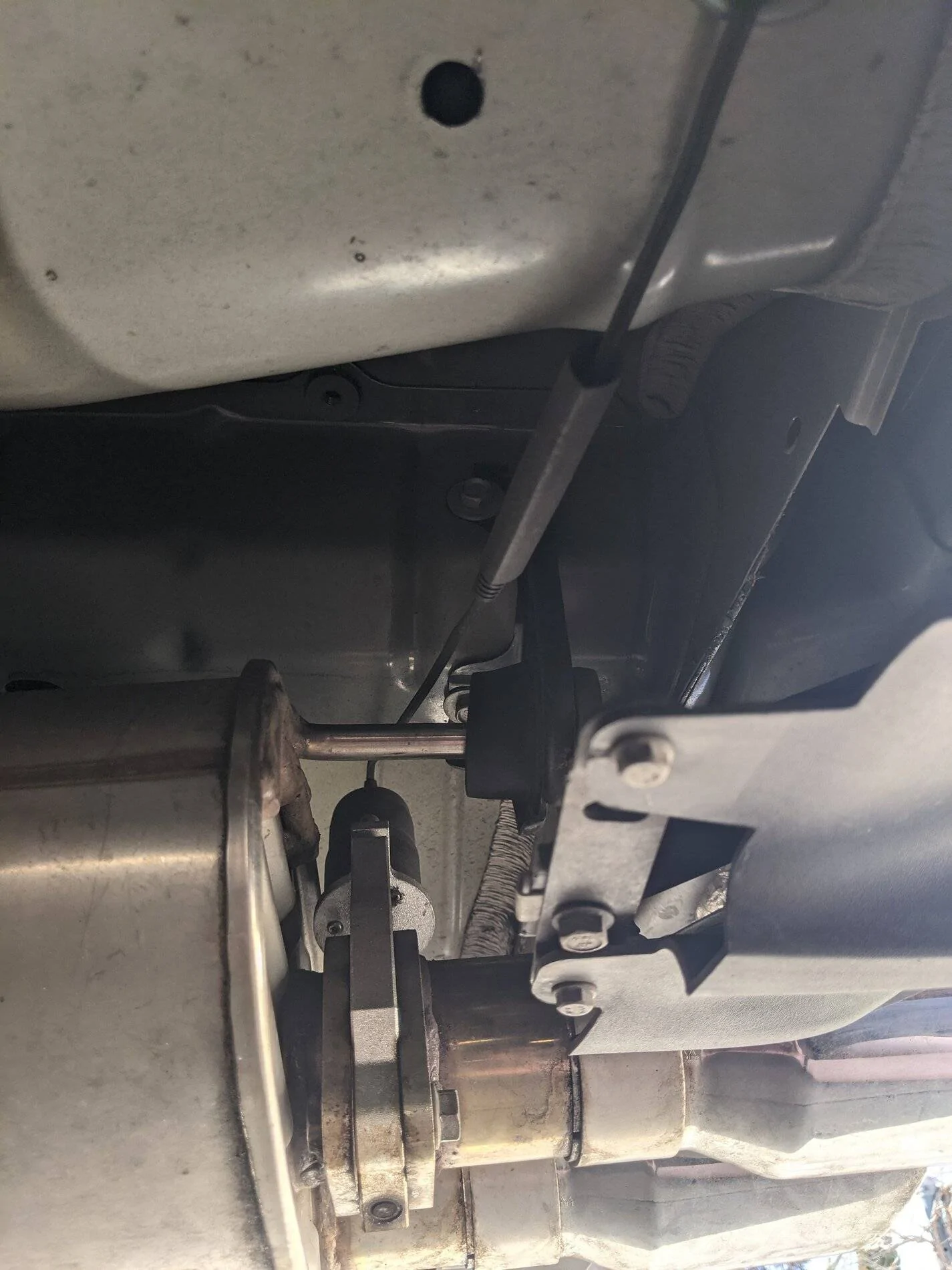

5) I do have active exhaust! Well, kind of but in a good way. There are definitely baffles on both muffles, tracked the wires to the QTP unit in trunk (spare tire well). Baffles are open, which is why the freaking thing is so loud but I haven't found a way to remotely change that up. During transfer of ownership, the remotes either for lost or it's setup to work off of the garage door opener - but I've messed around with that enough to be confident that it just isn't so. Got a call into QTP to try and get more detailed info on their setup and possibly, find out who previous owner was.

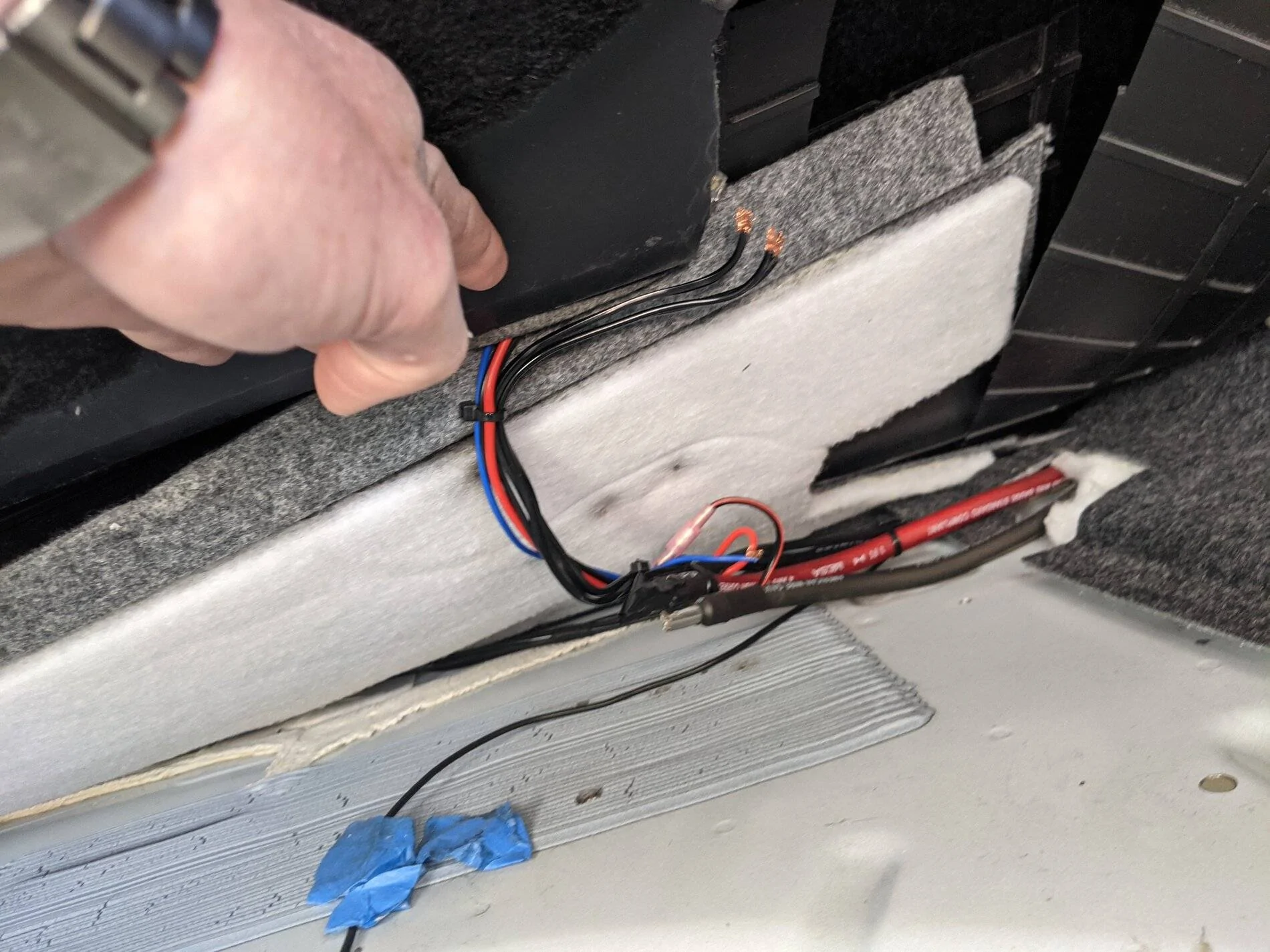

6) The Shaker system is not in stock form (speakers are definitely weak) and found that an amp is missing. There are other important things to get figured out first but it's good to know that the stock system isn't that underwhelming.

@Redfuzzbutt, have you clicked on load tune on the nGauge and then used the arrows to scroll left or right to see if Flex and E85R tunes are stored? If so, you should be able to switch between tunes. Be warned though, The E85R tune should not be used unless you are absolutely certain of the ethanol content in the fuel. Flex tune you could run now with a combination of fuels (91-93 pump gas, pump ethanol, or a mix of the two fuels).
Just curious, does your GT have a BAP too?
Yes sir, oh wise one. My ignorance is quite glaring at this point, haha!
Also, Help me out with quick with the acronym BAP, please.

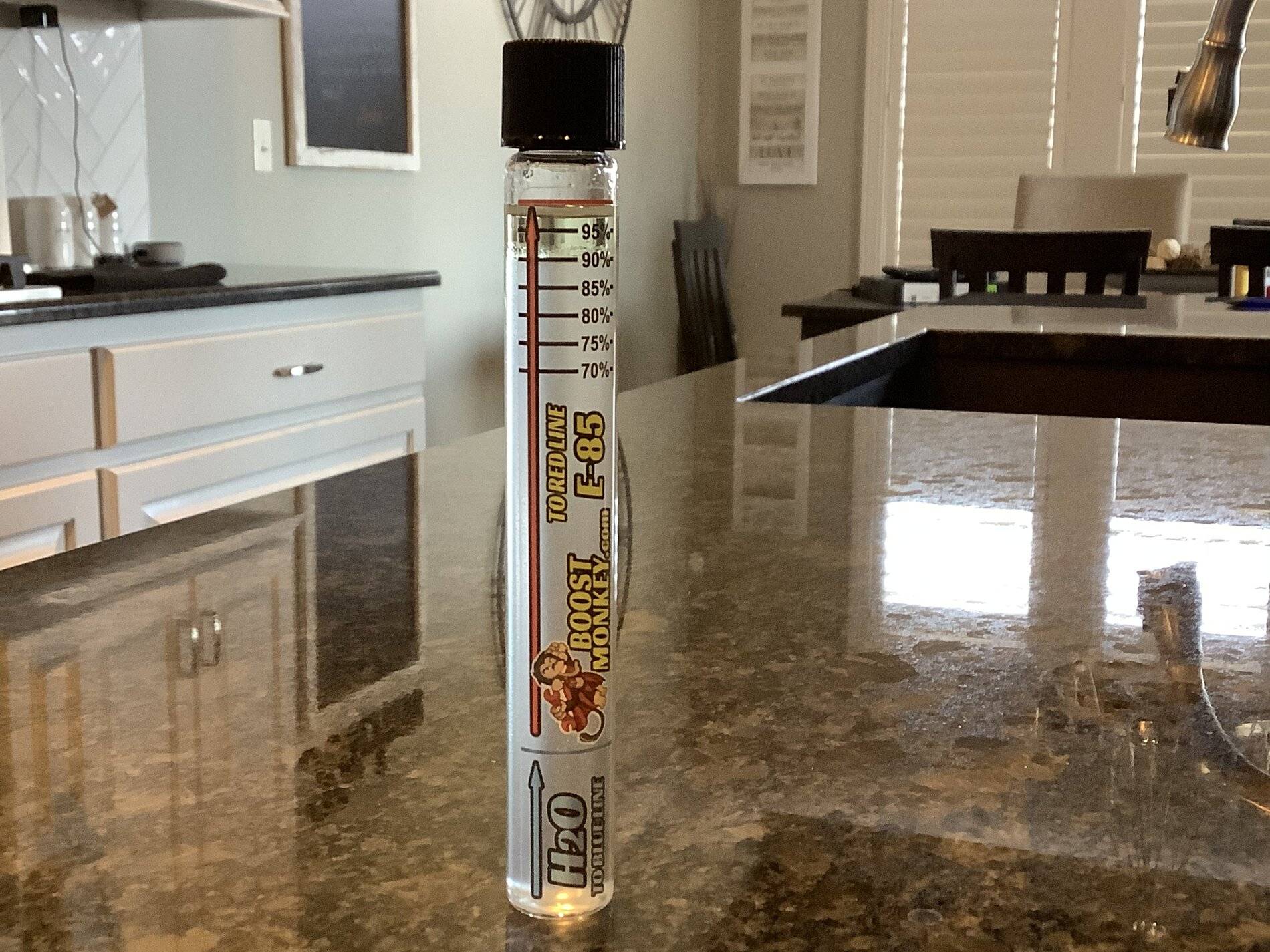

Sounds like you’re going to have to invest in an E85 tester and either test at the pump or buy something like One Ethanol or Ignite Red by the pail. That’s what I did. I keep my test kit with me in the car when I know I will be out long enough to need a fill up. The One Ethanol S that I purchased tested out at 90% ethanol content. Pump ethanol is hit or miss, as regulations say it can vary between 51% - 83% ethanol. I have found that to be very true.

BAP is boost a pump. It increases the voltage to the fuel pump. You most likely don't have one since you wouldn't need it with the sai li fuel system. Also as far as I am aware Lund will not make a flex fuel tune for forced induction cars. You have a 91-93 tune and an 85 tune. I don't know much about Whipple. But I would check and make sure that you are safe to run your current supercharger pulley on 91octane.
Copy that. There are two tunes on the car, one for the E85 and the second for the 91-93.
The pulley size is what came with the kit, hasn't been changed.
The caveat for living in rural AZ is that my options are greatly limited (no E85 available for 100 miles) which means I'll just stick with the regular ol octane.
If the future living situation does change and it's readily more accessible, I'd definitely go the route you suggested and have a tester on hand.
