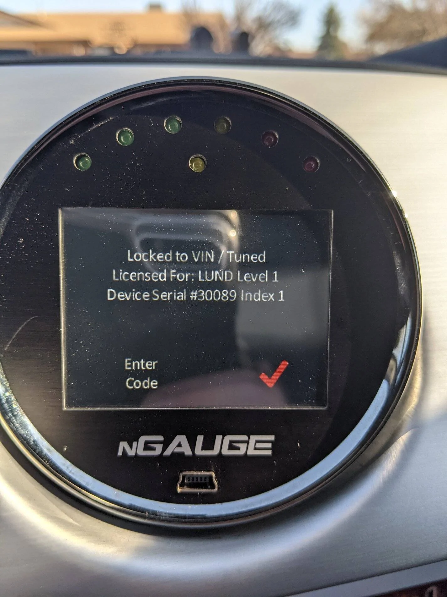

There is a way to tell if you’re running a tune through the nGauge. What does it say from the main menu “tuning” screen? Is there an as card in the slot? You should be able to see all the tunes on it from the tuning screen. If there’s none there, original owner was using it just as a gauge. When you first turn power on, what does the screen say? Lund Racing, Palm Beach Dyno or generic HP Tuners screen? I see boost is there as well so using a boost box omega as well. As far as previous owners, do you not get a used vehicle package in the US? In Ontario anyways, we have to purchase one to sell a car and it lists all previous owners as well as any claims / accidents or anything reported like that. Friend bought a car with 6 previous owners and 20k+ in accident damage and didn’t realize it until after he actually looked at once he was home. Not a mustang but a 2 year old minivan lol.

You can also monitor knock using the Ngauge which would give you an indication of how safe the tune is on the 91 octane.

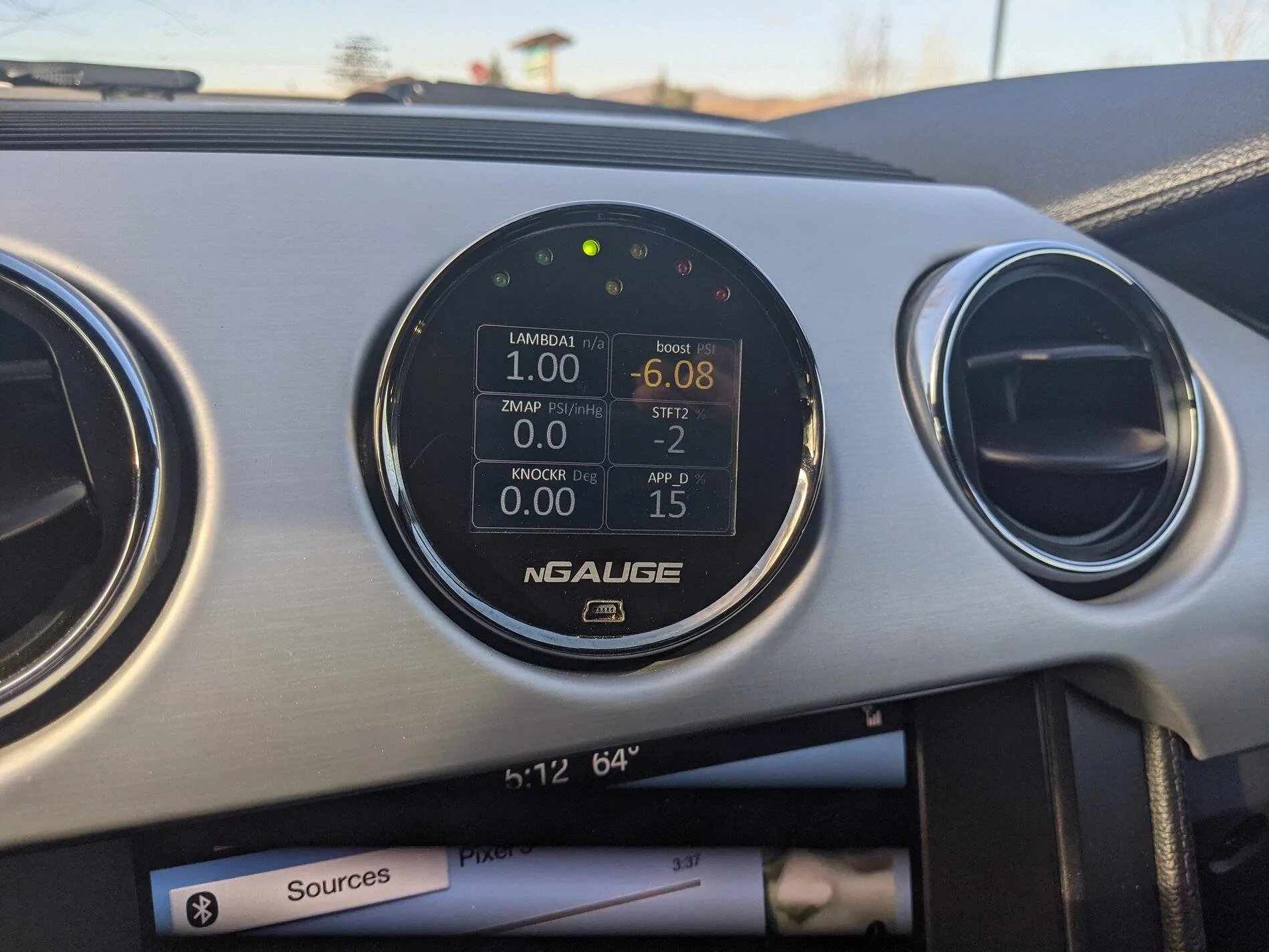

It’s already set up to watch KnockR on the gauge. The PIDs on the gauge that are being monitored are good ones - likely previous owner had a handle on things. I would want to know for sure what tune it’s running though.
What does the flash screen on the gauge say when it powers on?

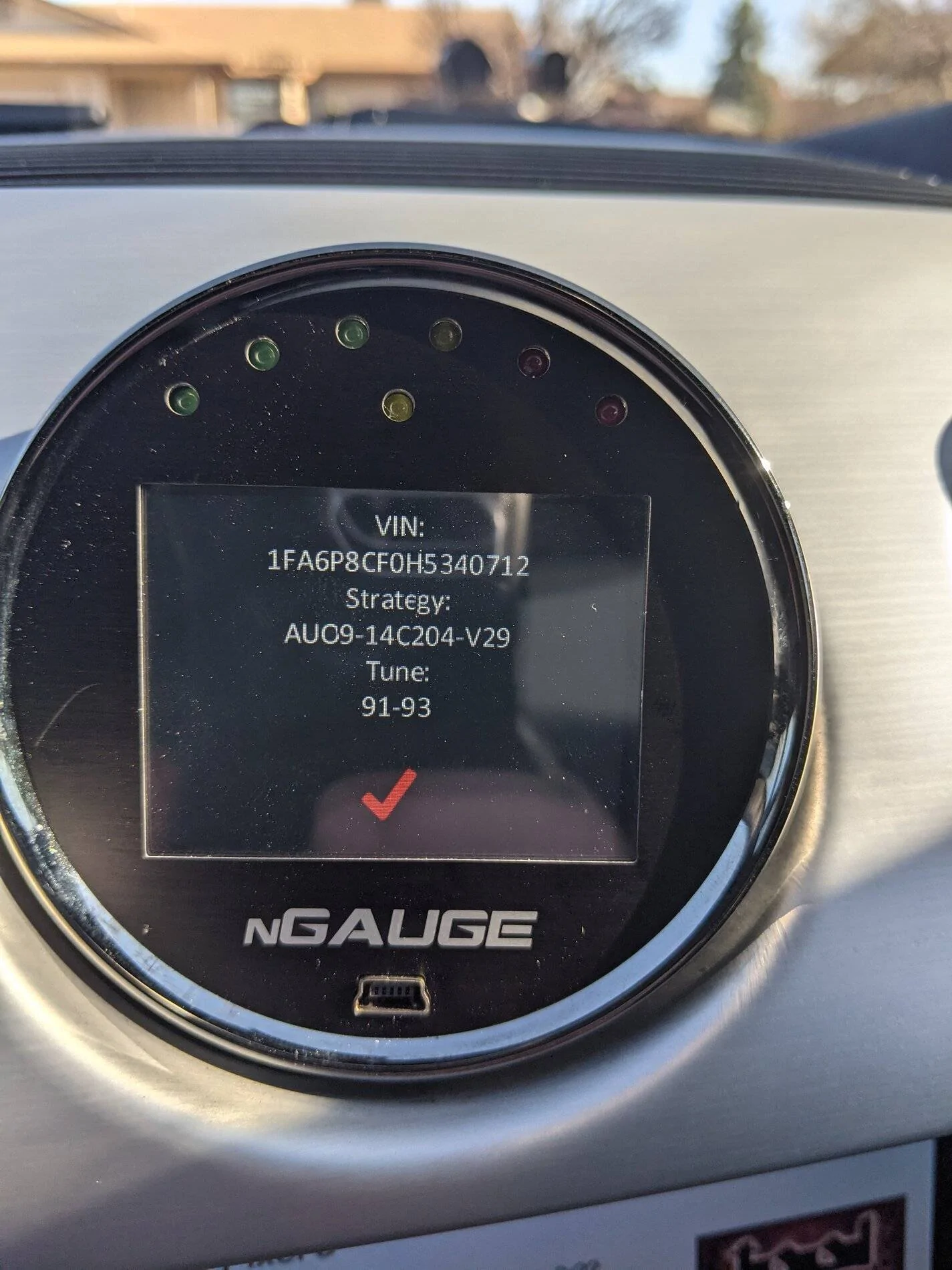

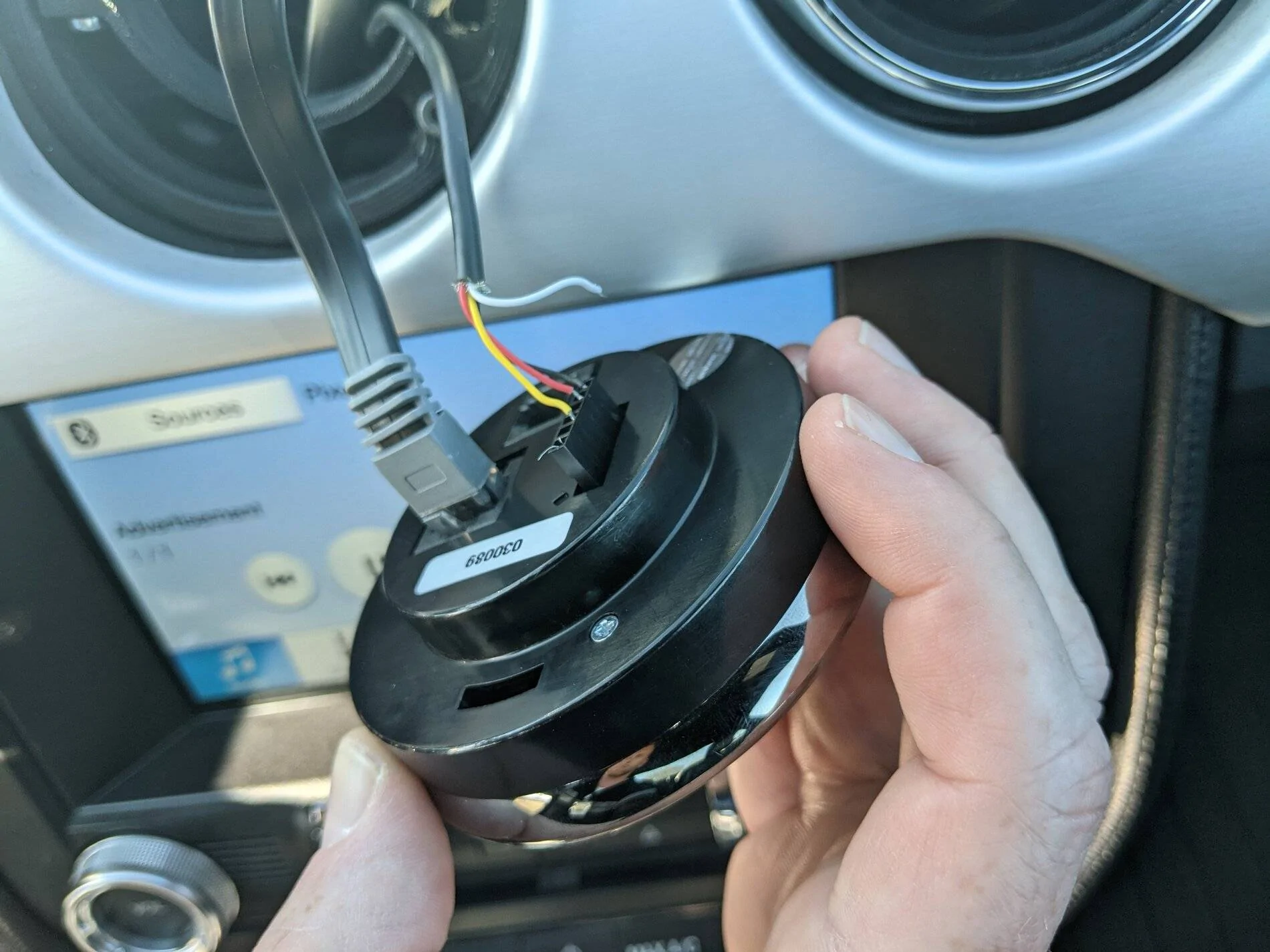

Limited time on response due to obligations. Pulled out gauge after getting off from work, saw a disconnected wire (white) to the back of it. Cursed, placed back in and started car. Nothing. Cursed again, touched screen, nothing, drove home.
Pulled up to last street before house, dang thing is on and working. Just praying it's not a sign of things to come. Was able to snap a few photos, wasn't able to identify what it said when it powers on, it did it ninja mode.

Looks like its tuned by Lund racing. Maybe you can contact them for more information.

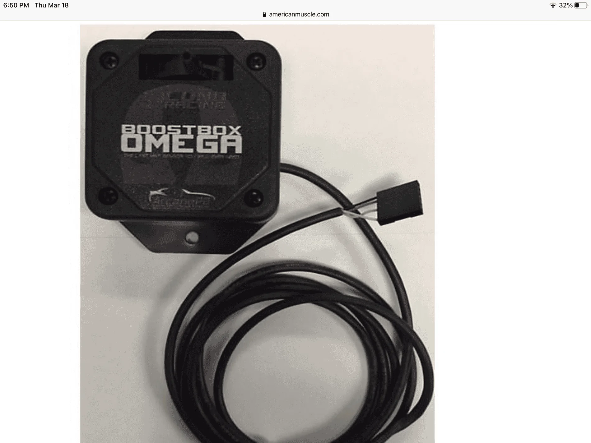

It appears to have a BoostBox on there. The white wire should plug into the empty terminal. That’s an easy fix.

It looks like you’re going to need to strip back some of the insulation on the wire, tin it with solder and then plug it back in to get a good connection.

Good chance it was tuned by whipple and they tune for 91 octane. Best bet is to get compression test just for piece of mind and ensure the motor is healthy. I doubt the car was done half ass since most that do them half ass are short on funds and skimp on the install. The car would have been de-modded if the seller was hiring for money, just my 2 cents.

Tuned by Lund is obvious. Not sure where the shop got that it was tuned by whipple. One look at the nGauge tells you it’s locked to Lund. We’re you able to see if there’s any other tunes on there or just the one. I posted the nGauge manual earlier.
I agree with above though about not half assed. Has the right parts.
I would reach out to Lund though for sure with the device serial number and see if they’re able to trace it back and let you know what’s actually on it tune wise.

If it’s tuned by Lund, you can pay them for a revision service, data log and have them double check and tweak the tune (if needed), in case the previous owner changed some things since the initial tune, like adding a different pulley and didn’t adjust the tune. It’s cheap insurance when you’re likely making over 600 rwhp.

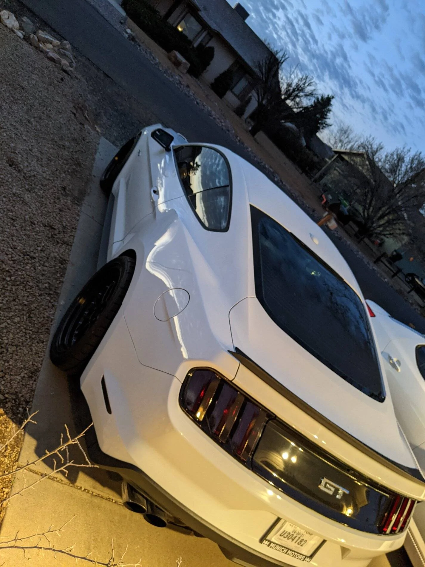

Nice S550 for sure - and what you have there is a good package that someone took the time to piece together well with good parts.
After seeing the pics, I saw the ad for that S550 - you made out well. IIRC, it was advertised as having at least 825hp, and has a Whipple Gen 4 2.9 Stage 2 and oversized heat exchanger + other mods on it.

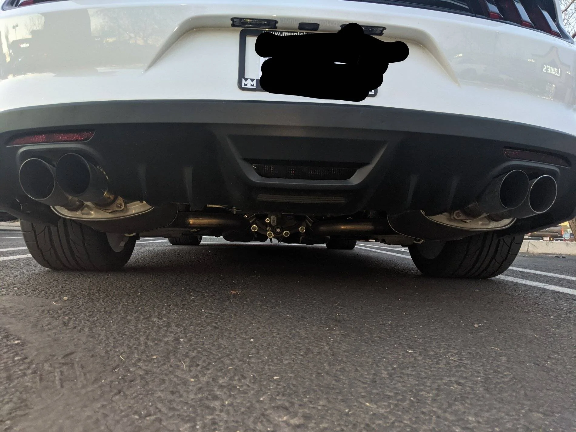

The exhaust - someone definitely did a nice conversion there. The rear bumper cover valence looks to be aftermarket allowing for the quad tips (2015-2017 only had dual exhaust from the factory). Also, looking closer at the rear mufflers, it looks like it might have actuators? I see what appears to be a flange at the face of mufflers where the tips mount. Wondering if someone possibly did a 2018+ active exhaust swap? Hard to say, but just an assumption seeing what appears to flanges. Unless the system is SS Borla or Magnaflow?
The wheels - that’s some $$$ right there - nice set of rims on it.
The car looks to have suspension work done as well, squatted nice and sits nice at the wheel arches.
Great looking S550, good luck with it and be safe - it’s very easy to make the ass end kiss the front end, especially one with power mods.
