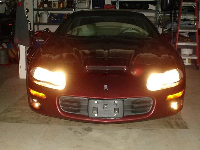

There seems to be a setting in the FORScan program.
On my 2000 Camaro with dual headlights. I have the fogs stay on with the brights and low beams all on at the same time. But that was a rewiring mod.
Same thing on Wife's 2010 Challenger but that was programmable.
