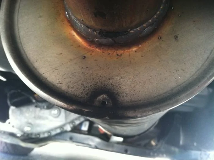

Separately, anyone else notice exhaust water drip out before the tips on the other side of the muffler, right near the rear tires?
Do you have a pic of the location of where this is?
This could be normal, especially on startup when the exhaust pipes and mufflers are still cold - it's condensation inside that seeps out, through flanges and through clamps (it's hard to avoid 100%, most cars have this happen) when the exhaust components have not fully expanded yet with heat.
Importantly, most OEM factory mufflers have weep holes in them, to allow this very moisture to escape, and will appear as harmless water drops on the floor.
Below is an example from an OEM F-150 muffler.
Side note: On newer cars with direct injection, there will also be sooty black residue surrounding the area of the hole, which is also normal.
