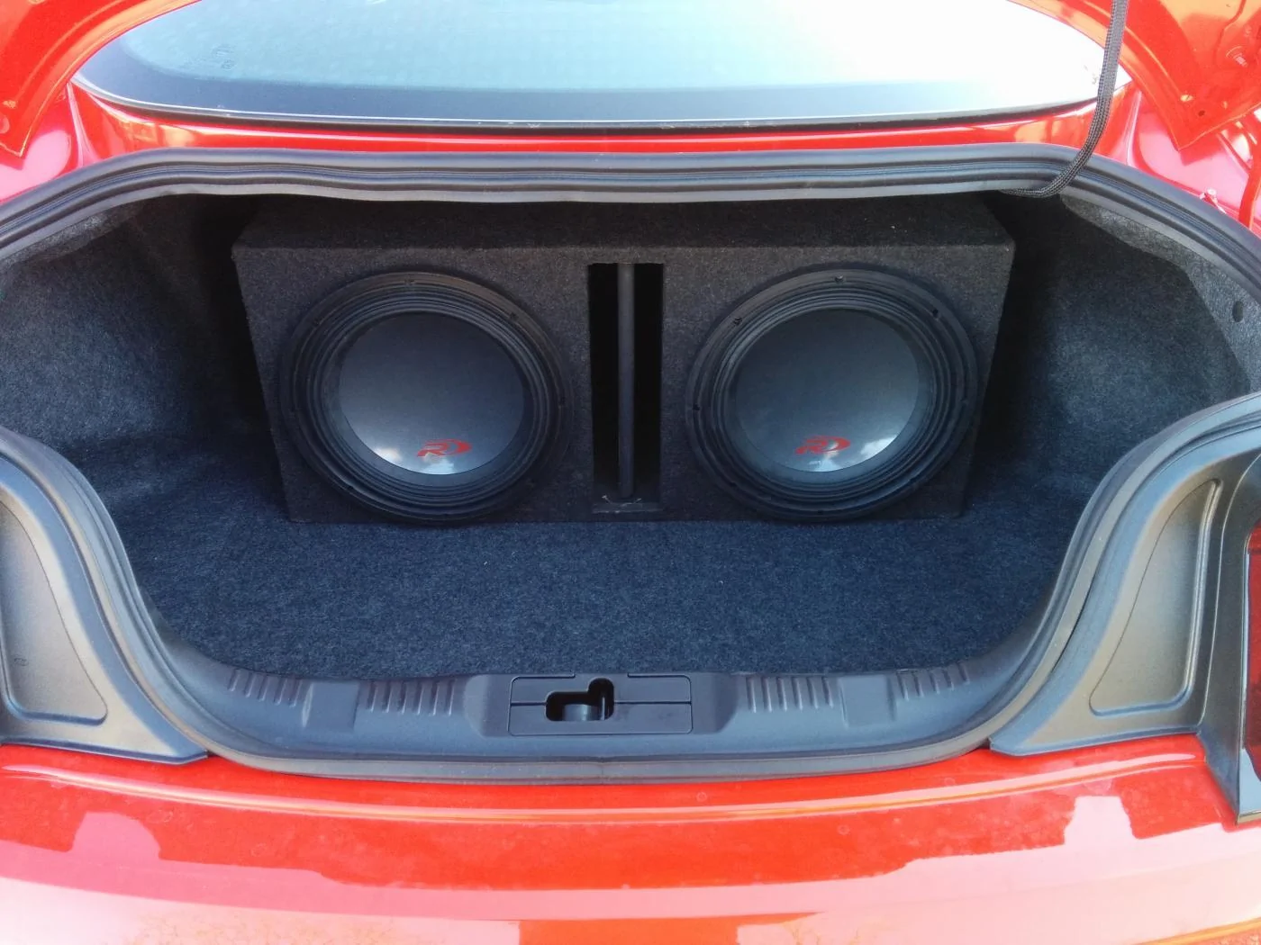

I guess I'll find out when I do the install this weekend. I'll try to get a few pics of the install and note any gotchas I run into. I'm trying to do all of this on the cheap and am waiting until I find good deals on craigslist. At the end of the day, this install will cost me around $225.:thumbsup: Just picked up 2 12" Alpine Type-R's in a ported box this morning. I have a huge Pioneer amp in my Ranger (can't remember the rating) that I plan to move to the Mustang. I'll find something smaller for the Ranger since I'm only pushing a 10" kicker there. Y'all see a Race Red GT bumpin' some Country, that'd be me :D
