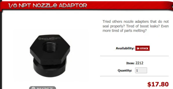

edit. Found this right after posting. The shape of the pc inlet tube is not much a cylinder, more egg shaped in cross section. Wondering how something like this adapter would seal on it and keep the 9psi inside.
http://www.alcohol-injection.com/en/water-injection-parts/271-nozzle-mounting-adapter.html

Using the VMP Harness definitely has it benefits, which I will also be doing. Not a necessity though. The benefit is that you can see the true IATs after the meth is injected. This acts as a failsafe, not only can you look at your IAT while driving and see if the meth is being injected or not, but the tune can be set up to pull timing over a certain temp. Lund usually has timing pull at 140F, with methanol even on hot days you should never really see over 100F or so IATs. This limit in the tune can be lowered so that if the meth fails for any reason timing can be pulled ASAP. Also, if you already are reaching temps around the limit, not moving the IAT sensor from the MAF to post-injection will mean the ECU will still pull timing even though your "real' IATs will be much lower.
Personally I will be mounting my nozzle on the hard pipe before the silicone tube. Personally I feel metal is just a more stable option. The adapter you posted would work fine though I'm sure. If you're going with the Alky Control kit though you don't need anything additional, the stock kit can mount to a silicone tube. I've checked with Julio the owner, here is a picture below that he sent me. He instructed me to use both washers on either side but cut off the rubber from the washer.
