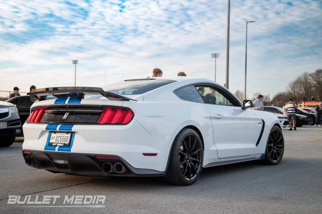

Here is what stock width but 30 profile looks like on OEM wheels….
Seems to fit really well.
I would think R sizes would pretty fat on those wheels But I’d like to see

Aaron, that looks really good, in my opinion. The tire-to-rim fitment looks right, and the tire-to-fender gap looks good with those 30 series aspect ratio tires, apparently thanks to the lowered FP springs you installed previously.
All in all, job well done. Enjoy!
