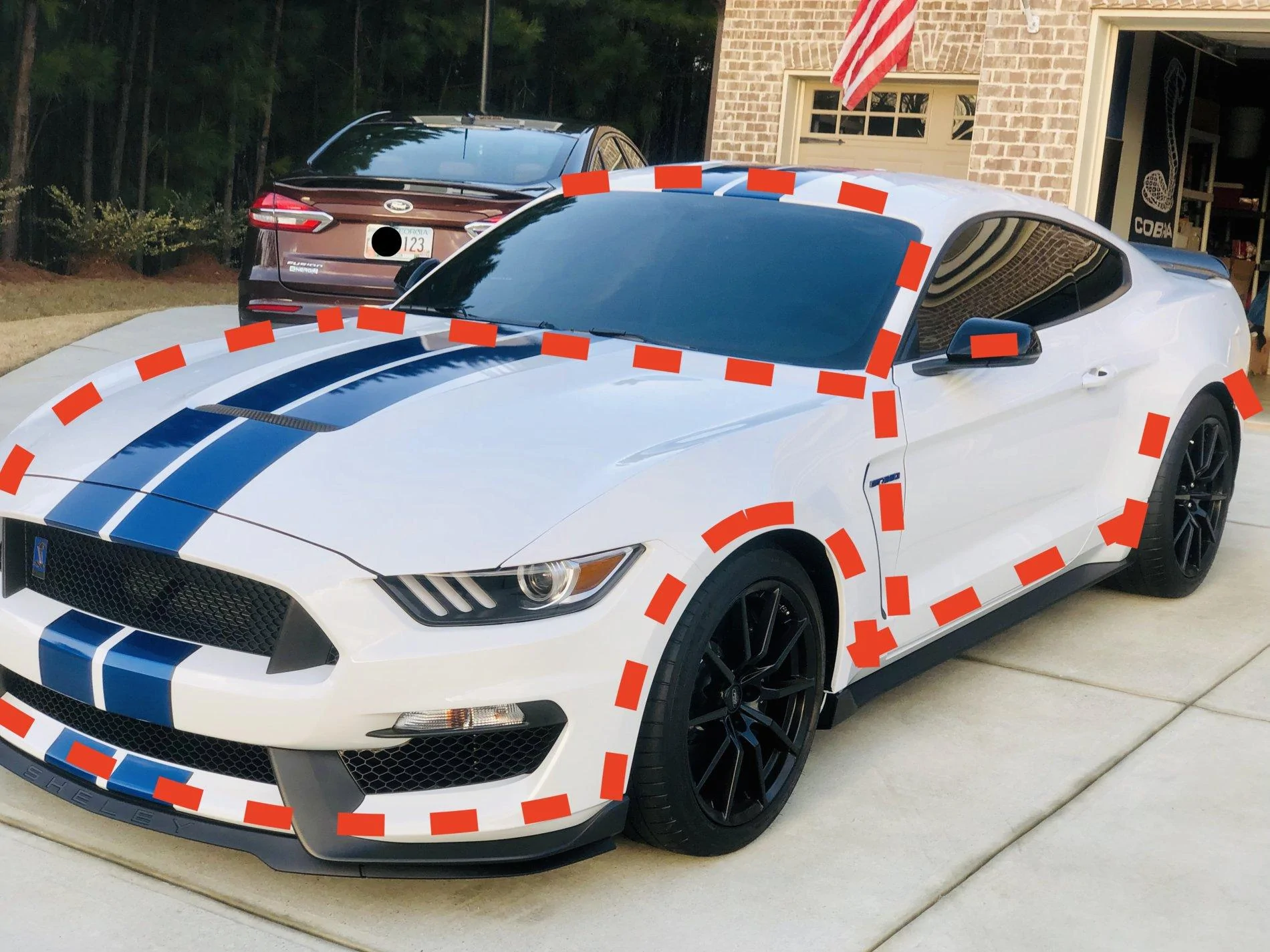

I added film to:
- Entire front of there vehicle (fenders/hood/lights/mirrors
- A pillars, top roof line
- Bottom rockers
- Area in front of rear tire
- Area behind rear tire
I also ceramic coated the entire car over the film and non film areas
Added some art work to demonstrate the filmed areas.. lol

I added film to:
- Bottom rockers
What did you spend to have that done? (I understand there are variables in terms of which film, coats of ceramic, and whether things like wheels and brake calipers are done.). Thanks.

PPF on full hood, bumper, strip across the roof, full front wheel fender, rear of rear wheel fender. That'll run you 2 grand'ish. If that blew your budget... the coating goes over the plastic so it's "continuous" over the transition. I have yet to meet a coating guy who won't insist on covering the whole car.

I added film to:
- Bottom rockers
I had Xpel put on 2 weeks after getting mine same areas except didn't get roof line, a pillars or behind rear tires. Cost $1600 - knock on wood, 10600 miles later paint is almost perfect.
