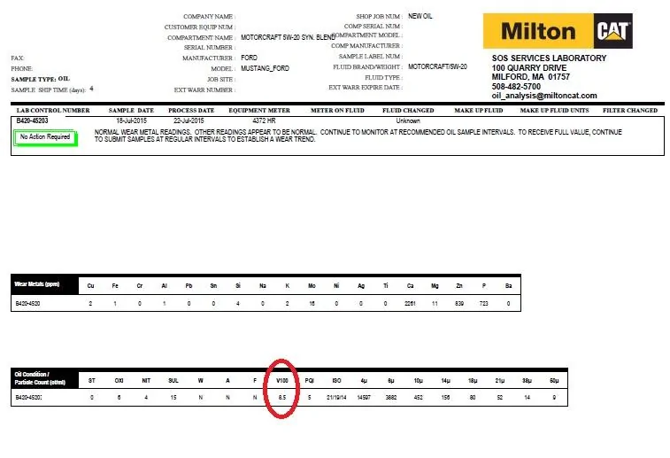

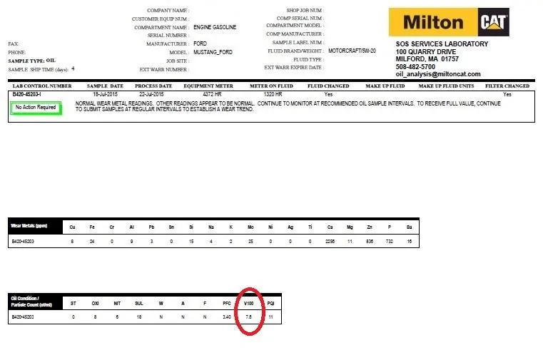

My oil samples have shown minimal breakdown of both the Motorcraft 5W-20 Synthetic Blend and Mobil 1 Extended Performance. I have never seen low oil pressure at idle (indicator of viscosity break down) coming off a hard session in the heat when the oil almost hit the yellow on the guage.

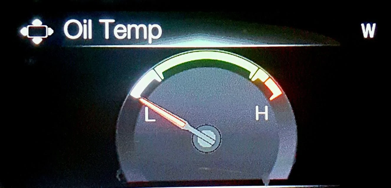

For Reference:
Engine Oil Temperature
The engine oil temperature gauge display ranges as follows:
38-60°C (100-140°F) (low) White
61-137°C (141-279°F) (normal) GREEN
138-146°C (280-295°F) (warm) YELLOW
147-160°C (296-320°F) (hot) RED

I apologize, I was only sharing my experience. I've attached my oil sample results running 5W-20 Motorcraft SynBlend. The M1EP seems to hold viscosity slightly better but it was run at a different track. At this point I feel it irresponsible to recommend any oil much over a 5W-30 assuming warm temps and or allowing the vehicle to come up to temp beforehand. The data does not support a viscosity change. Street cars running a 20 minute session are only going to touch 280F oil temp. under the right circumstances. If temps run higher than that it's a cooling issue, not an oil viscosity issue.
