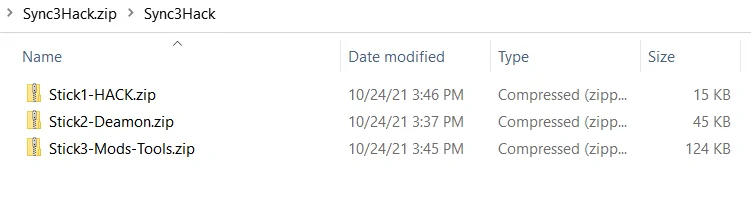

1. A single download with the required files for each USB flash drive can be downloaded here: Sync3 Jailbreak Files
2. Open the ZIP file and open the subfolder "Sync3Hack" until you are here:
3. Double click Stick1-HACK.zip shown above to open the ZIP and you will see the following:
4. Double click Stick1-HACK folder shown above to access the files within. It should looks like this:
5. COPY these files and folders to a blank USB flash drive. When complete, safely eject the flash drive media. Label the USB flash drive "STICK1" with masking tape or some other means.
6. Perform the same steps above for the remaining two USB flash drives. Label each one. The flash drives should show the following if the contents of the ZIP files were successfully copied over:

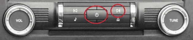

9. Reboot Sync3 by pressing and holding the POWER button and the NEXT TRACK button at the same time until the screen goes black. Wait until Sync has completely re-booted. Takes a few minutes.
10. The most important step and possibly the most frustrating because it may take multiple attempts to get it right. The goal is to re-boot Sync3 after STICK1 is plugged in BUT before the PKG_ERR05 message appears. The number of seconds from Step# 8 will give you an idea how much time you have. Divide that count in half as a good starting point. On my car I found 4 seconds was the magic number. So have your fingers on the re-boot buttons and plug in STICK1. Wait (in my case) 4 seconds before pressing and holding POWER and NEXT TRACK buttons. Do not release the buttons until you see the screen go black and unplug STICK1 from the USB port. If you see the PKG_ERR05 message before the system re-boots, your timing was off. Re-boot Sync3 and try again.

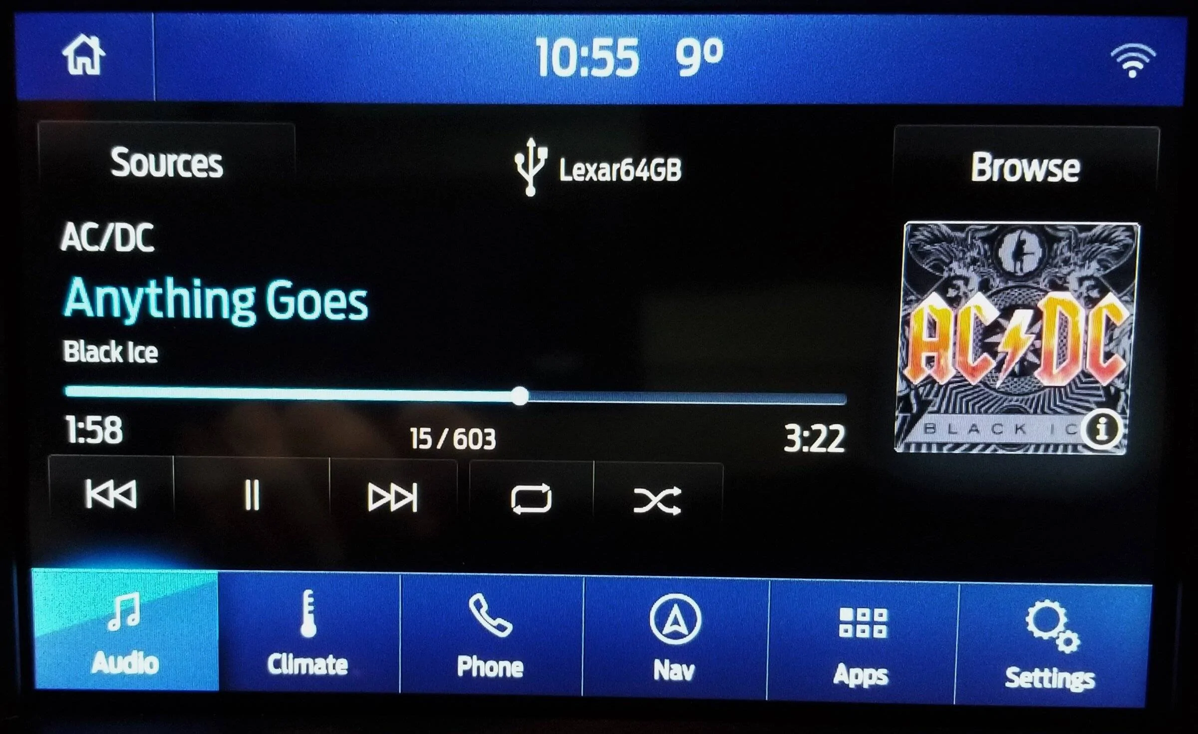

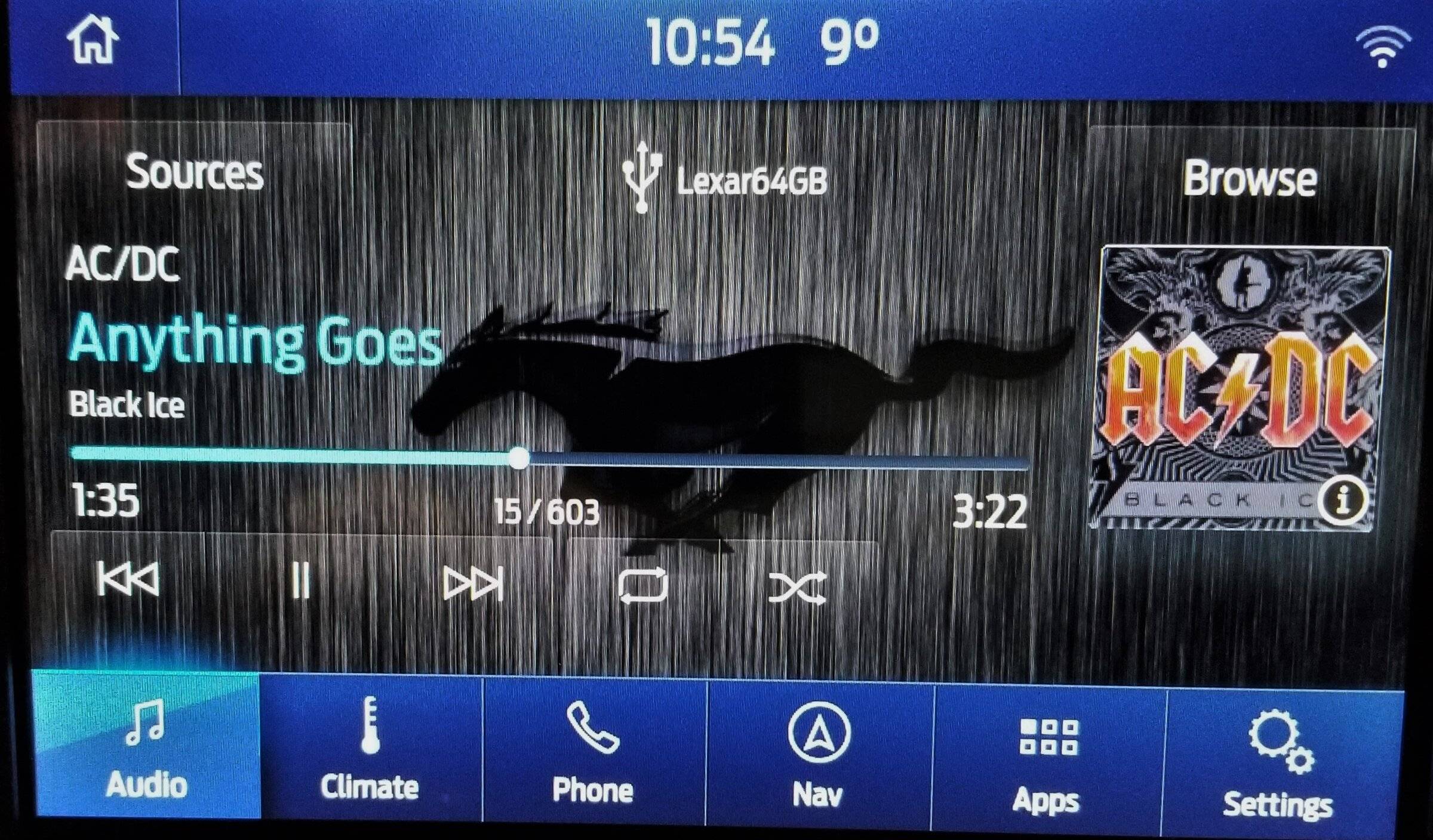

For first time modders, I would suggest starting with the Custom Background Loader mod available from FMods. It simply enables some code that was already present in the Sync3 system that Ford never enabled. It allows you to change your background image to anything you want aside from the 4 boring backgrounds that Ford provides. Background images must be 800 x 480 pixel JPG files. Separate backgrounds for day and night are possible. To use the same background during the day and night, copy the JPG into both DAY and NIGHT folders. Or create identical images with altered contrast and brightness for day and night. Instructions for the background loader mod are in a text file in the ZIP package. I will likely do a more thorough "How-to" for backgrounds in the future. You can also read more in @Gnatsum21's excellent write-up: How to change background in Sync
Some of my backgrounds as examples:
Running dark horse.
Pure black.

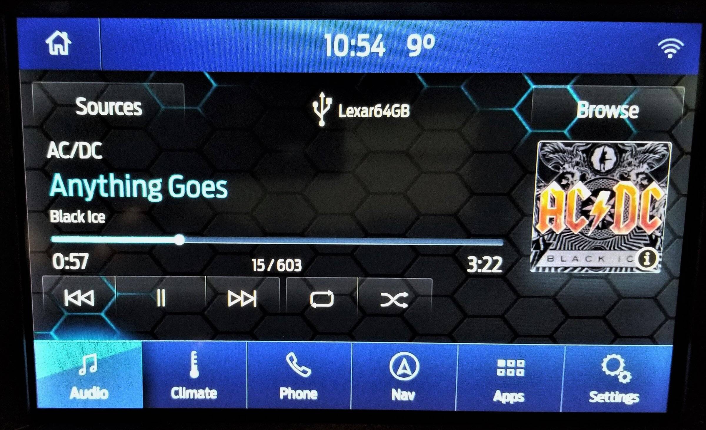

Installed a couple of visual mods last night. Started with "Fancy Rotary" mod first as it is a requirement for some other themes. I chose the "Blue" version to go with Sync's blue color scheme. Very sharp looking improvement to the volume and climate on screen pop-up graphics.
I wanted to show how the animations work in these short videos. Please ignore the poor video quality. My phone sucks.

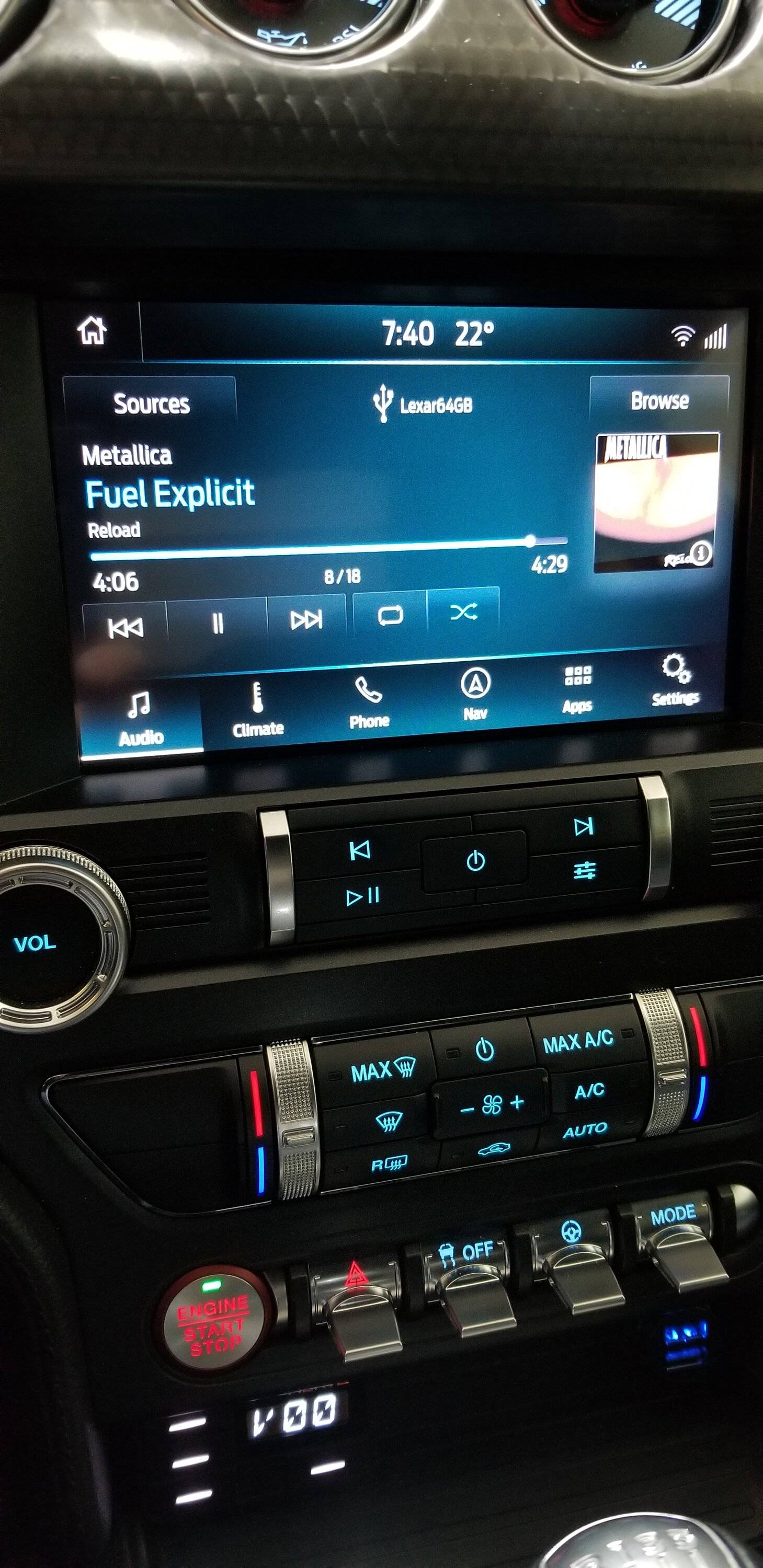

Then I proceeded to install the "Aqua Glow Original" theme. I waffled for a long time on a few different themes. In the end I wanted something to match other aspects of the interior lighting. The color scheme closely matches the ice blue button backlight color. I also use the same color on my gauges so it ties it all in nicely. Much preferred over Sync's deep blue.
Here's a photo with better image quality than the videos:
