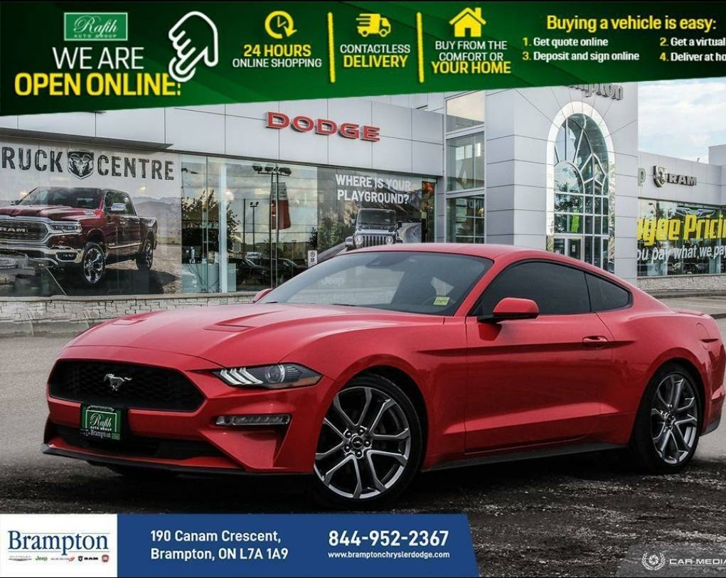

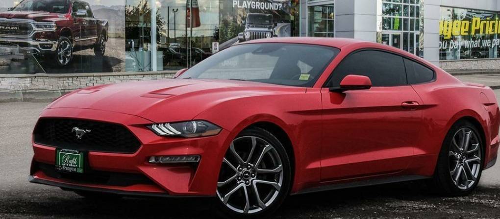

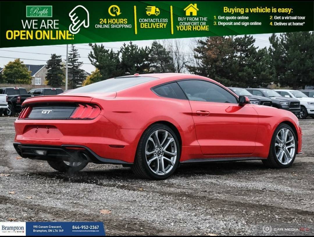

According to your pic, your car has 20'' wheels. Do you plan to put winter tires on that rims or buy whole set of rims & tires for winter? If you plan to buy whole set, I would go 1 size down. It's cheaper and do better at snow.
ps: you mention your car is ecoboost. How comes in second pic it has gt badge in the back :)

Easiest thing to do is use one of the OEM sizes. Since your car is going to have 265/35R20 tires, I would go for 255/40R19 (esier to find tires) or 265/40R19 winters (assume you want separate set of wheels - will be cheaper to get 19" ones) which have roughly same diameter so speedo won't be off to much.
Or you can go down to 18" wheels for even cheaper tires - whole bunch of sizes there, not as low profile though as your OEM ones.
Because the 20 year old kid who owned it before me wanted to "impress" his friends and probably thought it would get him laid
