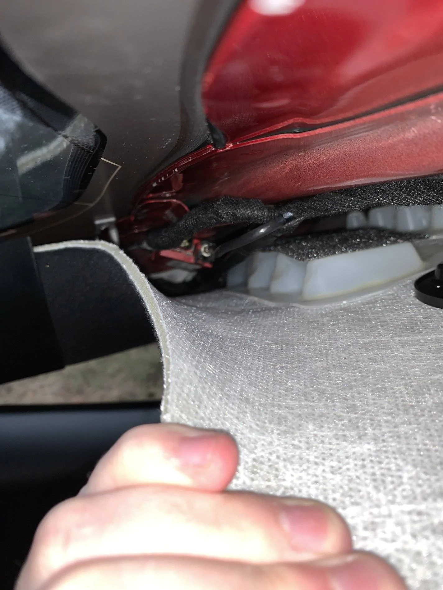

What is the location for the 18-19 Mustangs? I pulled down the headliner but it seems they have relocated the mic for the newer models.
Cobra Jet
Feb 12, 2015
771
17,614
20,076
It’s in the same location on my 2018 EB Prem w/PP... pulled down the HL at the rear and disconnected it just as on the prior 2015-2017’s.
It’s about 1/4 of the way forward from the rear glass and just a little aft of the roof mounted antenna.
