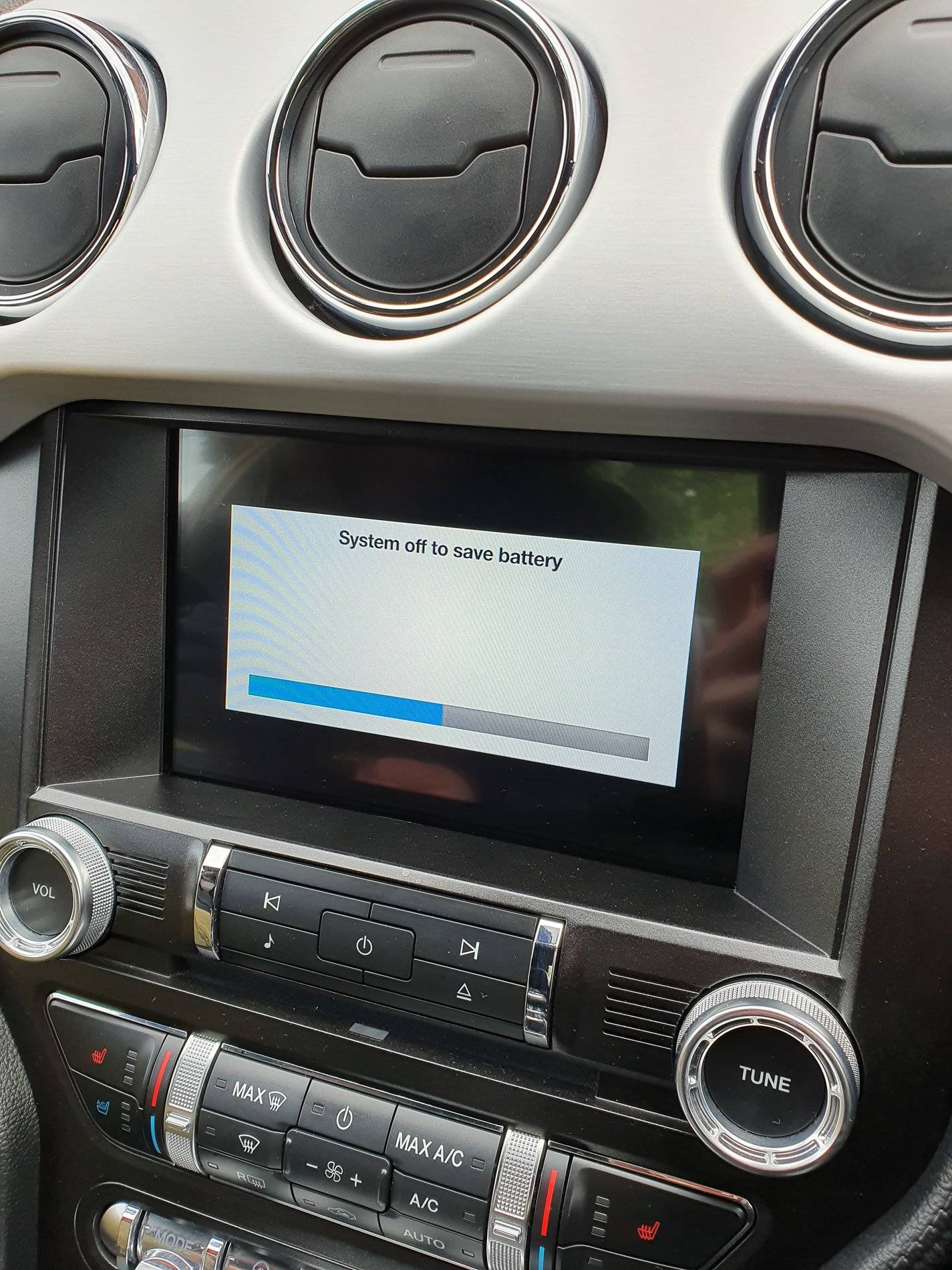

I constantly had to trickle charge my M2 due to error messages, BMW didn’t want to know! Never had it fail to start but when I used the trickle charger the message went away.
I would expect to be able to leave a car for 4 months let alone 4 weeks without battery issues unless the battery is banjaxed.
I’m using my GT about once every 10 days for a 10-12 mile round trip, last time I started it I did receive some sort of battery saving message, so the trickle will be going on. Still started fine though as expected

Also getting this message now when I get into car, have drove it around for a good 40mins or so but its still there, not struggling to start or anything but will stick a battery tester on it today or tomorrow.

Yeah, hooked up a battery tester today and before I started the car it was at 50% and at the rate it was accepting charge it would have took 2 hours to be fully charged. I'll need a new battery soon, not too expensive for these cars by the looks of it. Even if it lasts, I Will definately need one before winter.
