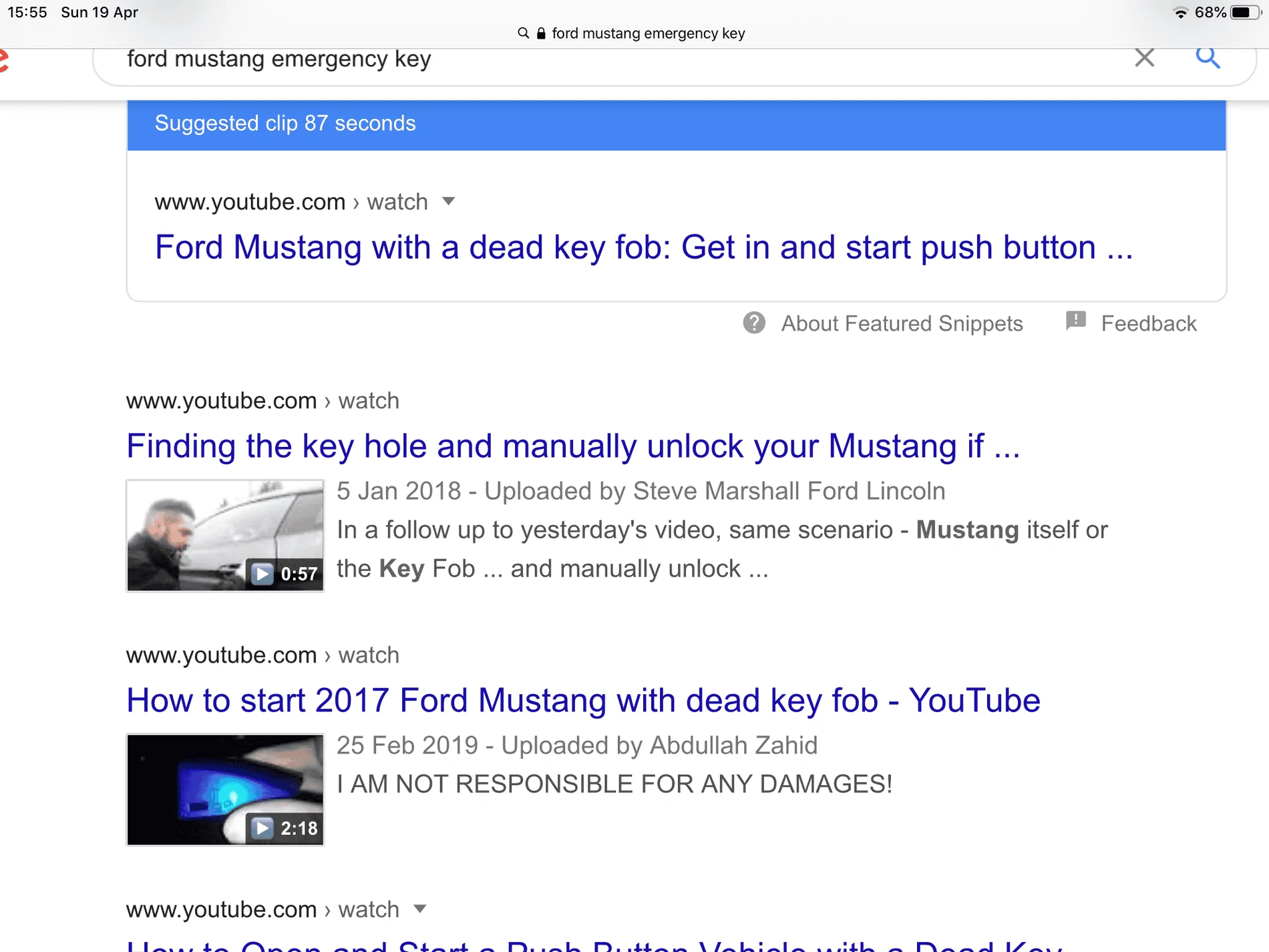

Forgive me but what's the special key to open the door? I cant remember seeing one when I bought mine 12 months a go!
There’s a small blade key inside the remote fob. Prise it open (carefully) and you can use it to open the driver’s door. You will need to remove the key hole cover at the back end of the door handle. It should all be in the handbook.
Hope that helps?
Cheers! Thanks for that, can you tell who doesn't read instruction manuals!
