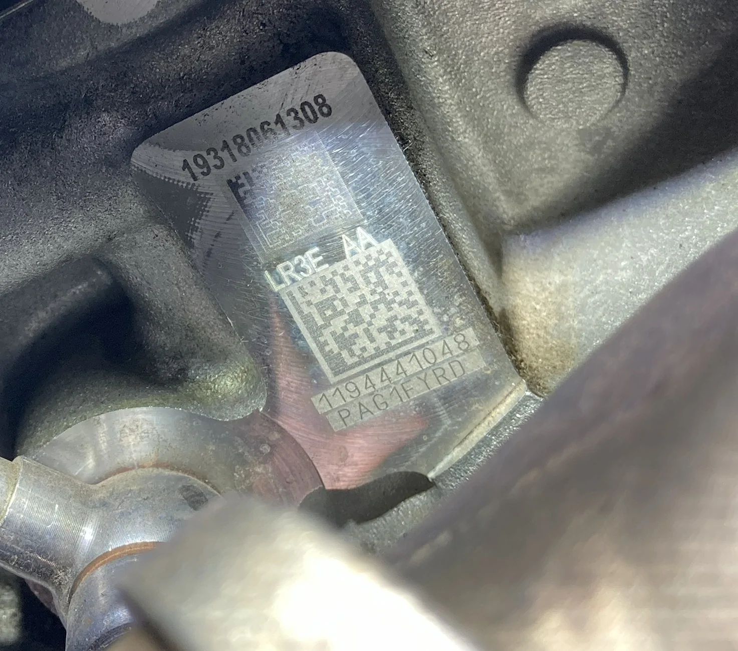

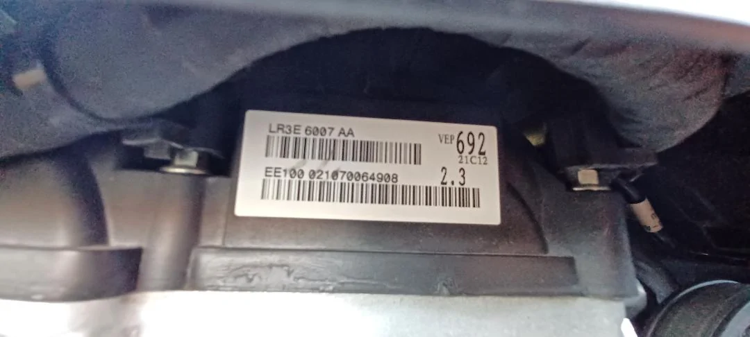

Finally something different I went and checked my engine block casting number:
PAG1FYRD.
Googled it an found:
PAG1FYRD refers to a specific engine block code (OEM: G1FYRD) for a 2018 Ford Focus ST with a 257kW (approx. 350hp) petrol engine. This part is generally found in used auto part markets (e.g., OVOKO, eBay) for the Ford Focus ST model.
So definitely different block from regular ecoboost. Is it the same block as the Focus ST? Numbers match. Same casting. Machining could be different, but I would expect a different laser marking if so. In the future (nort sure when) I will check cylinder head numbers.
